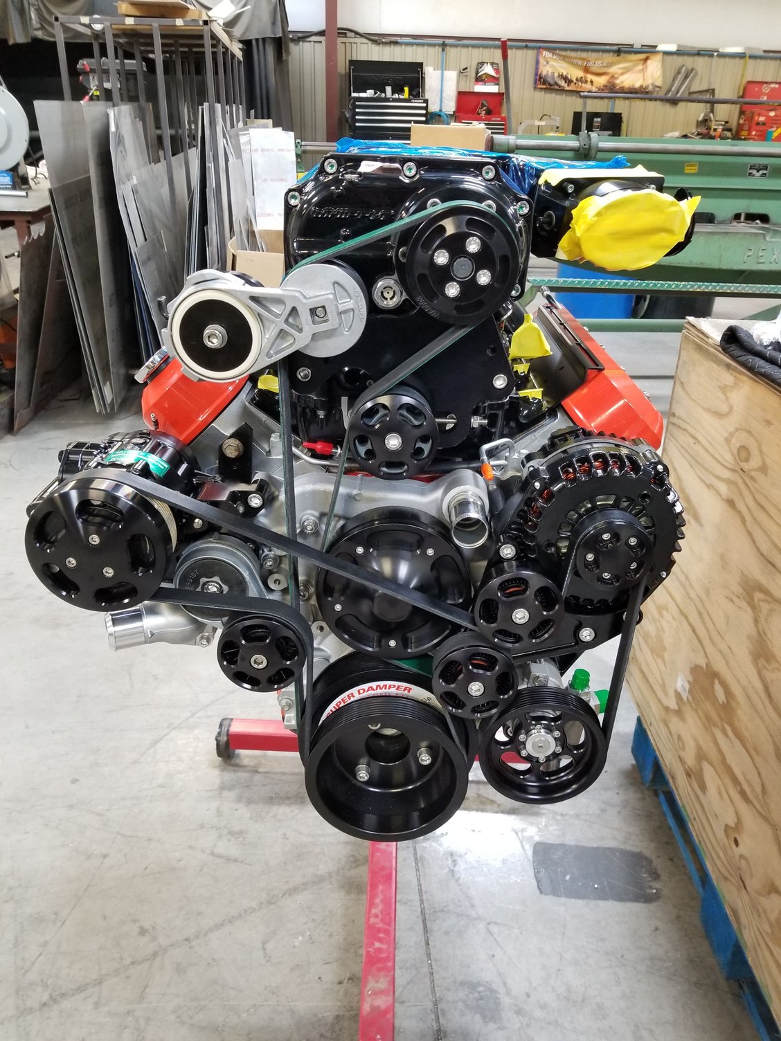

belt drive on

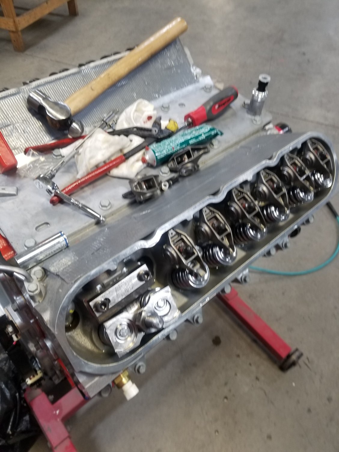

swapped out the "stock" springs /pushrods/camshaft

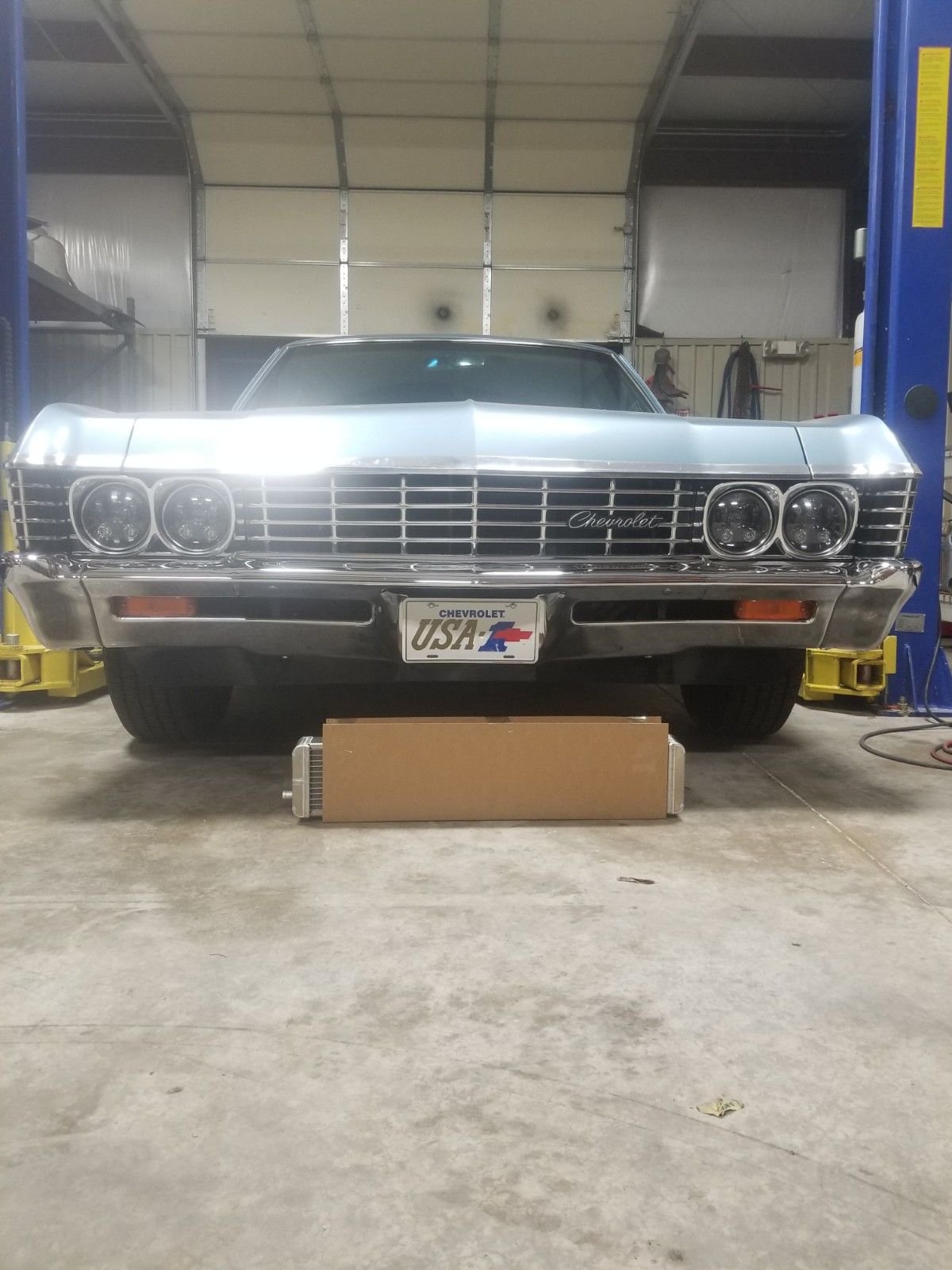

not alot of room behind that bumper contrary to belief... I'm laying the cooler on its edge and fabbing an intake out of glass/carbon in the air dam (I made that too) think of a 35" cutout in my air dam and the duct will be shaped like an "L" with the intercooler at the top of the L... pretty much the only rational option. anyway...going w Holley Hp efi, Deatschwerks 1200cc/min injectors, Canton 2 gal tank made for GT 500 ferds... and same Shelby pump (Ferd part also..so itll all match my Moser 9 in already in there..ferd in front, ferd out back..lol) going Aeromotive Trifekta on the pump...should have most of it Monday. Cam is a BTR stage 3 PDS and got his valvesprings and 7.80 hardened pushrods also... right now I've got that big inch LS3 w vic jr and David Cook carburetor w 4" element..I got it to clear, so with this I'm just going to hafta worry about the blower case touching behind the pulley due to the engine 4 deg tilt aft - that's further forward than the current air cleaner nut so the likelihood of it rubbing is greater. . ...may notch the pan and tig in a nice filler...should ( no..it WILL) be entirely underhood. and the HP objective is 1100 give or take... that's what I know now. Stay tuned boys and girls!.

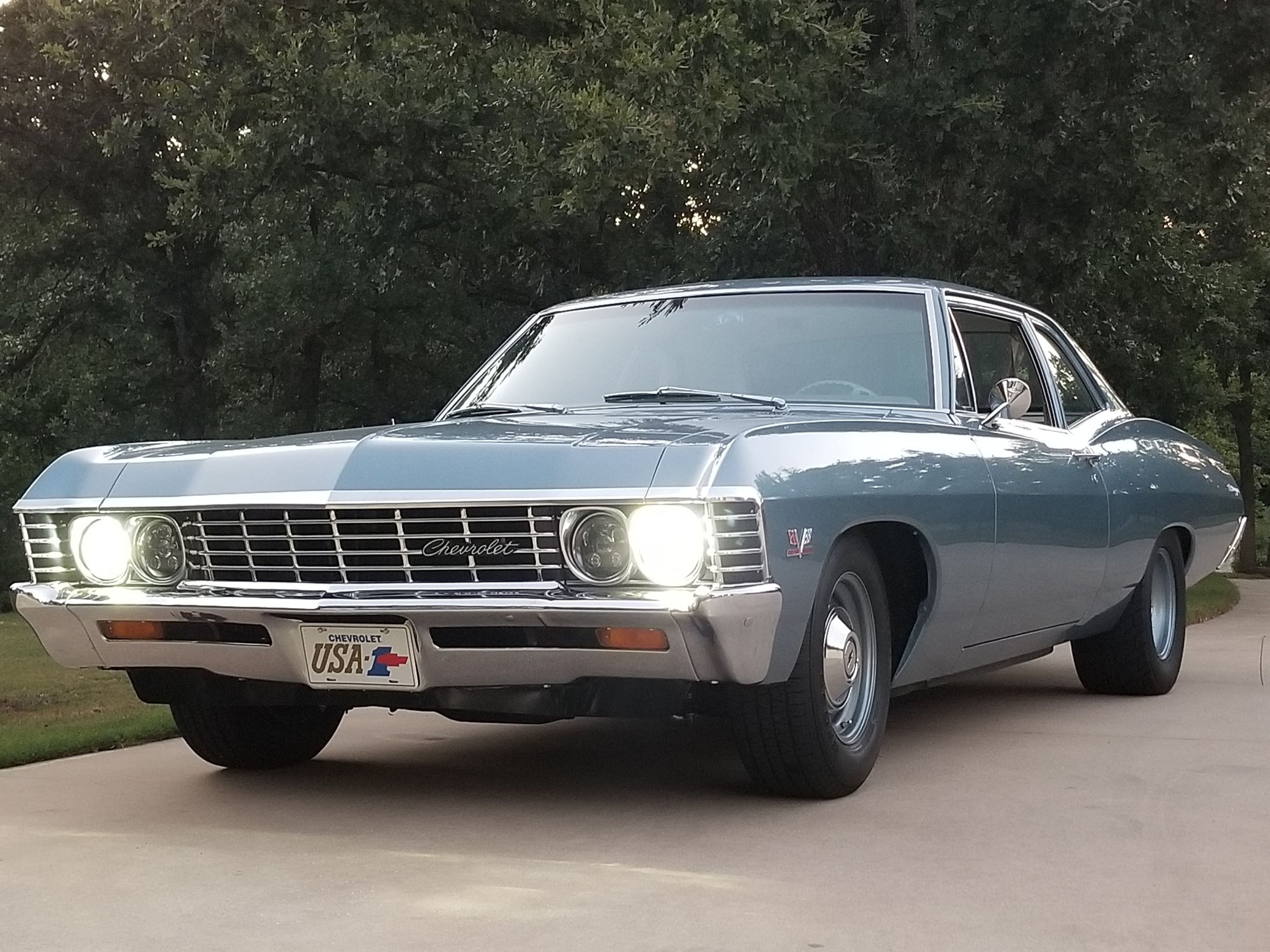

Cool car and cool build. I personally would do a 4L80e because it allows you full programmability when used with a Dominator or Terminator X Max. If budget allows, do the Dominator. Also do DBW!
What headlights are those, please?

the headlights are some aftermarket LED's made for streetbikes - Harleys etc... seems all the 5.75 LED car offerings have halo's... being as I'm not 17 - Halo's don't appeal to me so I got 4 of these - had to massage the radiator support and buckets to make them fit.

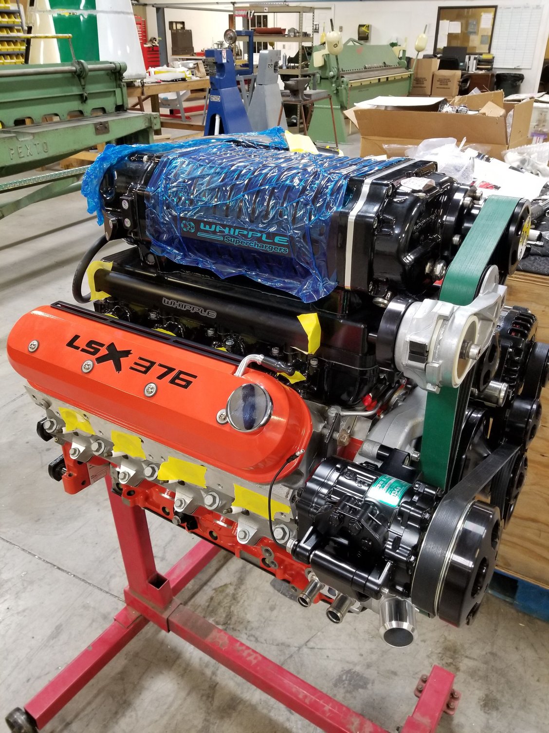

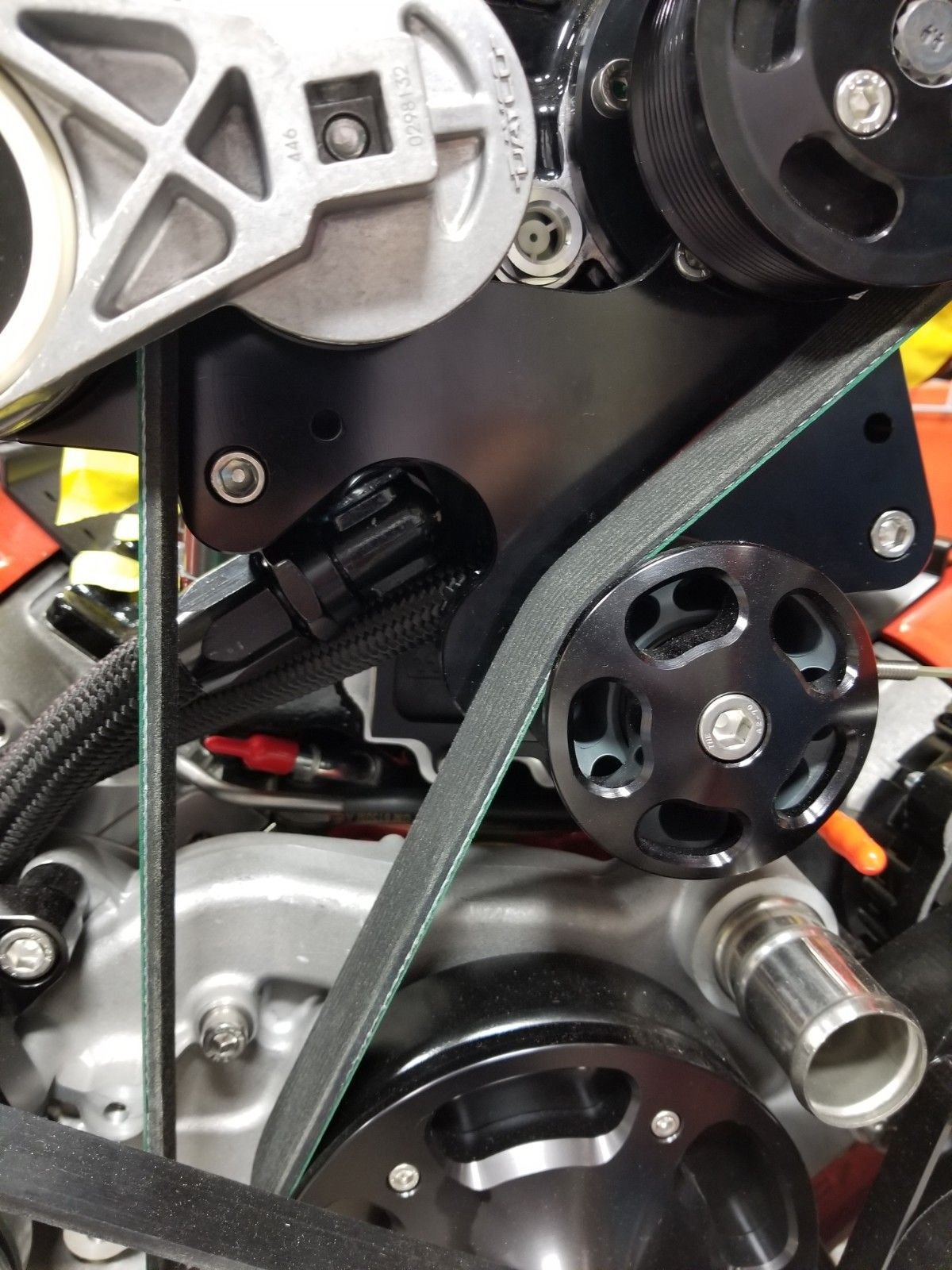

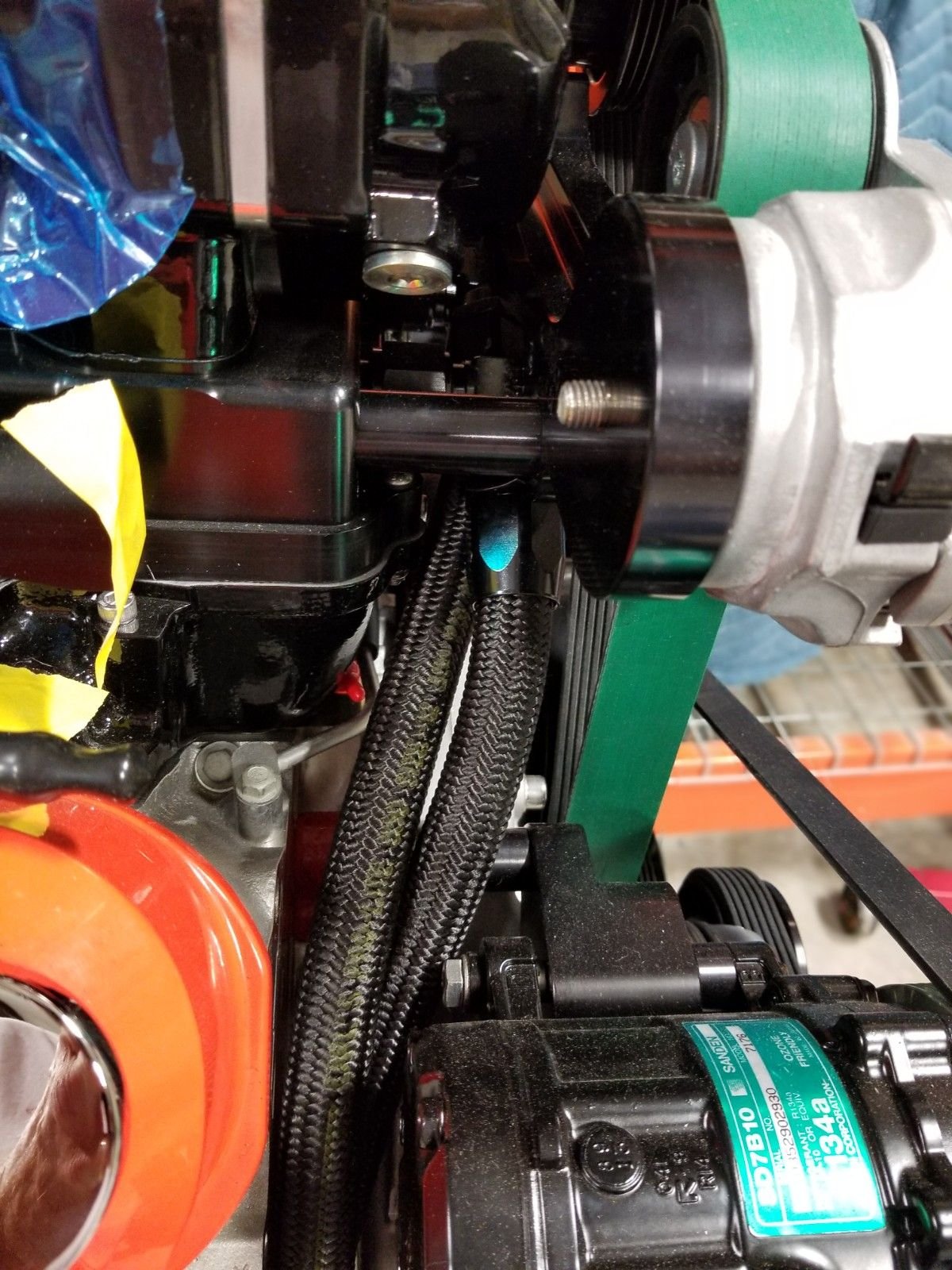

Well - sorted out some minor issues on the serpentine drive - Whipple did a revision to the blower snout bolt ( now surface mount vs flush where the drive shaft bolts to the snout) that changed the pulley mounting - then - when the 275AX case initially was designed, it was with AN10 cooler line fittings - they swapped to AN12 - and Wegner at the same time altered the bracket but wasn't aware of the -12 fittings or the snout bolt changes. I have been talking with Michael @ Whipple and Casey Wegner and working the issues ( thank God we have a milling machine) and got it sorted out - Wegner is remaking some pulleys and maybe the bracket for the idler off my dims and maybe I'll get them soon - come to find out, I was the first build out of the gate after the changes so I guess that makes it R&D! Both companies have been more than outstanding with their help.
Got all my intercooler items ready to go minus the Canton tank ( its drop shipped when done) and I ordered a 67 Impala front bumper from Glasstek so I can do some custom alterations to it and accommodate the big Afco heat exchanger and try really hard to make it look somewhat in keeping with the stocker theme of my car.
pics of the"situations"
