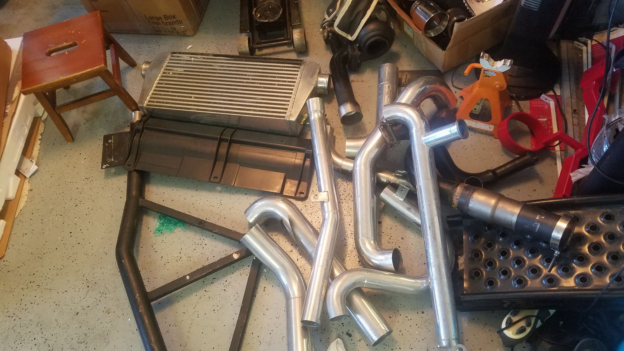

All the pipe lol. Got the intercooler too and LT1 radiator shroud. Looks like judy about everything I need to get started. Just have to cut out my driver side SFC first.
is that your driver seat ? in the top left corner
