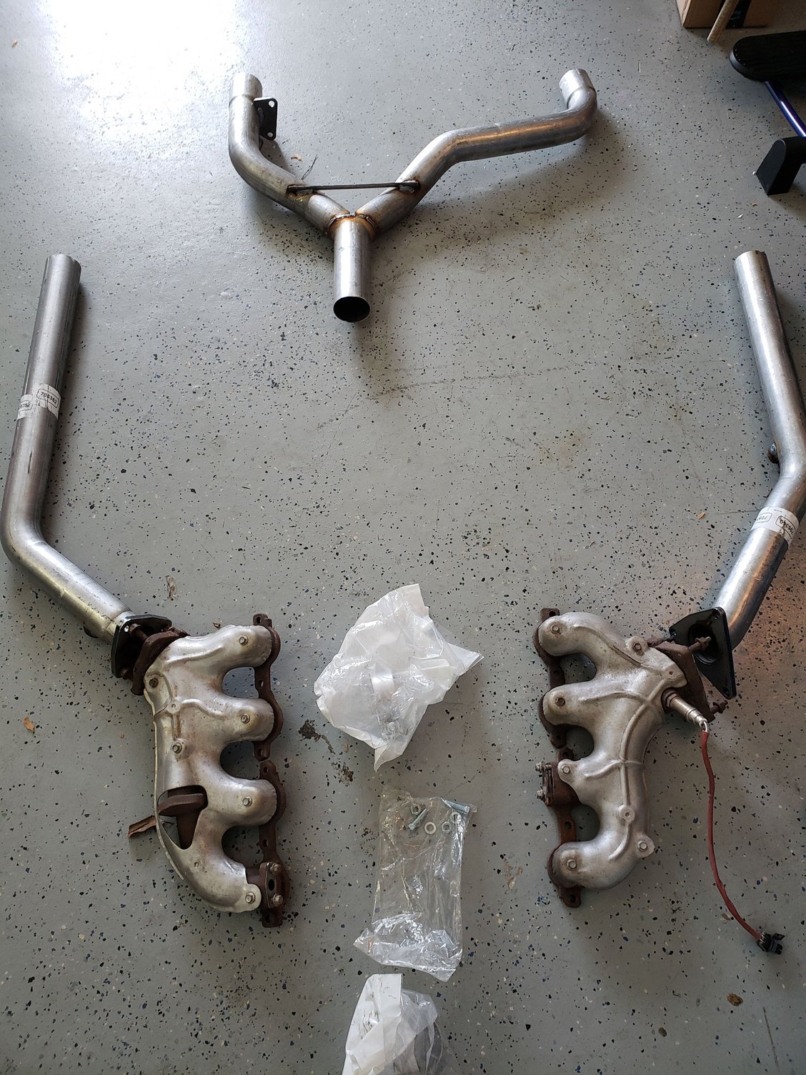

I wouldn't say that lol. Going to swap to stock manifolds and pretty cool cat delete+y pipe kit that I found. Should spool significantly faster and probably make more boost based on guys like Zombies testing. We shall see.

Cat delete is absolutely mandatory for rear mount setups. The tiniest pieces of broken cat will destroy a turbo in no time. I am surprised any of the kits ever lasted long enough for a CARB cert. Also, you are correct in assuming it will make a big difference in spool time. In less promising news, rear mounts are unable to make good spool times with any sound muffling. No matter what you do before or after the turbo, if it decreases annoying drone, it will cause more lag.

The cat delete pipes are already wrapped. Need to wrap the y. This y is also 2.5 vs. the 3 that was on with the longtubes. I expect to see a noticeable difference, but we'll see. I was quickly reminded how heavy stock manifolds are lol.

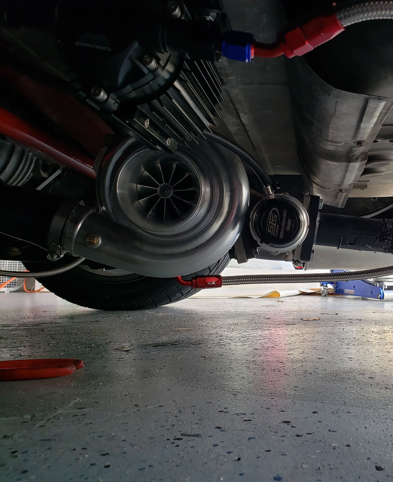

I'm a little perplexed. Got the stock manifolds and cat delete y pipe on. Also got on the 7665. Went and made a pull and no boost. Realized I had the wastegate hooked up wrong, fixed it and still no boost. Checked the wastegate fire ring and it looks ok. Have to be missing something stupid. I pressure tested the cold side prior to putting on the 7665 and fixed a few small leaks, nothing major.
Old Sep 23, 2019 | 05:14 PM
  #254
Game ova's Avatar
Joined: Jul 2015
Posts: 3,012
Likes: 48
Not being sarcastic, but are you sure the throttle body charge pipe is ALL the way on? Had mine come off just enough to keep it from making boost....but still looked like it was on.

Blowoff valve leaking?

When I pressure tested it the TB coupler was leaking so I reclamped it and it stopped....bov seemed ok. I did go through redoing a few couplers to get a better clamp on them....maybe I should pressure test again since I put the 7665 on.
On the bright side I checked the oiling after mounting the new turbo. I can literally shut the car off and let it pump for 10 seconds, go unhook the drain line, and zero oil comes out. Good stuff, and I don't even have a sump.

I couldnt make boost, exhaust came loose before turbo-fixed that and then lost boost
again-pipe came loose at inter cooler. So i had a hot and cold side giving me grief.
I have had pipe pull out of a hose, then go back in, drove me crazy finding that leak.
