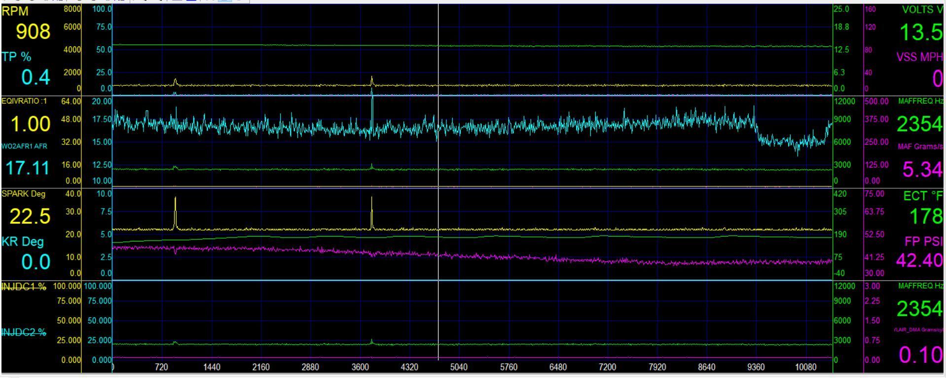

Well....its not the pump, clamps, or feed hose. Swapped all of it and similar behavior. However, I went for a LONG log and noticed something of interest. Whenever the car is stationary and idling, the fuel pressure will slowly drop. But once I get moving again, like hopping on the higher way, the fuel pressure comes back. To me this indicates something is getting warm and affecting fuel pressure. Since its not the pump and the regulator stayed cool to the touch after idling for awhile, there isn't much left except the fuel line itself going to the rails. Either that or the power wire from the alternator to the pump is getting hot and raising the impedance of the wire, but I still see 12.9V+ at the pump itself.

Lol it's all good. WS6store did hook me up on my motor rebuild so I don't mind some critiquing to get a more robust build.
I should just sell my A4 tune for half of what a 4l60e rebuild costs.....what a deal!?!? Here is what I came up with for adding a boost ref external FPR. There is a factory fuel block under the driver side about halfway down the car that goes back to the intank FPR. I removed 2ft of Hardline and replaced it with 6AN to the external FPR and tee'd into a vacuum line. Then removed the stock intank FPR.

If you are running 12ga or better from alternator to the pump you should be reading alternator voltage back there and it should be at least 13.5 but more around 14.xx. Any less points to an issue.
One thing at a time. Figure the voltage issue out first
98 does suck and there will be a better bulkhead option soon for them as well. Its obviously slightly more complicated with the complete different design plus the pigtail sticking off of it.
If the alternator regulator isnt working then it can have issues giving proper field current at idle which causes lower voltage at idle. The field cannot build as fast at a lower rpm to keep it up. Or the battery is having an issue.

If you are running 12ga or better from alternator to the pump you should be reading alt6 voltage back there and it should be at least 13.5 but more around 14.xx. Any less points to an issue.
You read my mind. I was almost wondering if the wire was heating up, increasing resistance and decreasing voltage to the pump. Hop on the highway and there's enough airflow to cool things back down and get more voltage to the pump...

can you plot it against map and injector pw? that logged voltage is at the pump?

It's the freakiest thing. Plotting against map doesn't show anything significant, average varies by ~1-2 psi for that purely idle log. I had turned off the IPW PIDS to pick up some idle ones during that warm start log, but pulling an old cruise log up I plotting IPW vs. FP and it shows a slope as expected, average fuel pressure rises with IPW. That battery voltage is the GM.VOLT PID from the PCM. I've only looked at battery with a DMM so far.

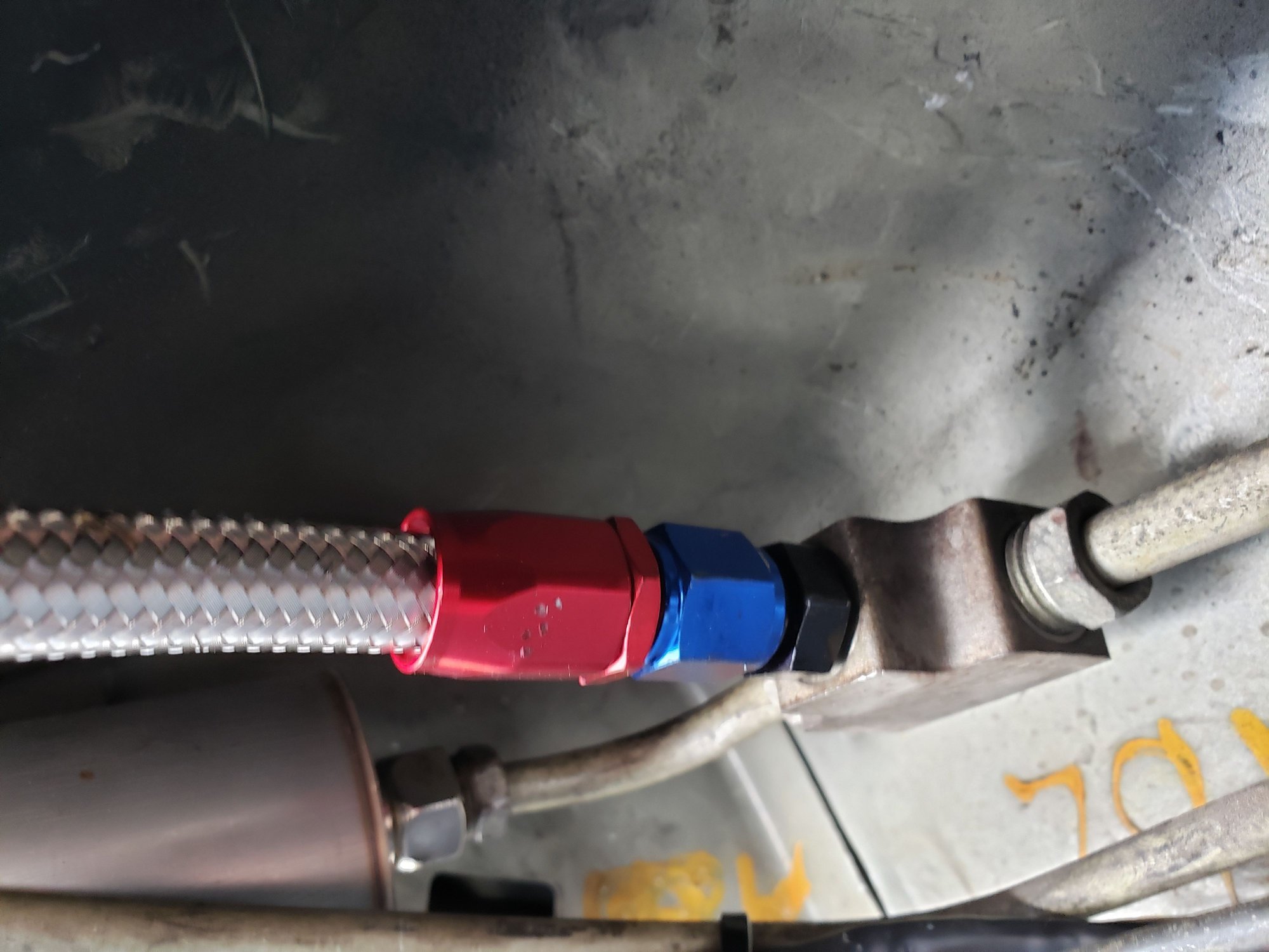

So where is that filter ? What size are those hardlines ? Are you sure that factory tee fitting...is full bore throughout ?
What is the makeup of that return ? Image doesnt show much...but I assume the hardline nylon is in some shape or form the return ? Is it full bore throughout ? With no restrictions ?
The vac signal...from where exactly ? Is it a dedicated line ? Have you tested the FPR with a Mityvac to ensure the top chamber does not leak ? ( Many actually do a little....not an issue with say a 1/4" vac line direct from the intake. But as you're maybe a few feet away a small leak could reduce pressure quite a bit.
A gauge tee'd off directly at the vac/FPR would indicate any issues there too. But a test with a Mityvac is good, and you may need some sealant around the adjuster threads.
( Although a leak there under vac, you'd think FP may rise as opposed to fall )
