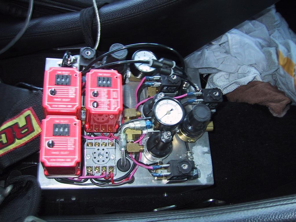

i have a couple of those little regulators laying around if youre really feeling broke. i used that style with great success before i had my ams1000.
hell, before the ams1000 came out, everyone was building crazy 5 stage controllers with nitrous timers and solenoids that basically just routed through a bunch of those same regulators.
Old Feb 11, 2020 | 11:43 AM
  #650
TrendSetter's Avatar
Joined: Dec 2004
Posts: 2,173

here you go, top shelf boost control circa 2005
Holy ****. haha
Good grief were you trying to regulate down to 1 PSI and have multiple stages? I tried one of those regulator boost setups way back, but I ended up just running 25+ with a typical cheap boost controller. The physical controls for boost haven't changed much at all over the years, but the software controlling the solenoids has gotten much better.

Originally Posted by jayyyw
Holy ****. haha
Be a lot easier to use the ecu to do it though lol.
