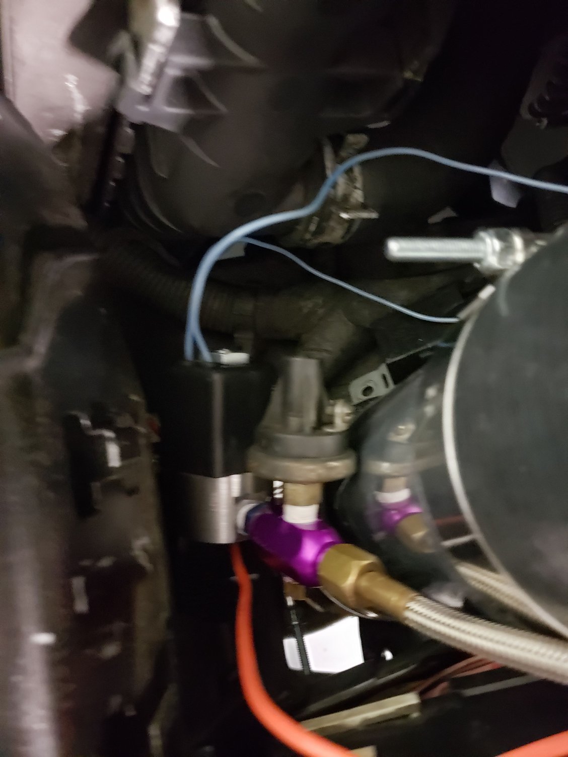

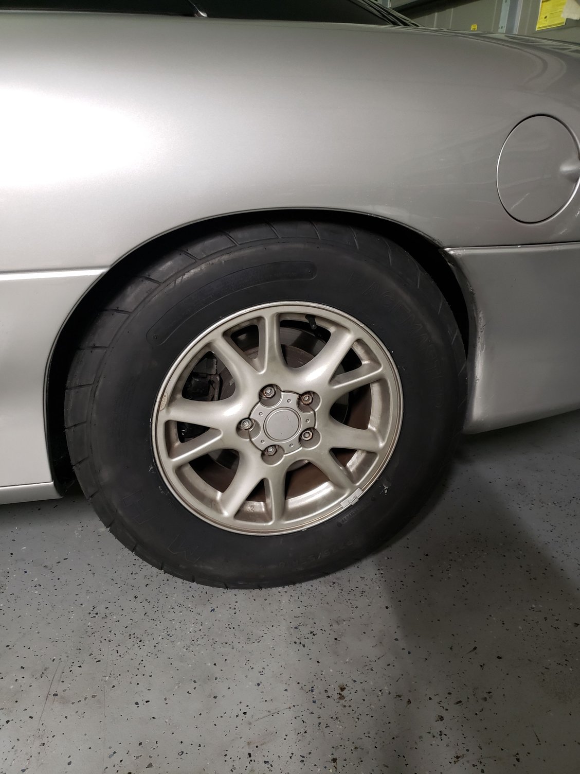

Night and day difference with the car now that it has traction....28 inch tire filling the wheel well. With traction now man it pulls.
Meth kit almost done being install. Adding some features for safety reasons. I had an N2O solenoid laying around so the pump and solenoid must be activated for flow to happen. Also there's a pressure switch on the output of the solenoid that I'll wire to an LED or something so at WOT if that light is on them I know I have flow. Maybe Overkill but I deal with failsafe systems at work and this is the bare minimum. Then I can start turning it up since I had to change the MAF curve now with traction.

Make sure the pressure sensor is set to say 70-80psi for it to be of any real value.

It's a 50 psi sensor. Enough to know the motor is actually pushing fluid instead of just trying to measure current flow of the pump which doesn't guarantee anything.
