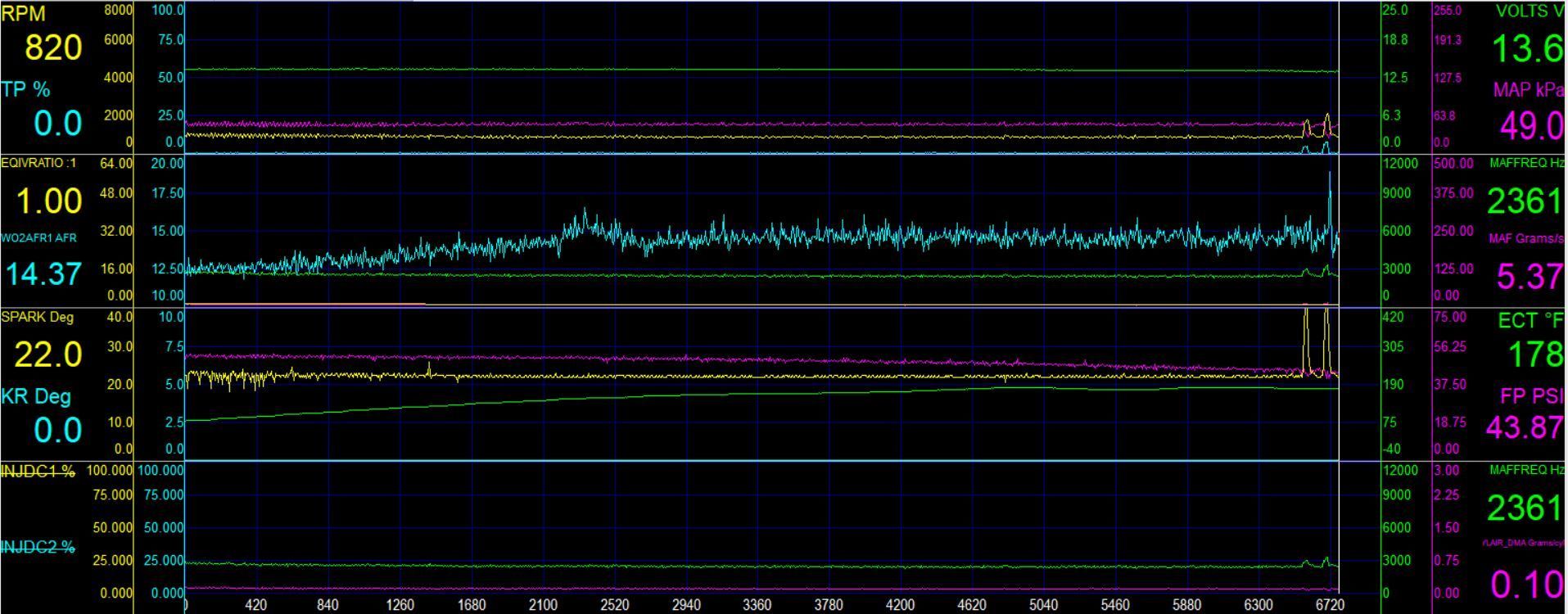

Well grounding better may have helped SOME but not much. See log pic over ~12 min cold start idle. FP started out at ~51. Battery voltage started at 13.5VDC AT THE PUMP. It slowly dropped to 13.1VDC over the time. Something interesting is that rev'ing the motor didn't change the battery voltage at the pump which seems suspect. Tempted to wire a charger straight to the pump directly outside the car and see if it holds pressure steady. Otherwise, think I'm ready to yank the pump.

Most battery charges would barely offer 1 or 2A. Maybe not much point doing that.
When you revved it, did battery voltage change ?
I guess at this stage, despite it being a hassle it's worth trying another pump
Old Dec 28, 2019 | 10:14 AM

Voltage at the pump didn't change and based on the log it doesn't look like the battery PID showed w change either. Ive got a charger with a 2/12/75A setting. Could run the 12A setting but not the 75 since it's just for cranking.
