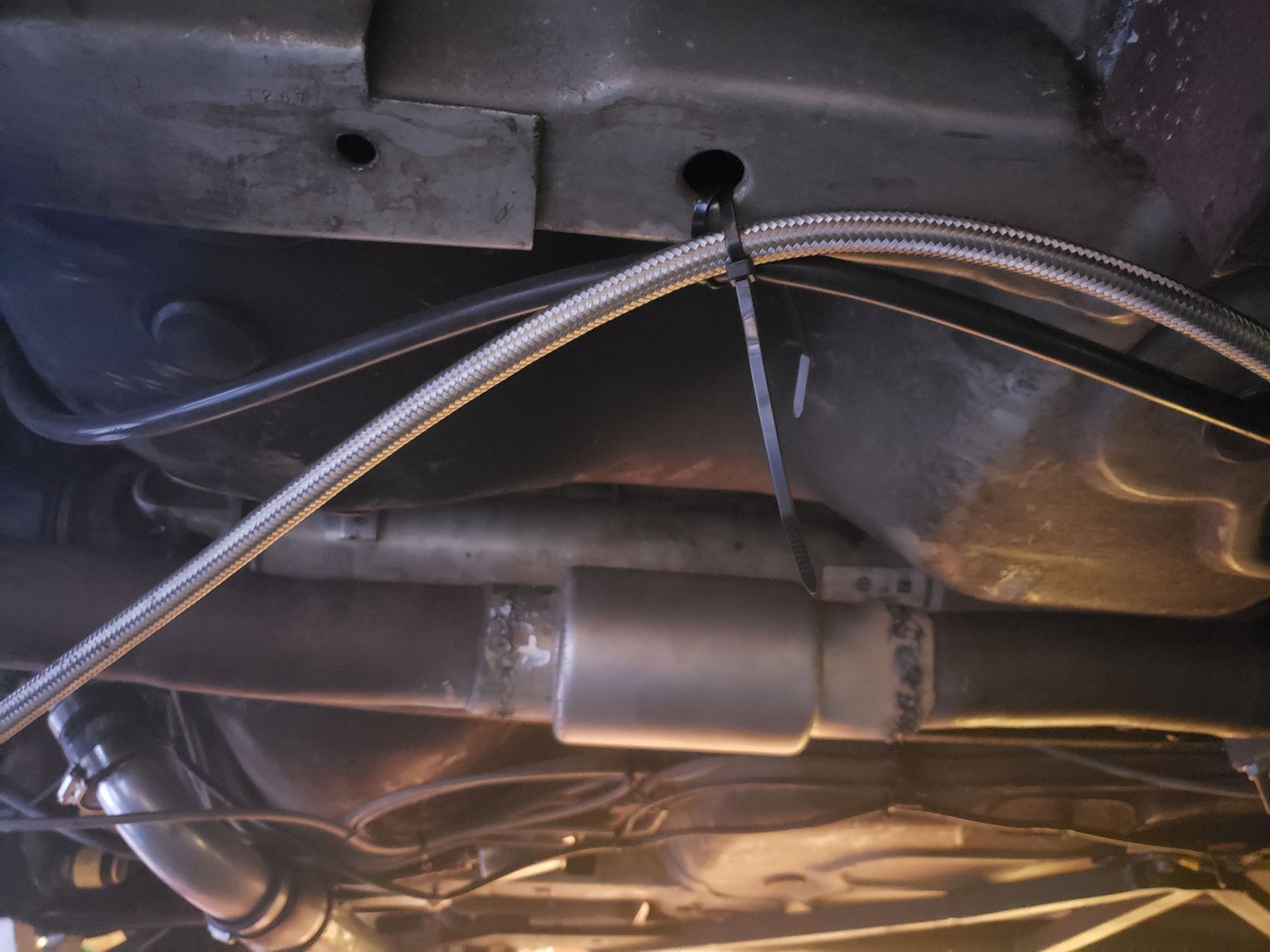

Getting close to having some form of exhaust lol.
Cutout replaced with a small dynomax bullet that is straight through.
After a bunch of measuring and searching online I found this resonator made by Vibrant. Never heard of them but Amazon had a TON of positive reviews and some before and after sound clips. Even though it's straight through the noise different in the clips was significant so giving it a shot. Plus it tucks up in a tight area.
You tryna give me a stroke?? Cut the excess off of that zip tie!! Oh, and post up some sound clips
I am learning more and more in my "old age" that function over form matters more and more lmao. I need 1 fitting to finish up the fuel rail pressure sensor and can start logging again and try to get a clip of it running.
Yummm flux core welds... lol
ive had good luck with 3” mini mufflers that I get off eBay from performance curve. Jones makes some good cheap stainless smal case mufflers too as I picked one up when I thought about putting a 2” muffler on my WG since it’s open dumped but never decided to follow through. You would be surprised how much sound a small little case muffler like that really does.
hahah, yeah....I'm still a welding newb so its not pretty by any means. I'm anxious to start it and see what it sounds like.
