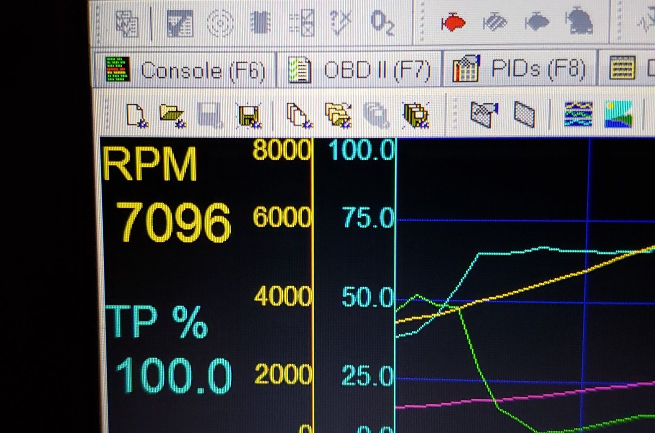

Welp...officially out of maf and probably pump. Ordered a transducer to log pressure. Up to ~8 psi. Really need to get the cutout out of the I pipe and get a muffler on this thing Apparently it still revs though...

Isn't 7k a wonderful sound? Was it dancing across lanes?
It was hooking, like I said hard to believe. 7k turbo no muffler is pretty nasty sounding. It was my fault though I was paying too much attention to how much boost it was making. Up to 8 psi now. Need to get the rest of the exhaust wrapped and that cutout gone and see what happens. I should just get the walbro 450 in and the ls7 maf on and keep turning it up.
