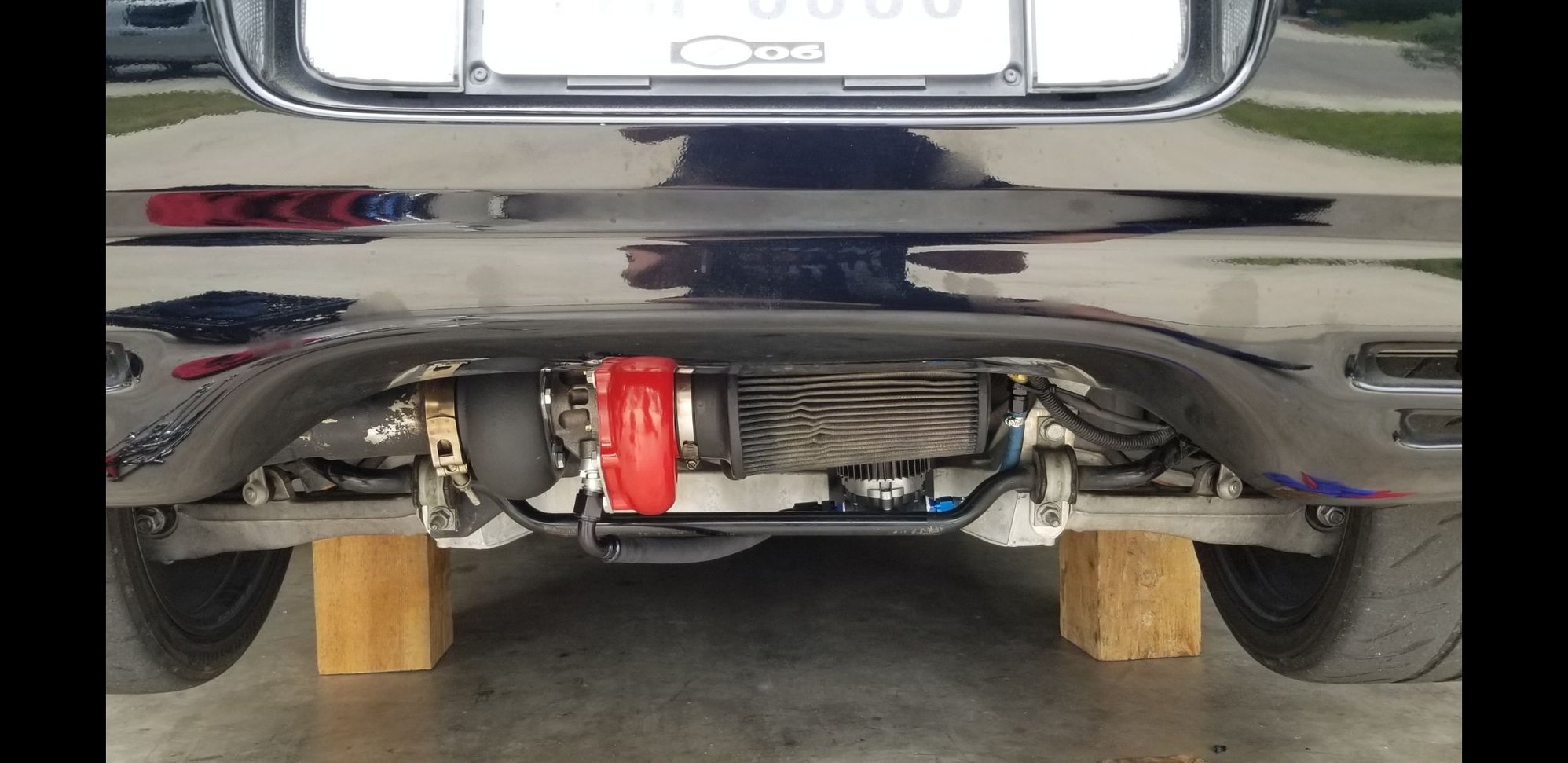

Finally think I got the oil leak sorted. Faulty check valve it was like a capillary action deal after shutdown and would slowly fill the turbo and leaks out the seals. It was the FEED check valve, not the return check valve. New check valve and was able to put the pump and lines back how they were for the most part to hide them and get ground clearance back and no leaks after driving or while running. I think it's finally read for an injector swap and do some tuning
Glad to see it's all sorted out!
But no text?! You son of a....

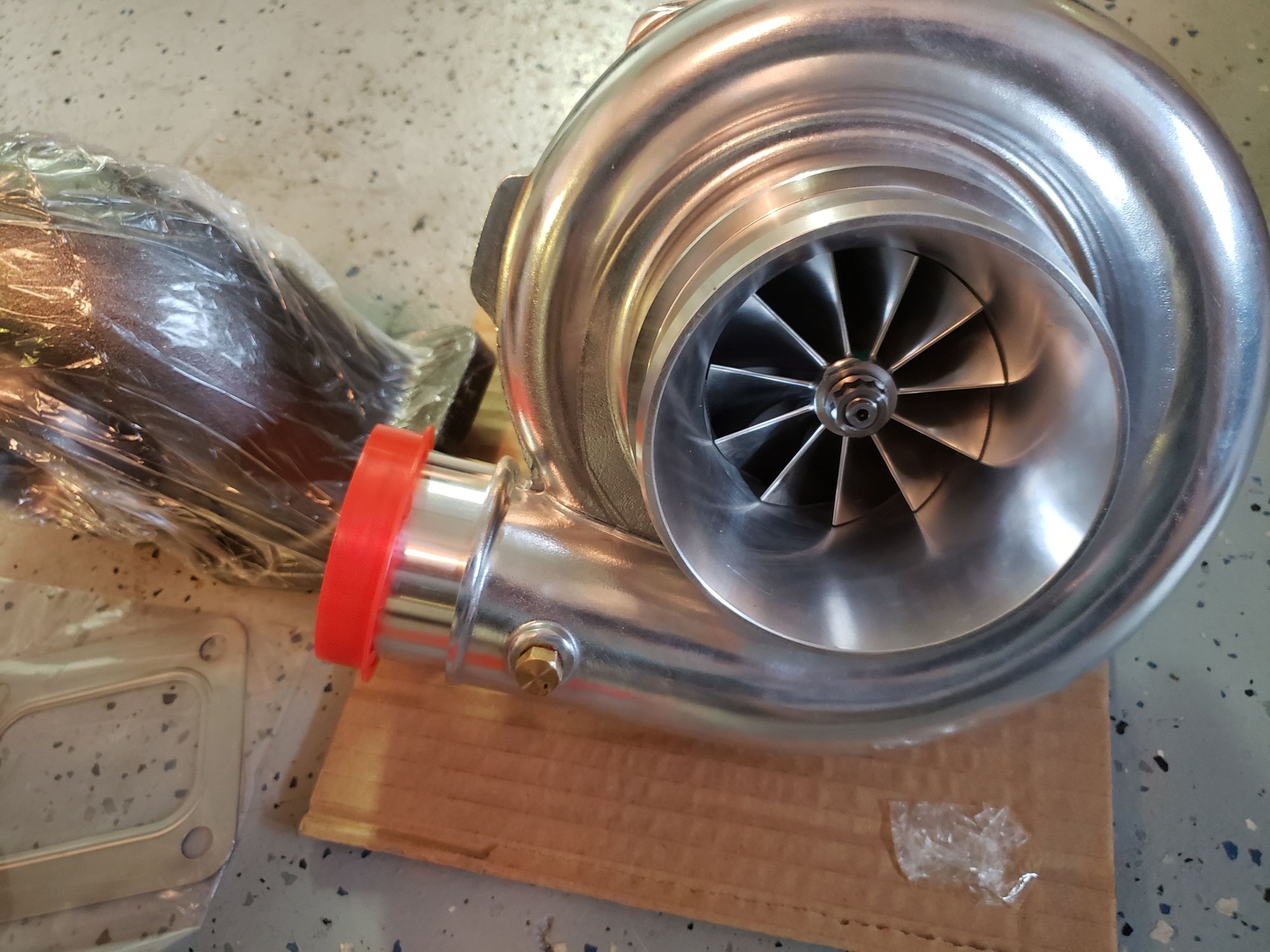

Injectors are in, tune updated.ready to start driving and getting the maf curve dialed in....also eye candy courtesy of @soloman369
Good looking unit. Your speed with this project is to be admired, seems you got all of this done within just a couple of weeks.
