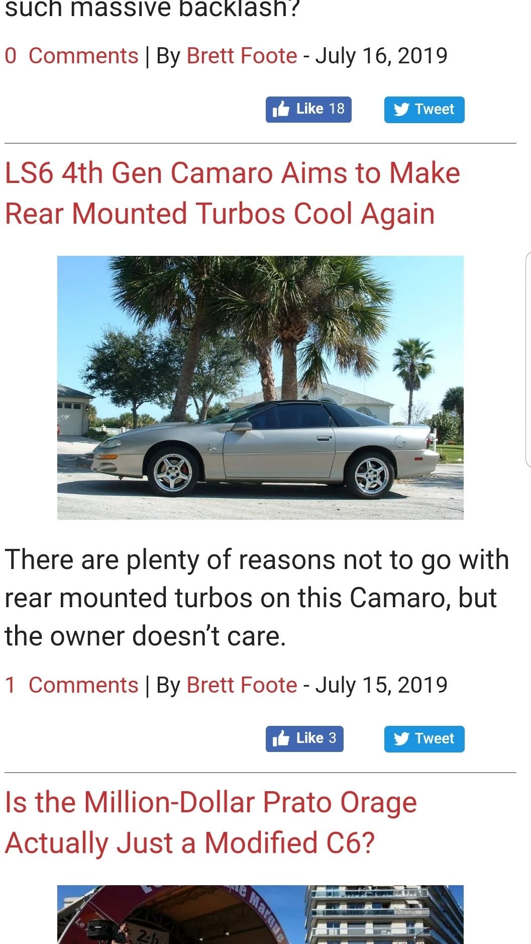

Question....how do you know when youve had too many F-body's? When your build makes the home page....and they used a picture of a DIFFERENT build 🤣🤣 used my old procharged SS instead of the rear mount Z28.

Good looking ride it was. Do you plan to run the new car this winter?
