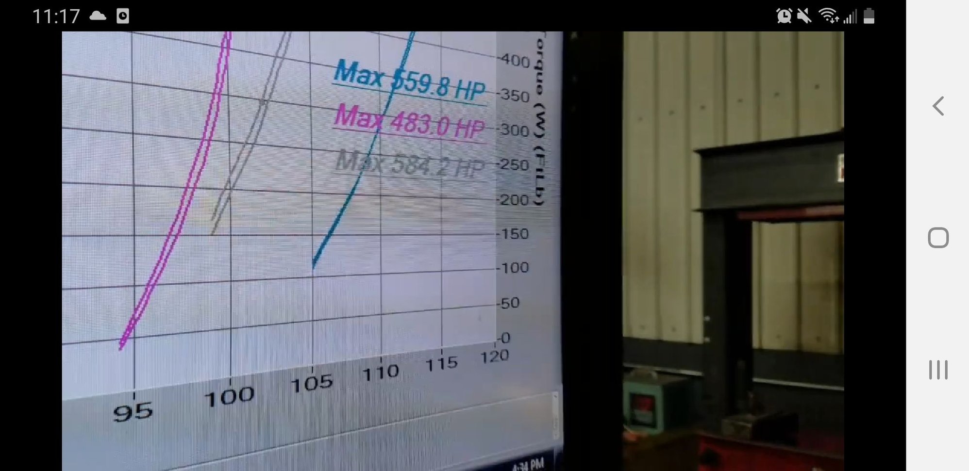

This is the most I was able to make on a corvette regulator dead headed into stock TBSS rails.
Of course this was a heartbreaker dyno so 584 HP is roughly 650-670 dynojet numbers (12 - 15%). We didnt run out of fuel or anything, I only needed the 3 pulls to get it where he wanted it and he didnt want to go any further.

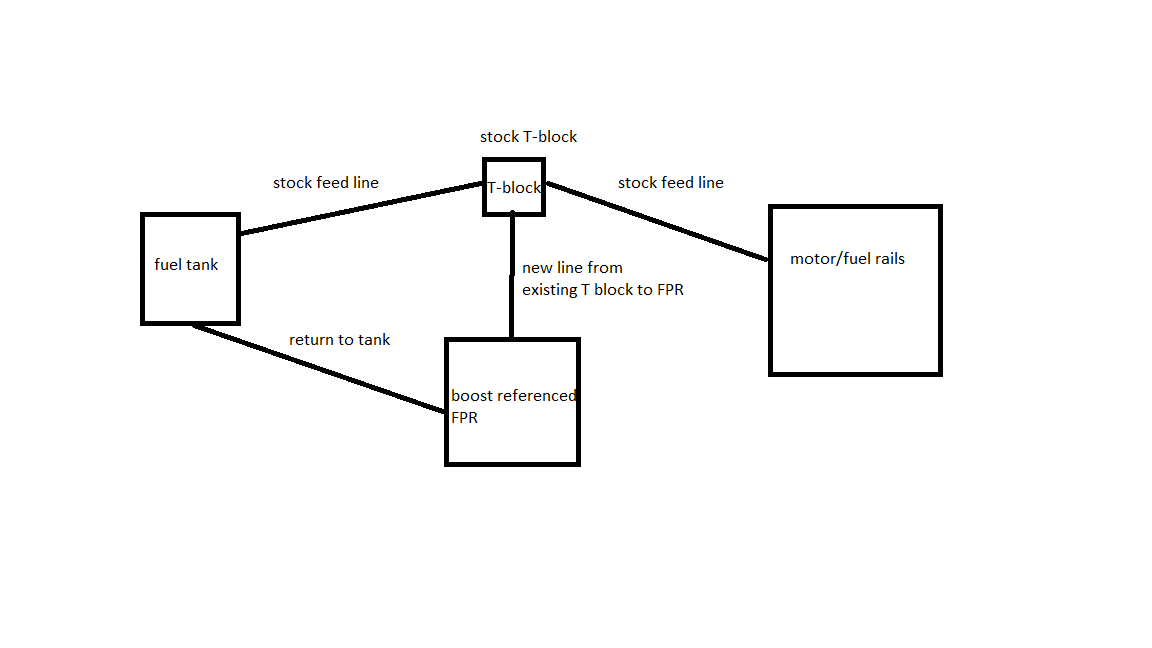

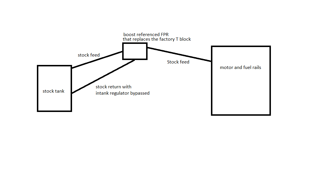

Thoughts on feed through FPR vs. single ended? I've looked at how I can add a boost referenced FPR as minimally invasive as possible and I see 2 options. Both are pre-rails (not high HP so not worried). See below for the 2 diagrams, just looking for input on if 1 has any benefits over the other. Option 1 seems easier and is less of a "restriction" since its just a precision "leak" while option 2 has the FPR as a restriction.
OPTION 1- This is the easiest and essentially is singled-ended like the factory FPR just a Racetronix boost referenced FPR and bypass the intank.
OPTION 2- replaced the factory T-block with the Racetronix FPR. Not singled ended like option 1 is.
Old Nov 27, 2019 | 04:07 PM
  #357
truckdoug's Avatar
Joined: Nov 2013
Posts: 6,389
Likes: 558
From: Portlandia
option 2 makes more sense to my little brain
Old Nov 27, 2019 | 04:09 PM
  #358
ddnspider's Avatar
Posts: 14,628
Likes: 1,778
From: FL
LOL, option 2 is definitely more traditional....but I realized that option 1 is the same as stock but with a better regulator so it SHOULD work with less restriction. It's easier for me to add it too....trying to get input from people who've either done both or can logically explain why option 1 is bad.
Old Nov 27, 2019 | 04:10 PM
  #359
truckdoug's Avatar
Joined: Nov 2013
Posts: 6,389
Likes: 558
From: Portlandia
well cos weird and complicated
Old Nov 27, 2019 | 04:23 PM
  #360
ddnspider's Avatar
Posts: 14,628
Likes: 1,778
From: FL
Its actually LESS work. I can remove a short section of return hose where it goes from Hardline to gm quick connect and put the regulator right there. Unclip the stock intank regulator and done. Removing the T block is a PITA with special fittings and now 3 lines have to be messed with. Then you still remove the stock regulator.
