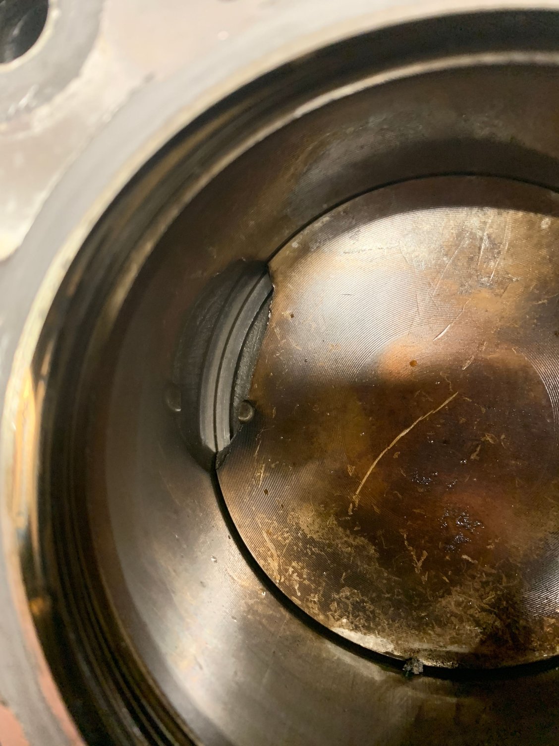

Originally Posted by Kfxguy
I just did this at 11-12psi in 3rd gear only. Rings butted. Cyl7 of course. Pump gas. No meth.
had I been using meth or e85 it wouldn’t have happened I’m sure. O well.
Not to hijack but hopefully for good reference for all, any idea where ring gaps were at? Were 7 and 8 plugs showing more heat than others? Can you add fuel to rear cylinders only? Plan to do additional coolant flow hole mod in head gaskets?

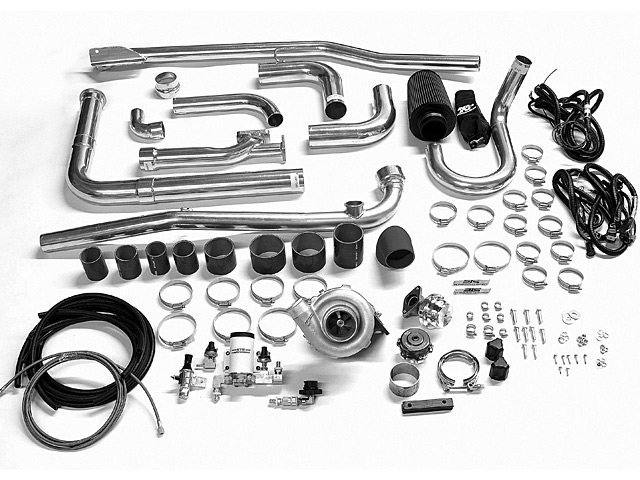

I like to party LOL, talk to STS. That's how they designed the kit however many years ago. I modified their kit as far as turbo location, output of the turbo to the "subframe cold side pipe", and then after the FMIC. Everything fits/tucks much better and I'm obviously running the LS7 MAF/4" tube over the stock stuff. About the only pipe I didn't touch is the subframe cold side pipe. You can see the top pipe in this pic:
http://assets.superchevy.com/f/89381...640&height=426
see this thread and I answered your questions. I don’t wanna muck up his thread.
