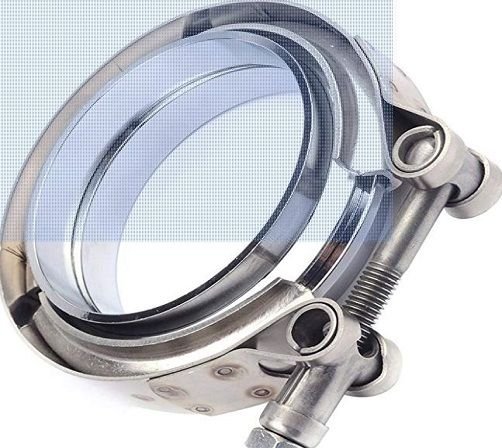

Use: (Band style)
Do *not* use: (Obviously, exhaust style)
You're not crushing pipes with the band style. And you're getting a better seal.

Those above are an example of a low quality T-Bolt clamp. Not sure why V-Bands are being brought into it though
And adding a lubricant to a hose you do not want to move when secured....is clearly a bit silly.
