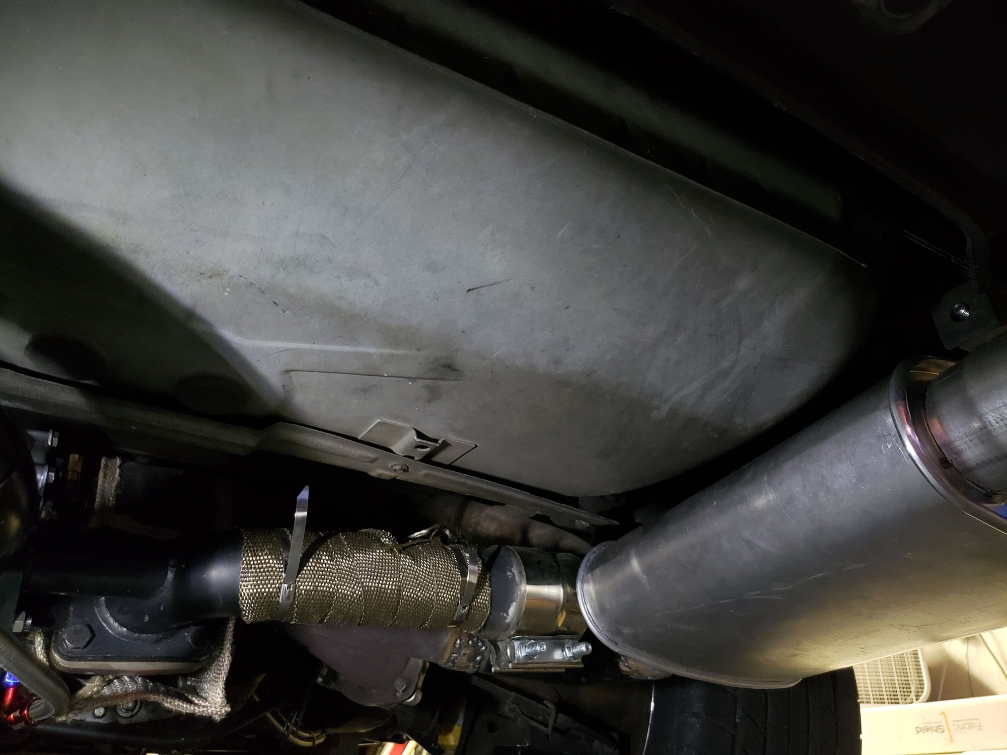

Well, pretty sure I set a record for the shortest full length exhaust with a full size muffler and an electric cutout it's not the black pipe in front that's wrapped with the bolts, that's the hot side. It's a pipe behind it same length.
It works awesome...in the garage at least. Nice and quiet closed and rowdy open. Quick idle clip.
LS7 maf in a 4 inch tube is ready to go.
Just need to install and swap fuel pumps and it's time for tuning again.
