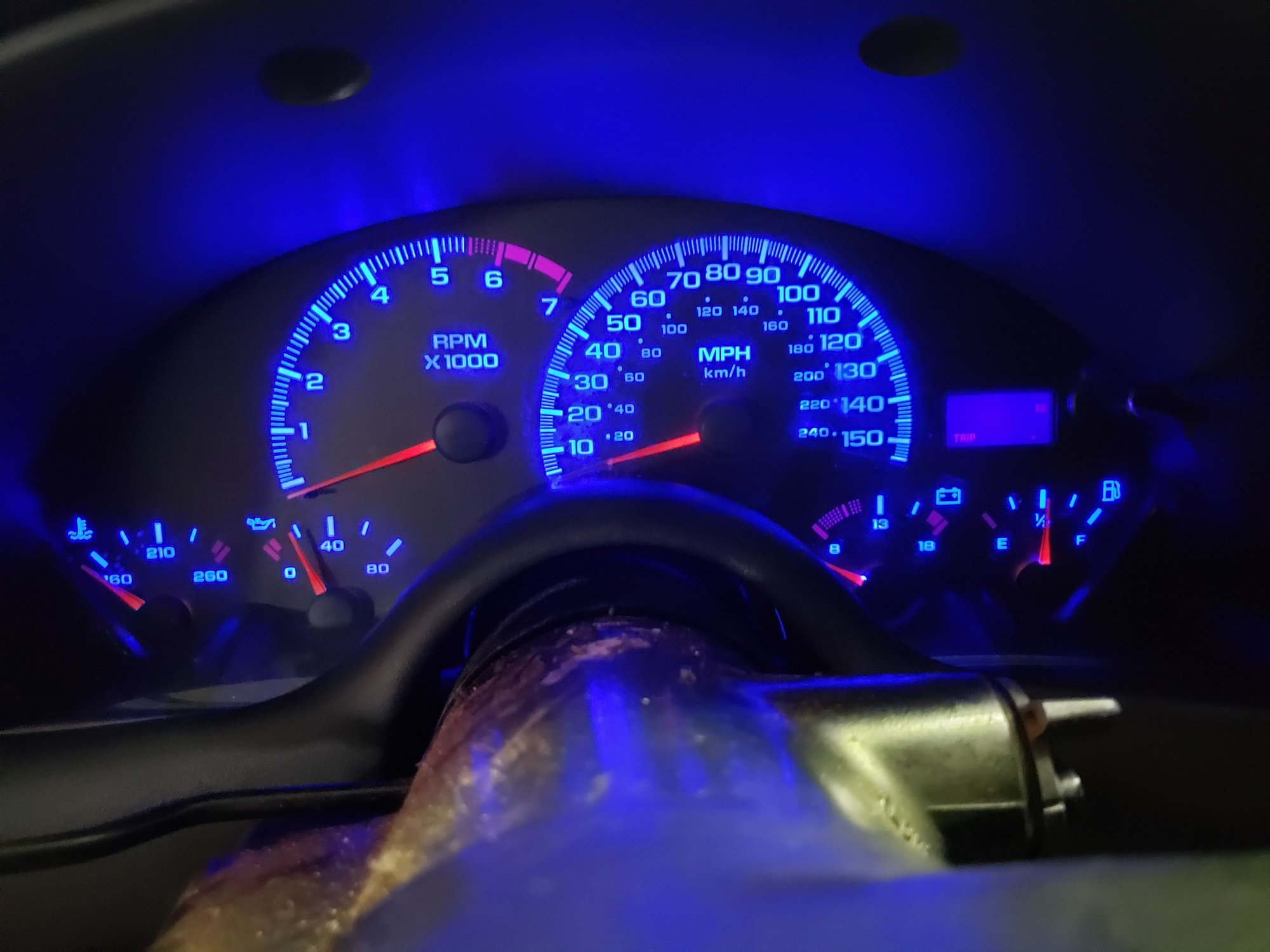

Oh and I decided to play with see el cheapo LEDs in the stock cluster since most of the factory bulbs were blown.....
