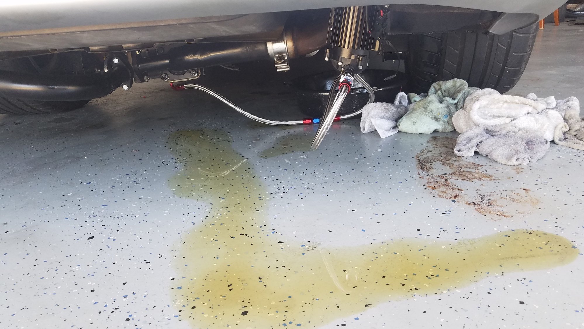

Looking for some input here. Having an issue with oil leaking after shutdown and it sits. A bit of chicken or the egg as far as is it the return line and scavenging or is the turbo bearings shot. I tried multiple iterations, repositioning and removing as many bends and turns in the fittings as possible and finally just let the line sit on the ground. With a check valve after the pump and the return line lower than the turbo, oil shouldn't flow back into the turbo after shutdown. The feed line has an .035 restrictor and a check valve located at the turbo to prevent it from draining into the turbo. It appears most of the oil is leaking at the turbine inlet flange. Does this setup seems reasonable to show it's the turbo? TPIZ28 gave me another idea to try and let the turbo drain into a pan and let the return line suck from the pan and see how the flow and level is which is on my list. I simply don't want to keep tweaking the pump locations and lines if the turbo seems shot and needs to be rebuilt or replaced anyways.
Does the car smoke? If it was the turbine side, you'd definitely know it. And I hate to be that guy, but did you forget to put a gasket on the drain?

.035 restrictor? Is the turbo a JB or ball bearing? If JB I wouldn't run one. Does sound like a seal. If you got a spare turbo around can you hook it up and just lay it on the ground, prime the oil and see what it does? I like the pan idea. I always wanted to do a dedicated oil system for a turbo with a tank, cooler and pump.
It's been kicking some oily mist out the downpipe while running but not after shutdown. The drain fitting is screwed straight into the turbo with Teflon tape, no flange.
I realize an .035 is small, but just want to get the oiling solved first then worry about tweaking stuff. No spare turbo unfortunately. I looked into a dedicated system but didn't like the idea of a 2nd pump, a cooler, a reservoir, etc. Leaning towards turbo but don't want to spend 450 to be in the same spot lol. Hence the pan idea.

Why do you need a 2nd pump? Turbo drains into a pan, pan feeds pump, pump feeds oil to turbo or a cooler which feeds the turbo and the cycle continues. I guess the issue with yours is height, if the turbo can drain into the pan effectively (just needs to keep the level lower than the bearings) and the pump can prime out of the pan you should be good.
