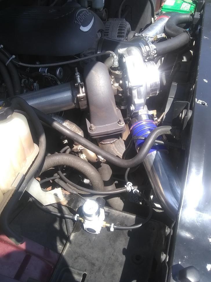

Just wanted to give everyone an update. I’ve installed the 30psi regulator and it’s working well. My compressor housing has a brass barb the runs directly to the bottom of the wastegate. No more signal being taken from the intake manifold, that only feeds the 3bar MAP and the boost gauge now. The line running out of the compressor tee’s off and goes into the inlet of the adjustable regulator, and then continues out to the TOP of the wastegate to help the spring keep the gate shut. Now I can just spin the **** to increase the pressure keeping the springs shut, which effectively raises the boost.
Before I installed the 30psi regulator, I set it up on my workbench with an air source to try to figure out the curve of how it regulated down and how sensitive it was. Last thing I wanted to do was spin the **** one turn and push the boost past what my motor can handle. Using another regulator, I hooked up shop air (110psi) and regulated it down to a reasonable input that I might expect from the turbo compressor housing, such as 15psi. With that as the new “input”, I started with the 30psi regulator fully shut and slowly opened it up until it was only allowing 2.5psi to pass; this took about 1 turn. Continuing to open up the regulator one turn at a time was actually gave more resolution, as it took about 2 turns to get another 2-3psi out of it. Right now I have it set to about 3 turns “out” from fully shut; boost gauge reads about 11-12 psi at full steam.
