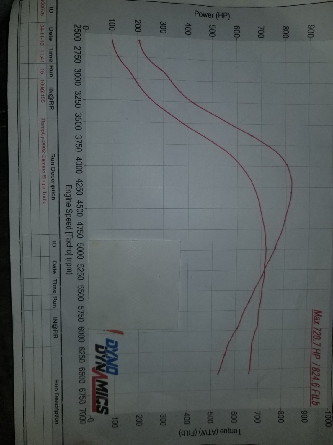

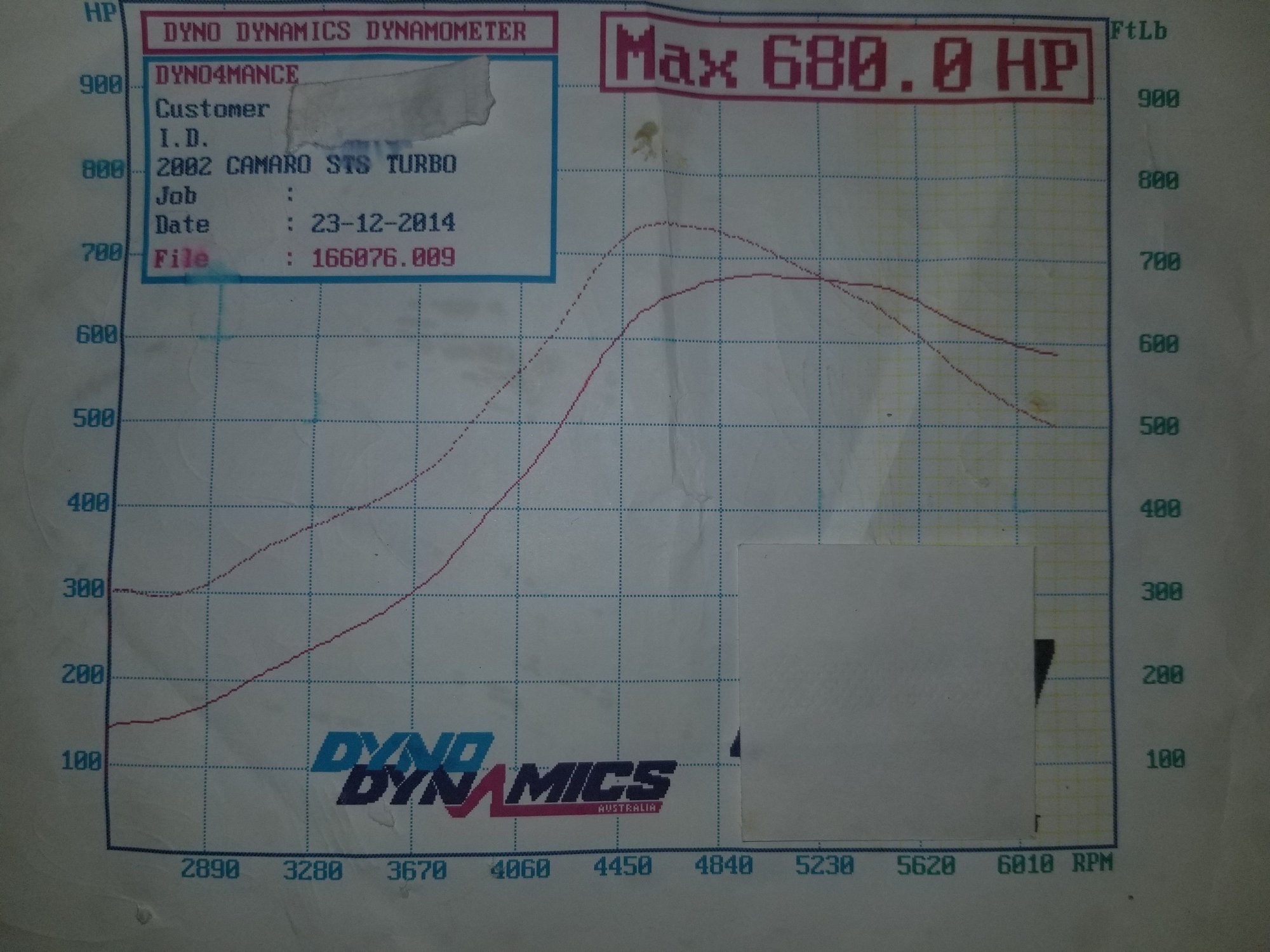

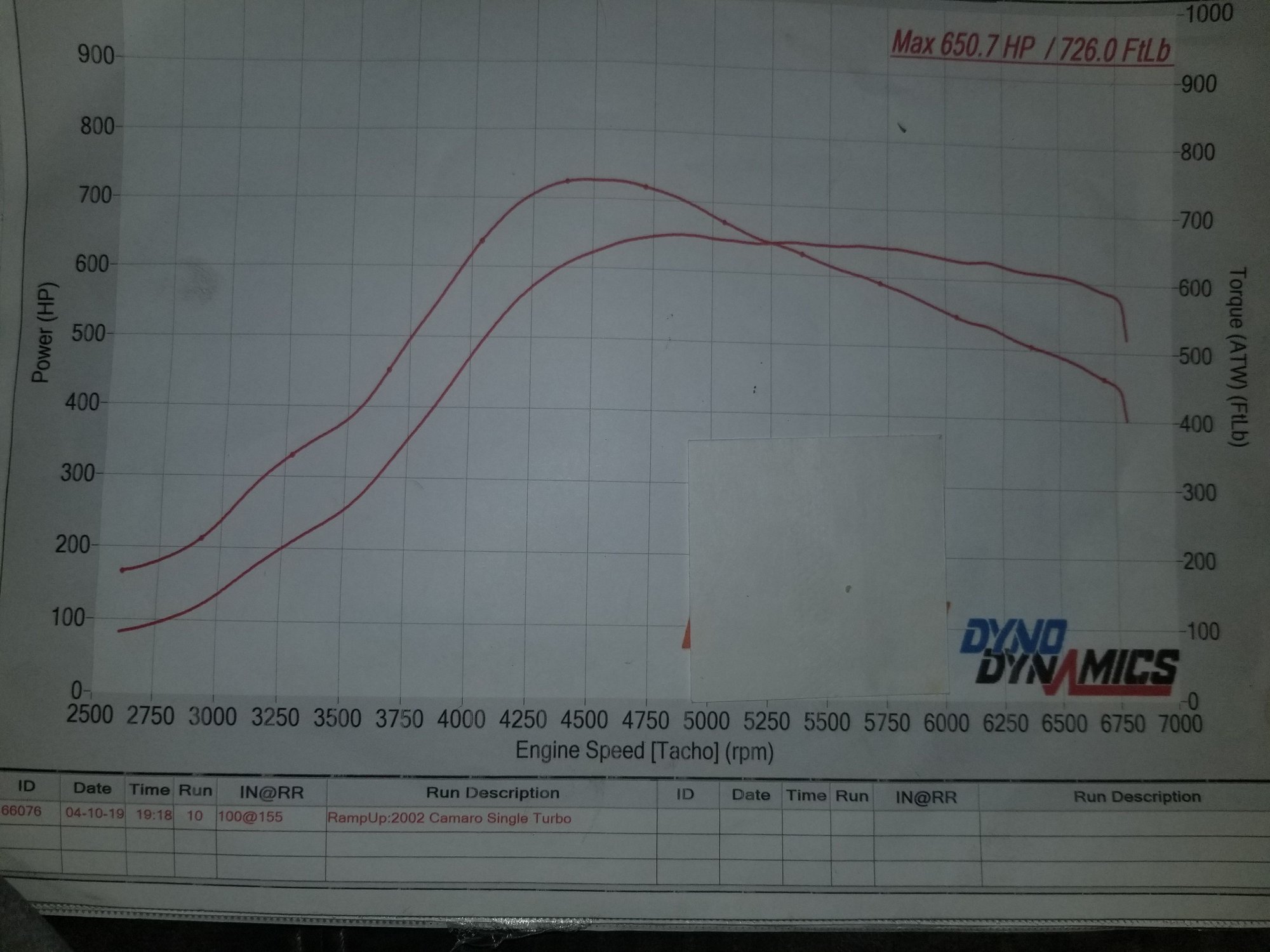

Default Dyno graphs dyno dynamics
Originally Posted by NicD
8.5:1 compression is relatively low, that's what my old combo was because it was originally built for 91 octane since E85 wasn't really a thing back then. That power level doesn't sound out of the ordinary for the octane level through a TH400 though and a lot depends on the dyno being used, etc. Where is the dyno graph and what kind of dyno is it? Picking up 100 rwhp with another 5 psi of boost tells me it's on the right track but you could probably get away with more timing on C16, it's a pretty slow burning fuel. Read your plugs, adjust from there.
Pump gas bw s480 all the same cam huron kit fti th400 15lbs Dyno dynamics all wheel drive dyno.
Sts kit 6speed Garrett 76mm 14lbs
Race gas c20 20lbs 15 degrees th400

OK so it's a dyno dynamics dyno, user configurable, no guarantee on the results being all that accurate so I wouldn't put much faith into the actual number itself and just concentrate on the improvement. I assume I'm supposed to be looking at the top graph and the bottom graph for comparison? Not really familiar with C20 but apparently it's similar to any other unleaded 100 octane? If so it's burn rate is pretty similar to any other unleaded fuel which means faster than C16 for sure so you need to keep timing in check. Really this is going to come down to putting in a fresh set of plugs and making a full pass at the track and then shutting it off at the end and pulling them out to look. That's ultimately going to tell you how close you are to optimal timing or you can keep adding timing until MPH stops going up but at some point you are going to have to read the plugs. Your MPH at the track is going to tell you if you are on the right track or if something is wrong.

do you have a data log with fuel consumption? sometimes that helps me decide whether the dyno is being stingy or generous. if you have fuel flow that matches the power output, it leads me to think the dyno is close.
Old Aug 2, 2019 | 12:39 PM
  #36
ddnspider's Avatar
Posts: 14,628
Likes: 1,778
From: FL
^This......injector duty cycle don't lie.
