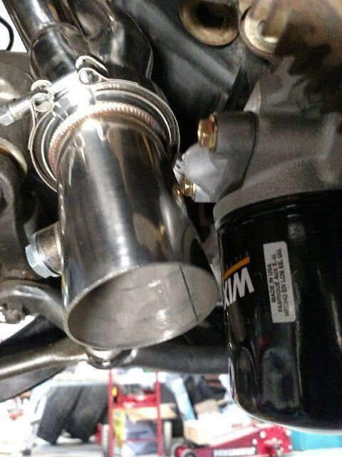

I don't have enough room for a block with the port for a fitting. The exhaust is only about 1/8" from touching the one I have (which is 3/4" tall and does not have outlet port) and the blocks I have found with the outlet ports are 1" tall. I am stuck with a very tight fitting header because it is the only one I can find that clears the power steering box on my 1st gen. Camaro.

Here is a pic of my tight clearance. Picture doesn't really show the problem very well. I am still going to try to make a modification to the collector and or pipe, but am looking for an alternative if I can't make it work.
You ain't lying lol. I f i had known you could use the top port i would not have spent $180 on that oil line.
