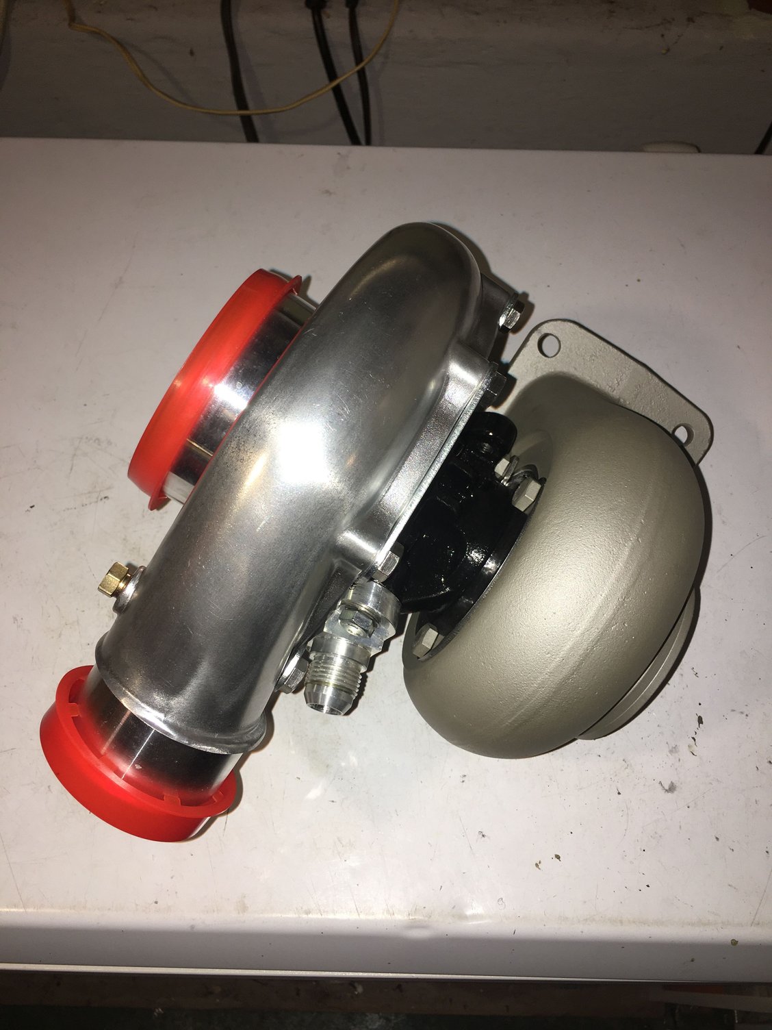

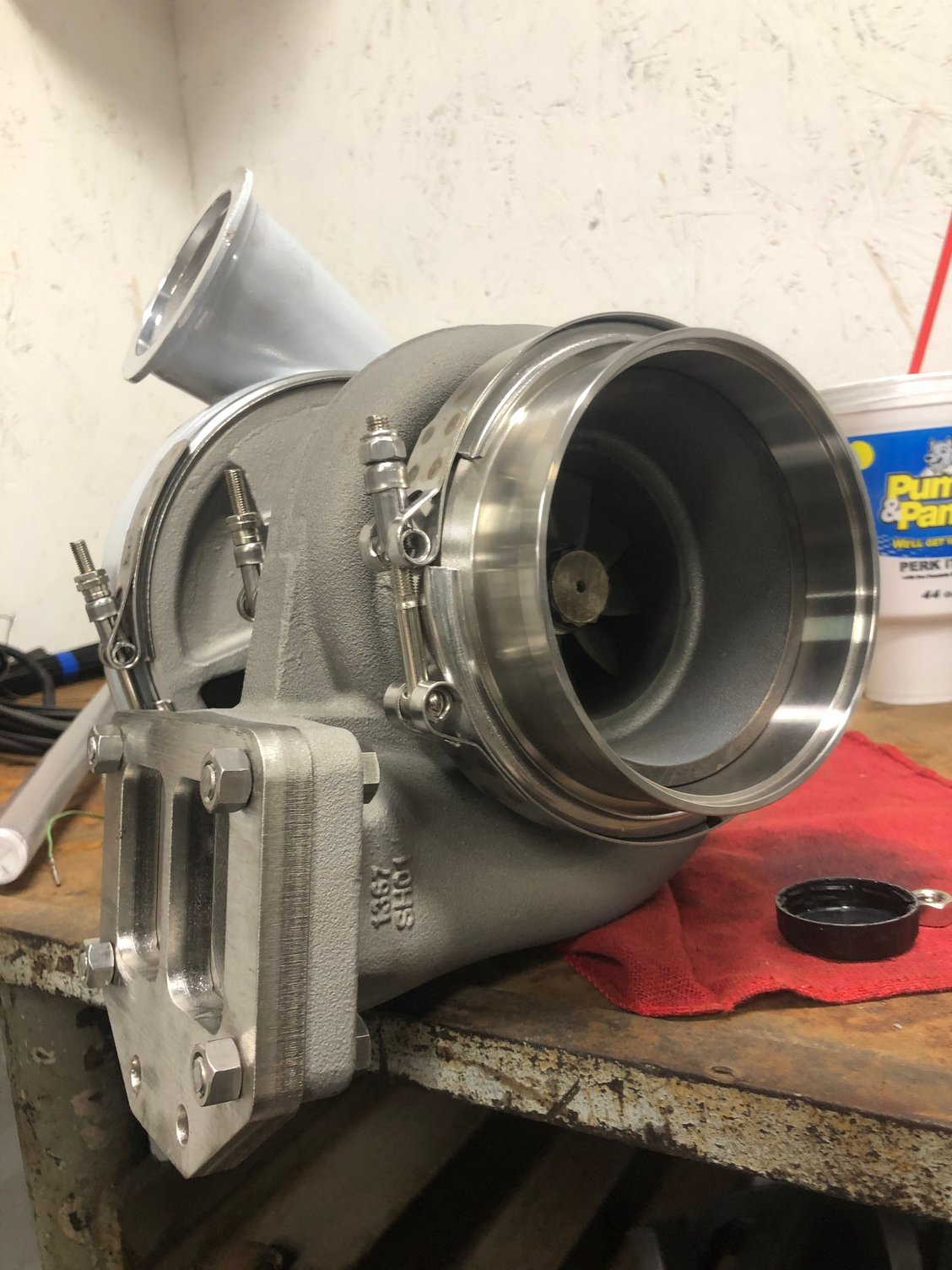

I want to get my turbo hot side parts ceramic coated. I'm masking off the areas I do not want coated, but am not sure about the v-band flanges. Should the flanges get coated or no? Will coating the flanges cause issues with installing the v-band clamps?

I agree. I’m not coating the mated surfaces. I was curious about the backside of the flanges where the v-band actually clamps onto the flange. I don’t think ceramic coating (ie. Jet Hot) is super thick. Not sure if it really matters or not so I wanted to ask.

I coated the vbands. But it depends on the style of vband. I coat my own with creakote ceramic coating and it’s super thin like a mil or less. The vband clamp will scratch the coating off a little but I like coating it better than leaving it bare. I did. Not coat my bellow as I figured if it flexes/expands then the coating will chip/flake.

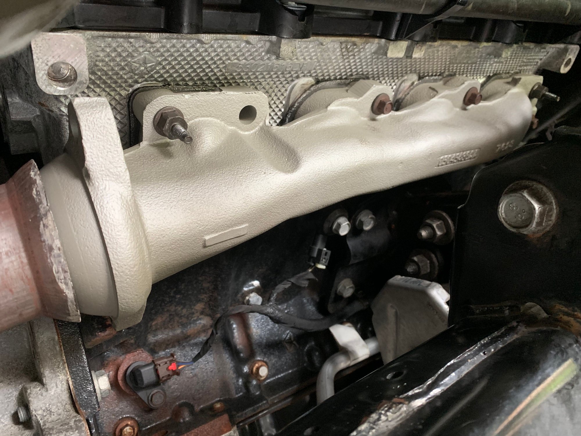

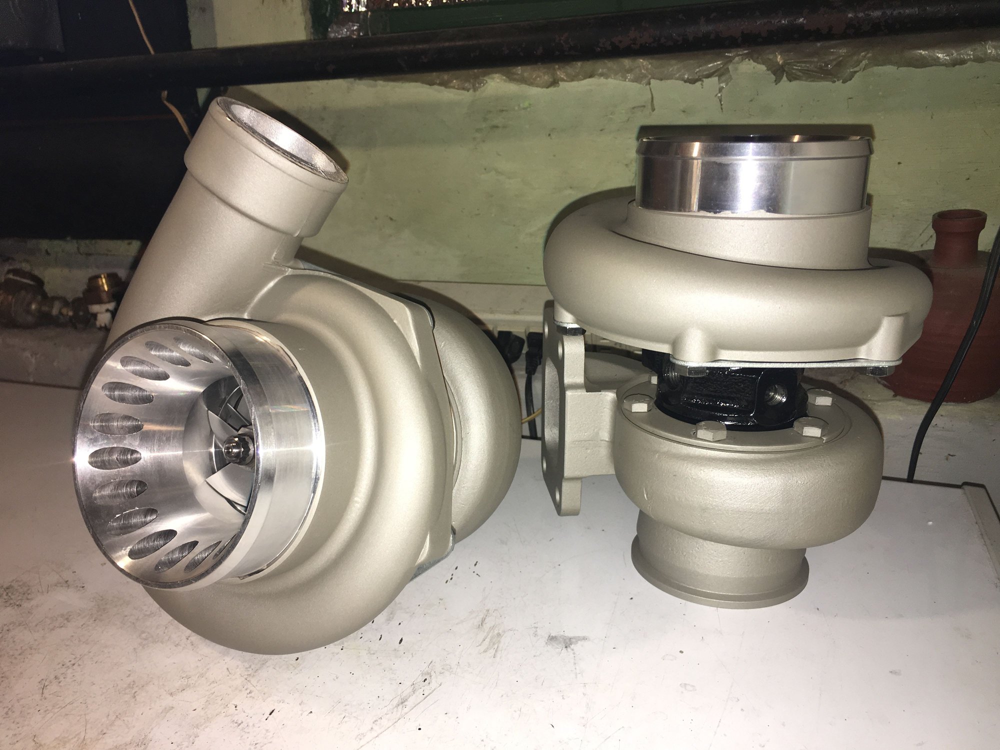

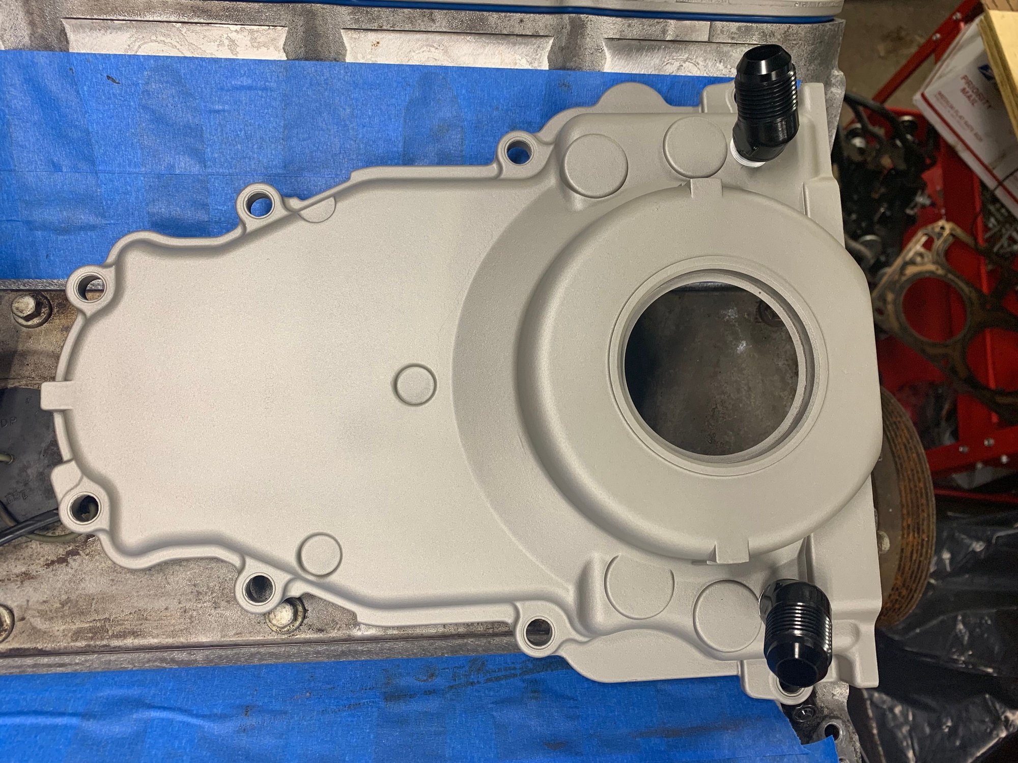

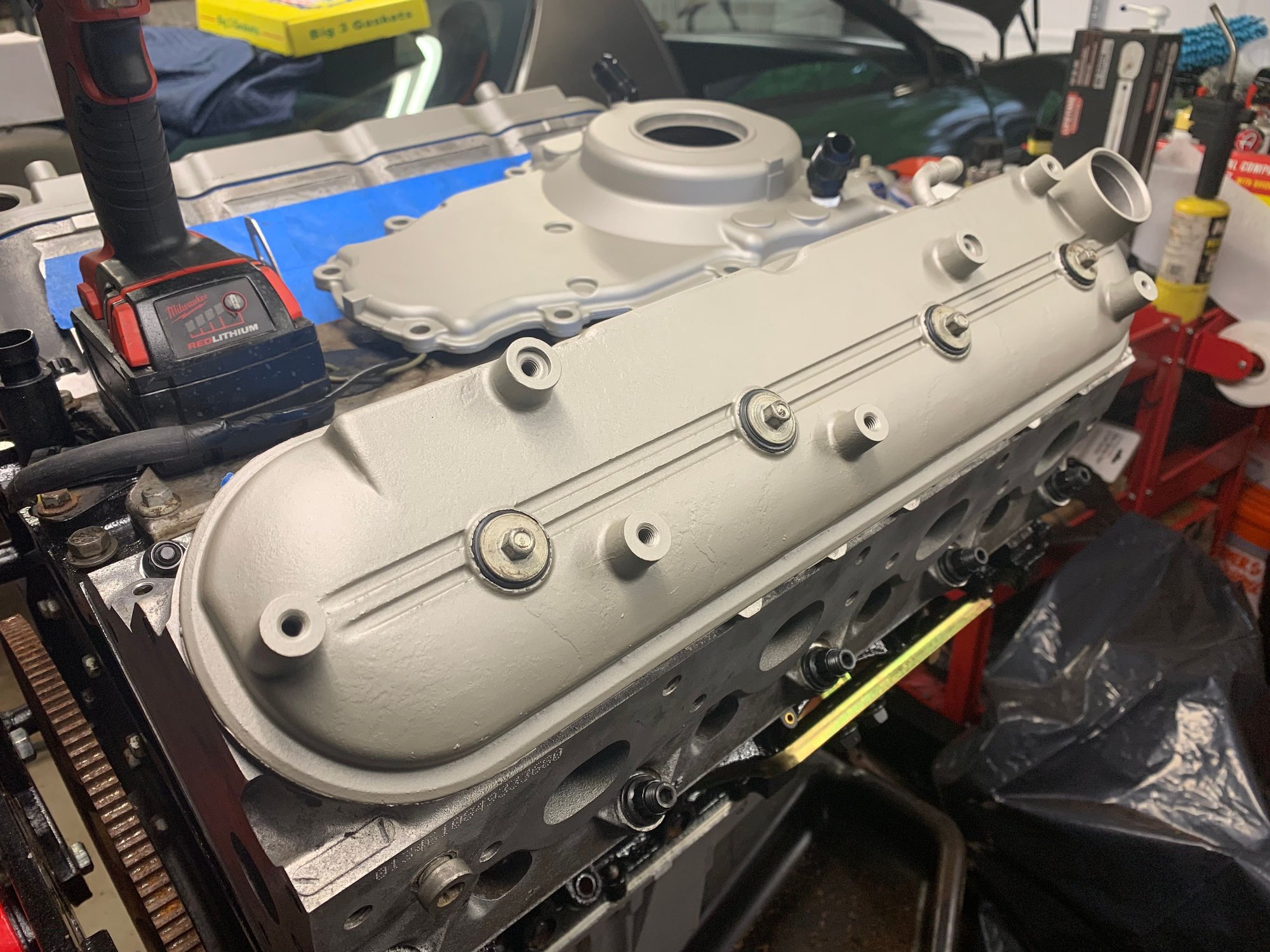

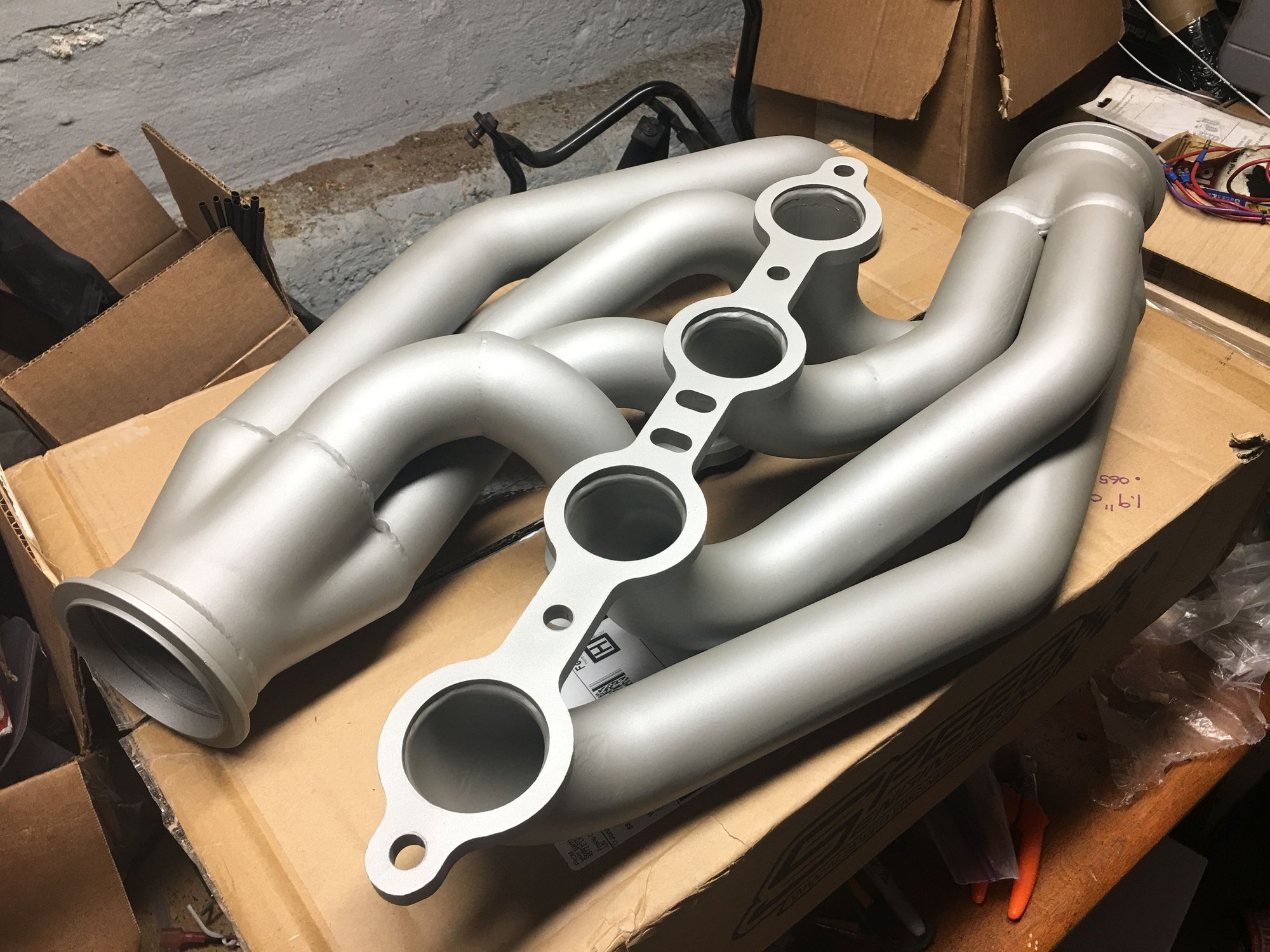

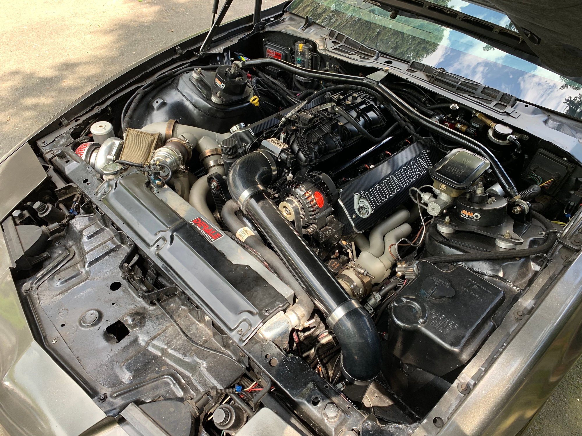

I blast the parts with 70grit aluminum oxide which breaks down quickly against stainless and becomes finer. Then I use creakote air cure ceramic with a HF $8 air brush and HF air brush compressor. The coating is like $80 for 16oz or $40 for 4oz and I have used 10-12oz but I coated 4 turbos, my whole
front mount hot side and down pipe half way down the car, 2 sets of shorty turbo headers, a set of exhaust manfolds and dual 38mm gates, timing cover, valve covers. I use about .5-.75oz per header. Let it air cure for 24hrs and it can be handled and installed. Full cure in 5 days or you can install and the exhaust heat will cure it faster. It’s the easiest and best coating I’ve used thus far.
My blaster is $130 from HF (40lb. Last cabinet) and I got 50lbs of 70 grit from HF. All together prob $300-350 invested and I’ve coated over $1000 worth of parts easily. Guy quoted me $350 for just my headers. Stuff is tuff and sticks really well.

Billet VS 78/75
Twin VS 61/62s
Timing cover
Hemi 5.7 ram manifolds
Valve covers
Hotside

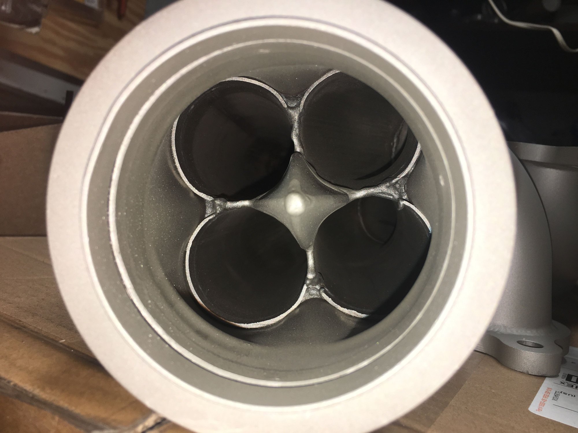

Originally Posted by gbtwo
I want to get my hotside Cerakoted but I'm not sure if I want to do the inside of the headers. It looks like you coated the inside of yours, how has it been holding up? I fear that it might begin to chip/flake and possibly end up damaging a turbo
Hard to say but I coated a few and they look clean on the inside. I also use water meth which keeps the chambers and header stupid clean, basically a steam clean. I haven’t put a ton of miles on mine but I put 2k on some Hemi shorties coated inside and out and they had no issues or chipping in about 2 months. I have yet to see the creakote chip at all or flake. The stuff is wicked tuff compared to normal paints and stuff.
