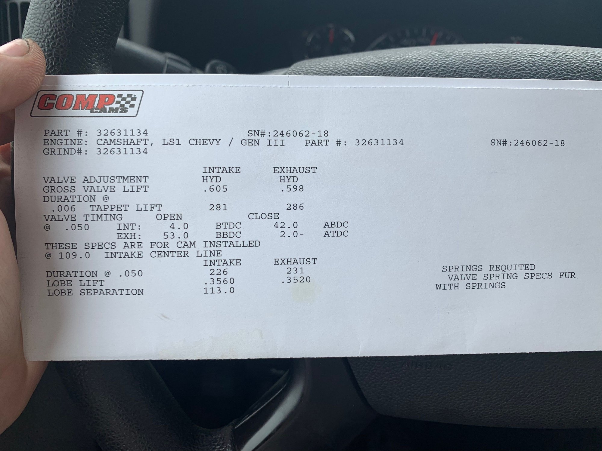

btr stage 2 cam (card in picture)

that is a bigger cam than I would use for 600 hp. i'd size down to 21x/22x and like .550 lift for valvetrain stability
but that is just my free advice
and you know the old saying, free advice is worth every penny
Thanks for input. Do you think this current cam would be rough to drive around town with or bad idle? Or just unnecessary size for the 6-800hp that was mentioned?
