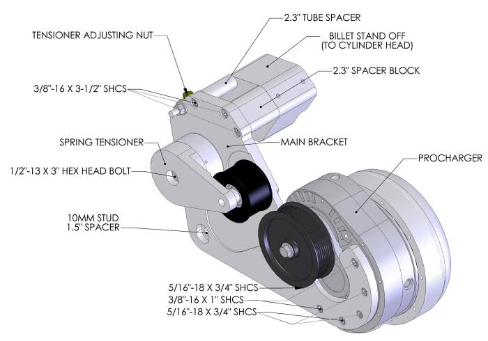

Here is the GTO bracket and tensioner. It seems to work very well and I currently don't have any belt slip. I was just curious if the griptech was worth the additional cost since I'm going to be buying a smaller pulley anyway. The only issue I've heard of with the GTO procharger setup is the bracket flexing which then does cause belt slip. I've seen that more with the larger blowers though and that was fixed by installing a support from the blower to the top of the mount where it attaches to the cylinder head.
