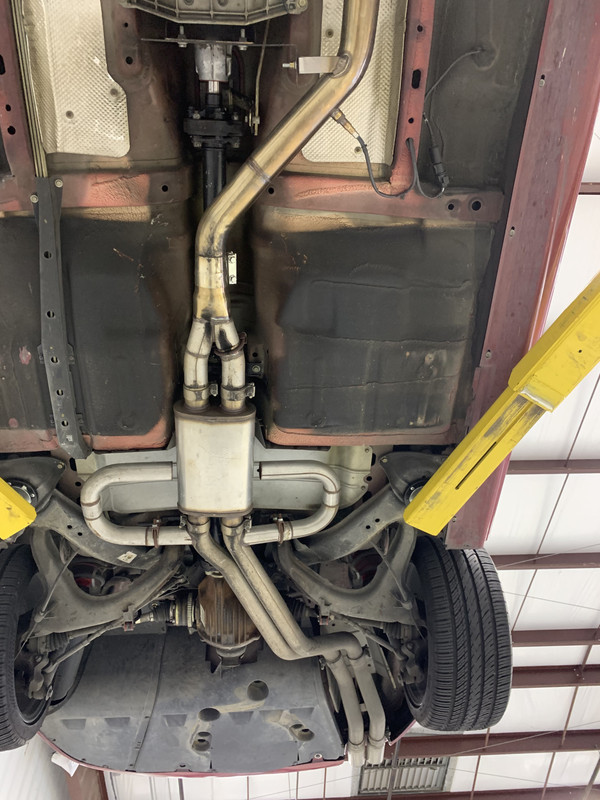

This is the garbage I have now.

OMG!!, What in the.....
I mean, what is with those side connections on the muffler??
J pipes. Or helmholtz resonators. I could not stand the 1800-2200 rpm Drone i had. Yes they look stupid, but yes they really do work. its got rid of 90% of the drone. having those ugly things on there was 110% worth it. Btw, they arent actually connected to the muffler. just the pipes.

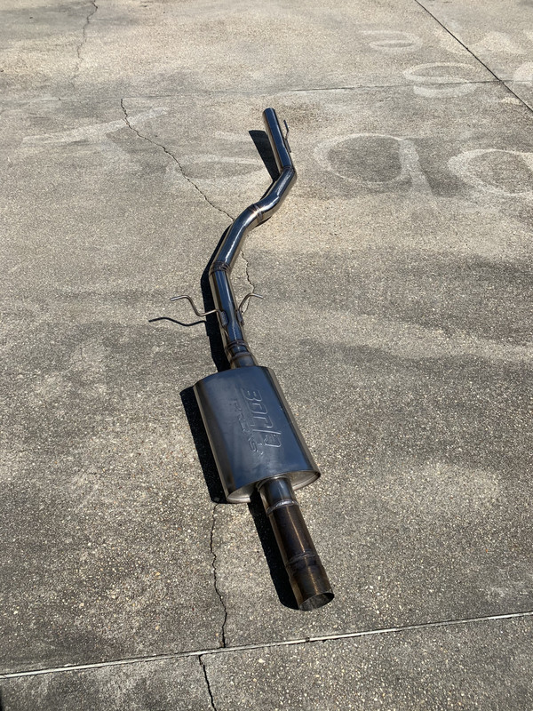

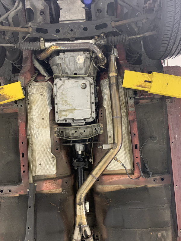

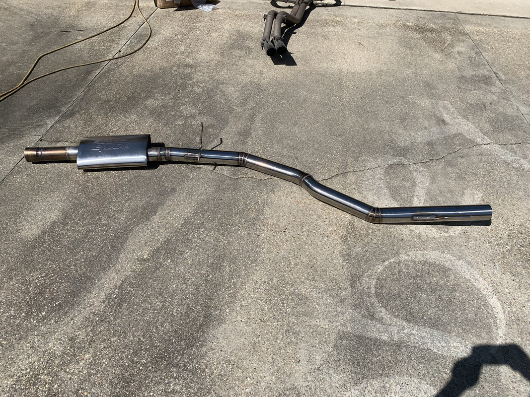

Got the exhaust done. Turned out pretty damn good except the welds. They aren’t bad but they look like three or four different people welded it lol. Why? Well my shop is a wreck and I couldn’t get comfortable while trying to weld. And I hadn’t welded since I built this turbo setup which was shockingly over a year ago. Time flies I tell ya. Damn.
anyways. I’m in the middle of a break, eating lunch. Finished exhaust earlier and now I took it and the downpipe off. I shouldn’t have been looking, but I have an intermittent squeak/rattle and I noticed the downpipe was sitting against frame. So now I’m having to whoop the pipe a little in that area. No biggie.
heres pipes of the exhaust. Btw, old exhaust weighed 46.2lbs and new one weighs 19lbs.

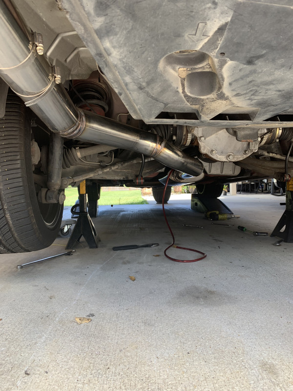

Btw. Hose clamps are gone. That was just to tack the hangars in place lol.
Hers a video
