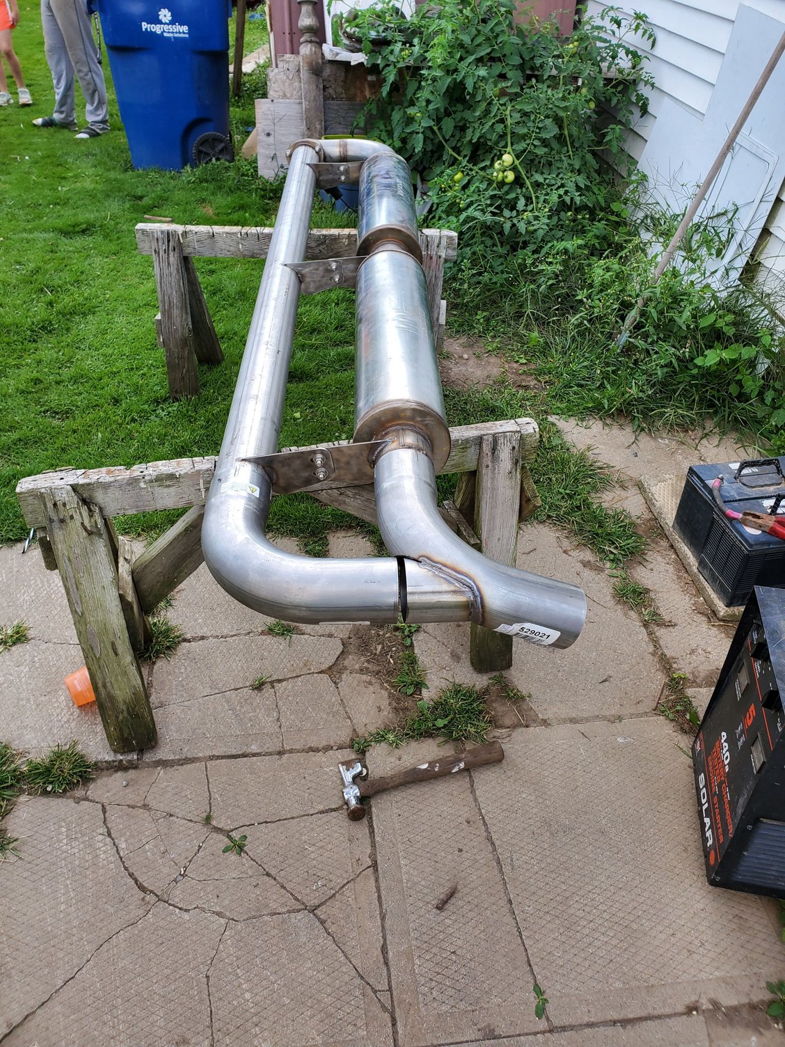

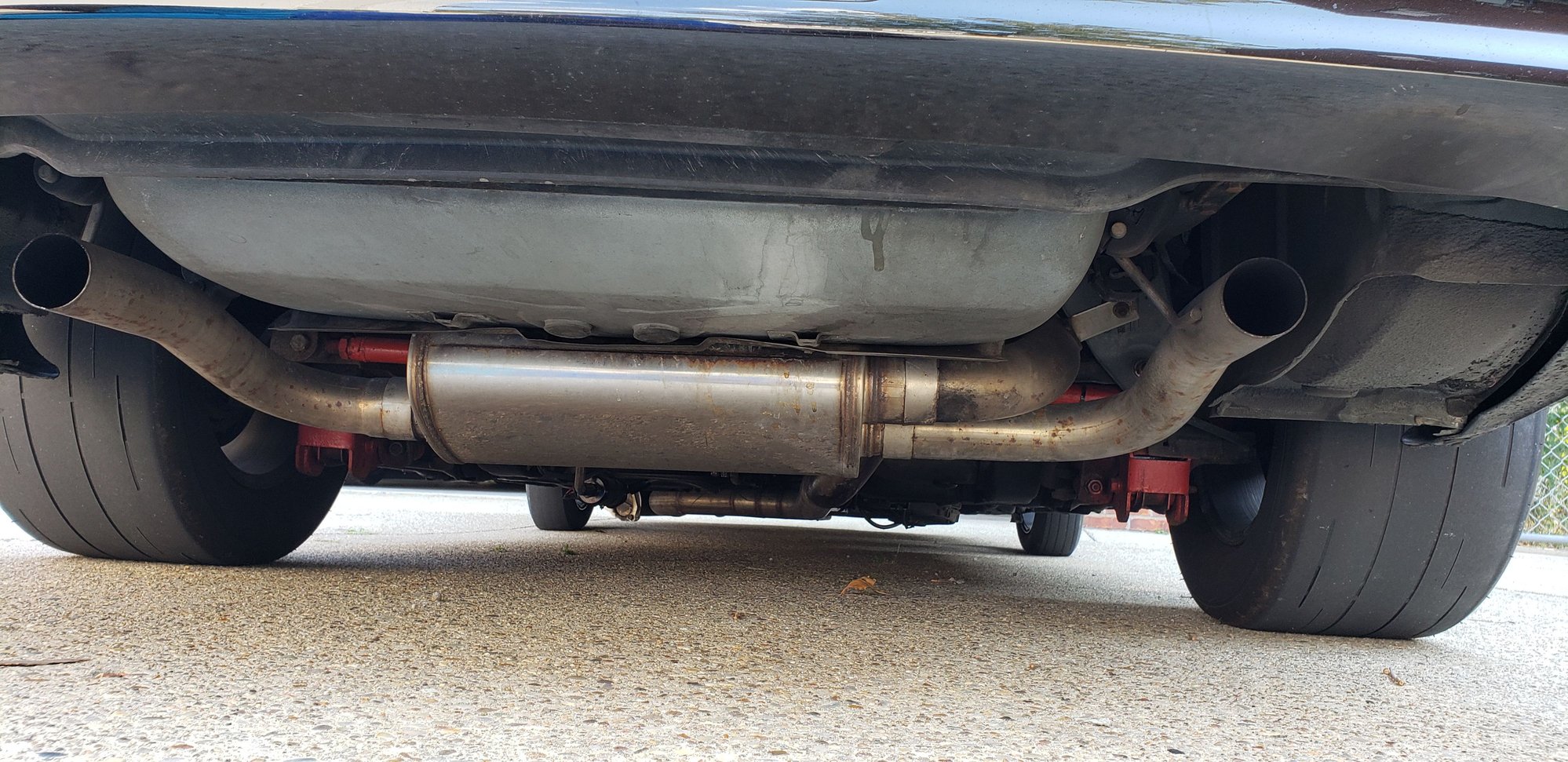

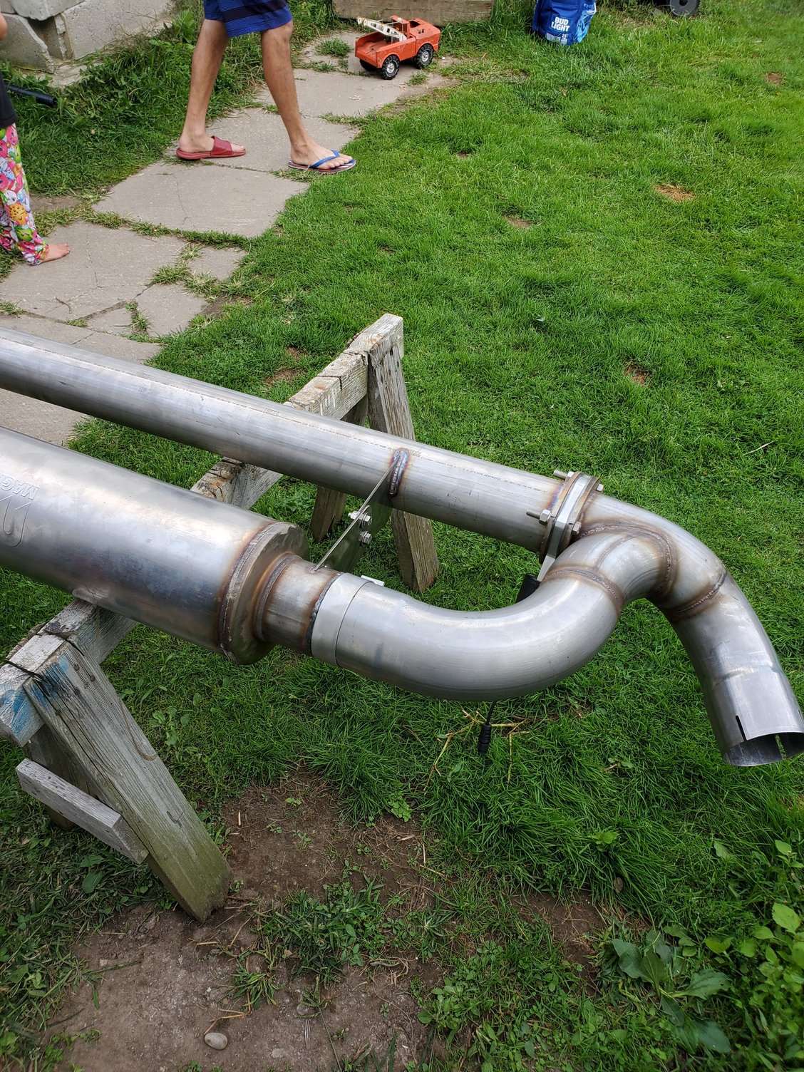

I love idea 3
I just did it for my RV exhaust
Routes back into 1 so sound comes out same hole in the side of the body
Front
Rear

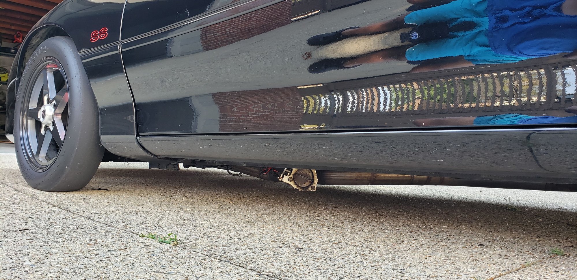

It absolutely will not rattle your car. As you can see here, mine is literally right under the drivers seat, and the car does not rattle. It goes all the way out the back, through magnaflow muffler, and is whisper quiet. However, when it becomes necessary to gaptize someone....or to just play some, I simply press a button in the console. You're making this much harder/complicated/ more expensive than necessary.
