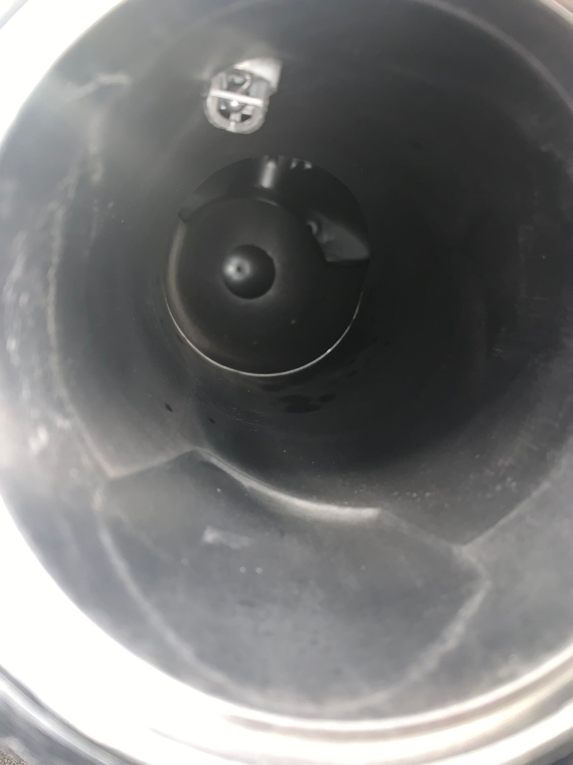

Supposedly the stock intake manifolds pool water/meth vs distributing it evenly... they also allow the bulk to go to the back 2 cylinders. Like truckdoug said I'm glad it does with the bulk of #7 cylinders committing suicide. I have been running water/meth in ONLY truck intakes for a few years now and never had any issues. I run 15psi on the cheapest 93 pump I can buy and shoot alittle wiper fluid for extra safety. This is on a street only car but I'm in boost at just about every second I can be lol. The best is the smell the burnt wiper fluid gives off after a boost pull... smells kinda sweet. I inject as far away from the TB as possible (After my FMIC) to help with cooling the charge as much as possible. Ive tried injecting around the TB and it sorta makes a mess but I inject a good 3ft away now and I see no residue at the TB or in the intake manifold. I just pulled my TB to drill and tap the water pump for a temp sensor and snapped a pic of inside my NNBS intake which was BRAND NEW and has had a few gallons of wiper fluid sprayed inside it over the couple hundred miles its been on the car. I will find it and add it to this thread.

I don’t see any pooling do you?
No not at all. Like stated above Prometh just might have been trying to sell me a direct port kit. Its a beautiful kit but not NEEDED. How many GPH or CC nozzle do you run?

The nice thing about the blue wiper fluid or the pink/red boost juice is the dye after it dries shows up pretty easily so you can see where liquid has pooled/run. You would see dried pool reminiscent or fluid running lines if it was clinging to the walls inside the intake tube.
