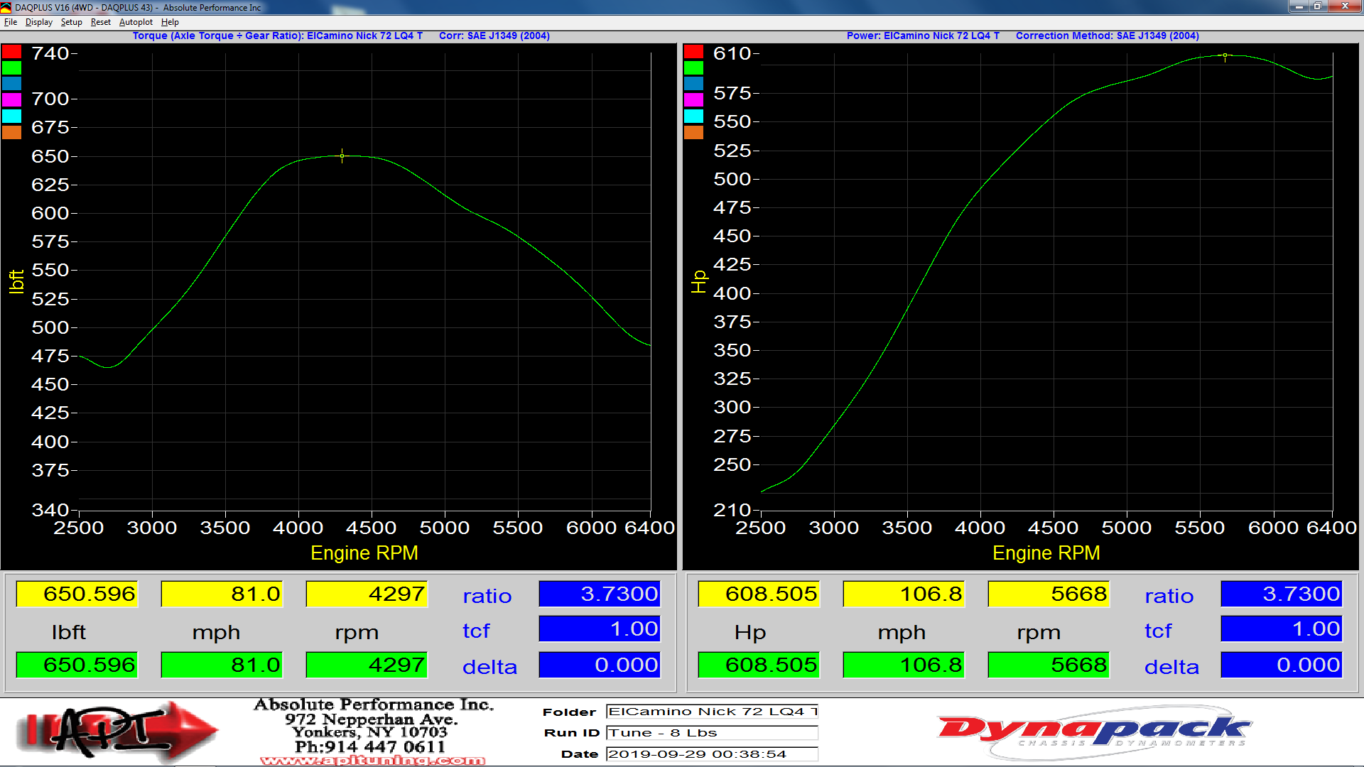

SBE lq4 tick stage 1 cam, s475 t6 1.32 ar , 1000cc inj, truck manifolds int and exh,2.25 hot side, stock truck t-body. jgs wastegate running 12lbs boost and a t56 with 373 gears in rear.
this is my first turbo build was wondering if these numbers are good? this was on a hub dyno

Yeah that seems about right. How much timing and what fuel?

just glanced at logs and timing is 16.5 degrees and using 93 octane. im using a ms3 pro as well

thats pretty damn great on 12psi
i guess i must have done something right or it is a happy dyno lol

should i lower boost? it will not last or add meth injection to make it last

read the plugs. if they're happy, you're happy.

thank you we did on the dyno after the pulls and they all looked good
