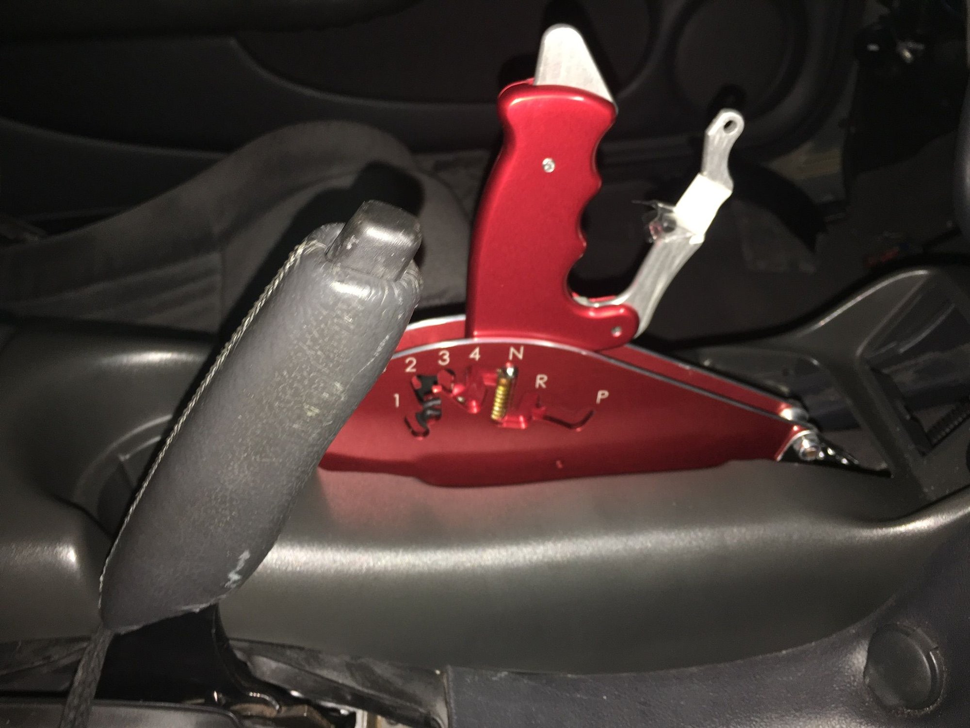

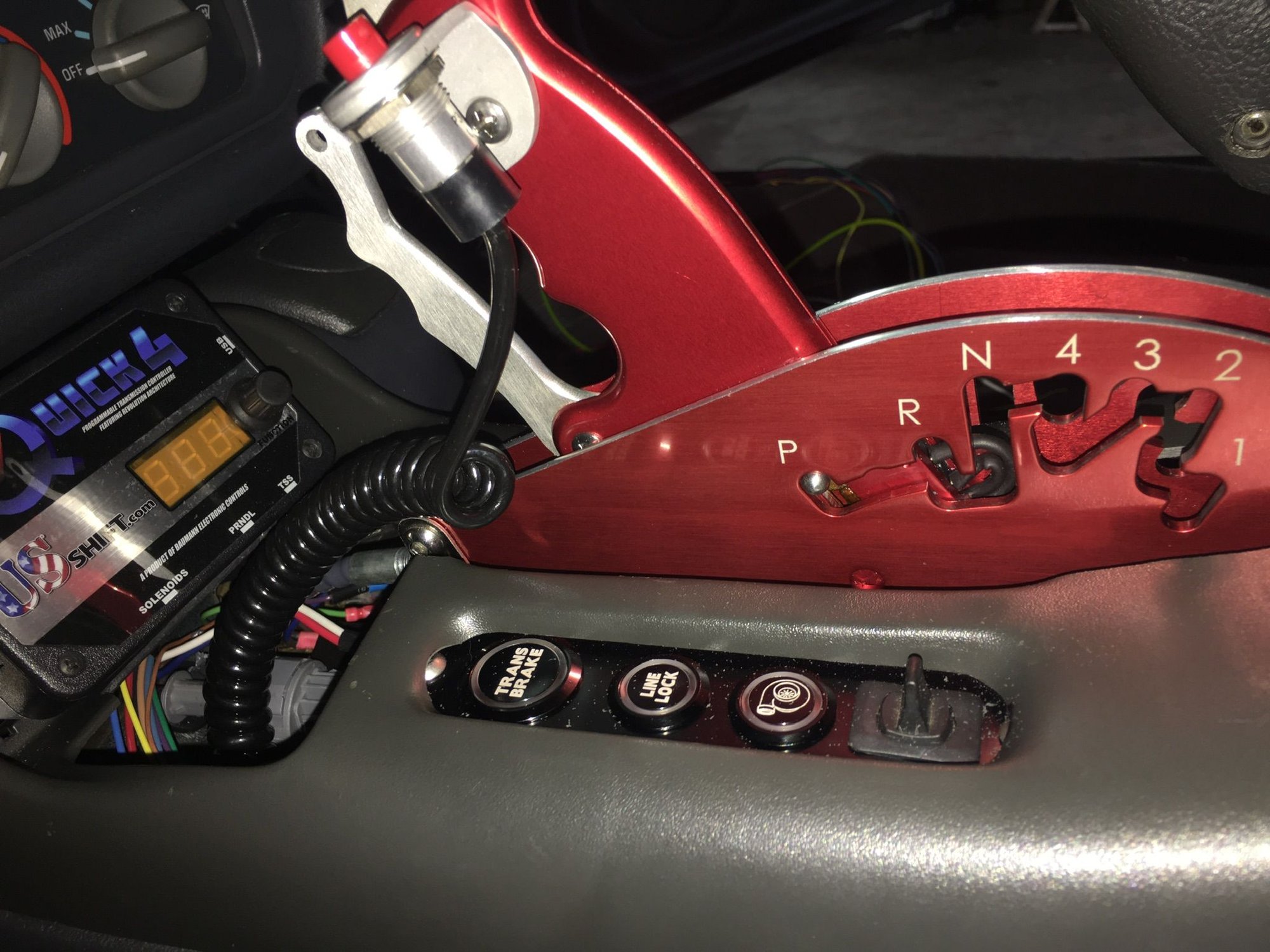

I'm a bad influence to ask. Precision. Let me get on my Ipad and post a pic

Buy it from Century Performance though not from Precision directly.

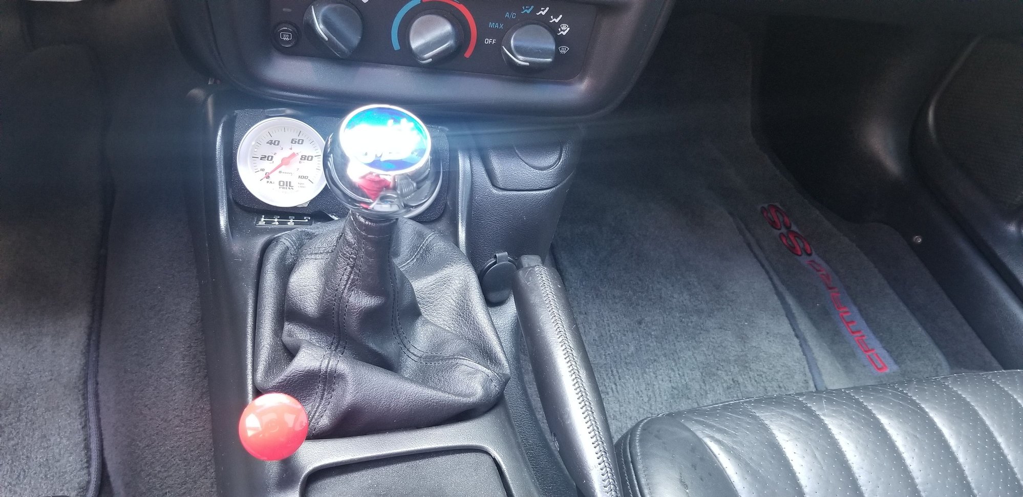

I vote quicksilver. No special levers, and only requires one hand.

Unless your manually shifting it, why? Adapt any gm shifter from 1994/+ .

For me it was getting the geometry to feel good from park all the way to low. This original poster though isn稚 in a gm. I could get it all like I wanted but at the time I was trying to get a D1 transbrake to be crisp and the factory shifter and the different cables I tried I just never liked the ends of the spectrum. I got close though with a b&m cable, lowered the ball that I installed on the stock shifter with a precision products 4l80 arm and pan bracket. The arm and bracket for a 80 is the trick. There are posts where guys merged two to make one and used the stock cable with good results. I decided screw it and bought the shifter.
Now I have pulled the early 80 and d1 and put a late in with stock valve body. The late prndl makes life much easier if you want reverse lights and the nss to work. Had I had this 80 in it initially I might have left the last version of my stock style shifter in it since d1 wasn稚 so important any longer.
