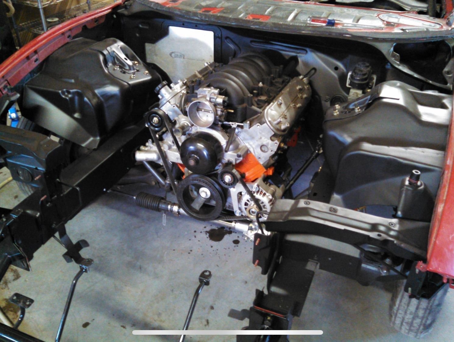

Just a random question if anyone here is running this set up. I’m about to drop a 5.3 into my 95 fbody. I’m doing twin turbos no ac trying to get by with stock k member for now. Has anyone used the up forward facing long tube style header 1-3/4/1-7/8 primaries to 3” collect and then the 90* vband t4/t3 flanges? Great deals on eBay for the headers even used ones. Trying to avoid the truck manifold and stock k member issue if I can run the accessory drive For these headers. I measures the shock tower supports and it’s 28” between them. So does anyone have measurements on how wide the headers are on the engine mounted facing forward? No company has info and they use them in other builds. Just curios if they would fit my little 95 fbody engine bay? Any info or pictures of it done will help I can’t really find any on the 4th gens lots of 3rd gens though. Thanks guys

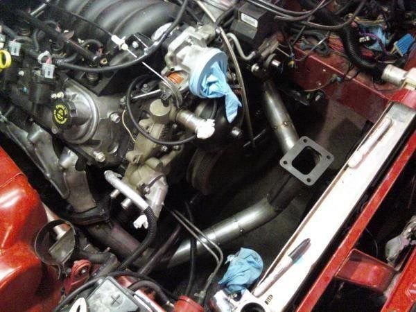

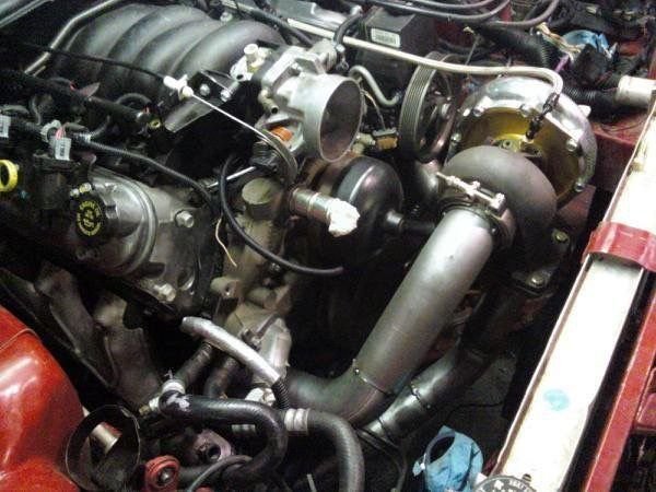

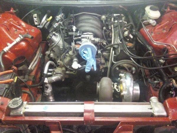

what manifold issues with the stock k member are you referring too? I build my first turbo ls car in 2007 when I was 19 and I had zero issues with the stock truck manifolds turned forward. I did relocate the alt to the pass top side of the motor. It was a 96 Lt1 car with a 5.3 swapped in it
my current car has a tubular k member and a manual pinto rack so using it as a example won’t work. But I used the truck manifolds has on it as well and everything fit great (I did cut the manifold flanges off and welded v bands on)

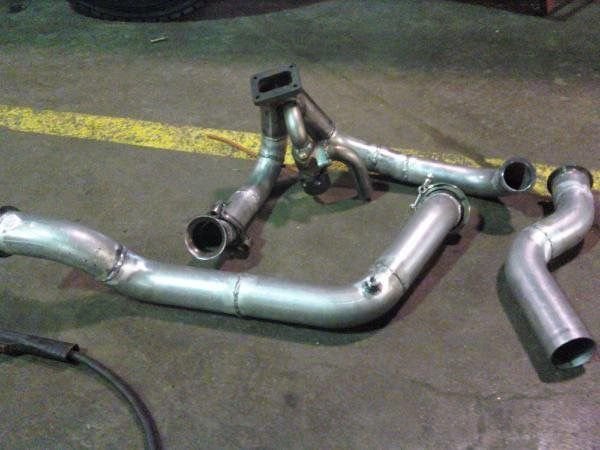

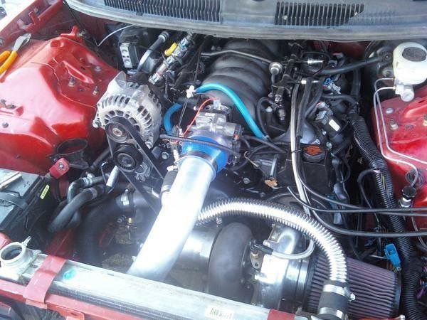

Here is pictures of the one I did when I was 18-19 years old. Stock truck manifolds flipped with no modifications. I used the factory flanges on the mani’s and everything. New car I have I changed everything so it might not be as helpful

I should mention I built my own motor mounts on the Lt1 kmember. They were super slick and gave gobs of room for a downpipe in comparison to stock junk. So that very well could have played into that.
Originally Posted by chevykev
And I assume you notched the center support for the radiator there?
Yeah on that car I cut the entire thing out and welded in some rectangular stock and strapped the radiator to it. I didn’t do anything on the bottom.
Current car I cut it all out. Top and bottom. Then I got creative and made little mounts for the bottom to sit in.. bent round stock on the engine side to support the radiator... then the headlight bracket sandwiches it in

Well I placed it pretty much 99.9% where the factory mounts place it. It just gave more clearance for a downpipe.

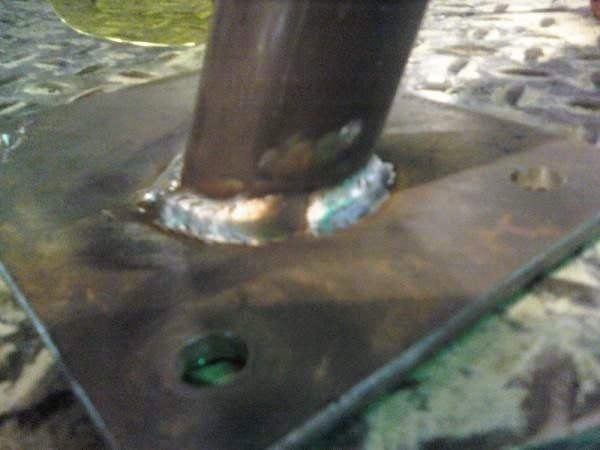

But instead of those big ole gawdy clam shell mounts.. I bought some DOM tubing from thorbros (aka suicide doors) and some standard 4 link bushings from them as well. I made two plates that bolted to the motor.. then welded a piece of tube to them with the 4 link bushing on the end of the tube. On the k member I welded two tabs with holes drilled in them. Then the bolts went through the tab, through 4 link bushing, and through the second tab.
Sounds daunting but hear me out. I was 19 with very little to no fabbing experience when I built this car. I did the motor mounts, the tranny k member (cuz I ordered the wrong one), and the turbo kit. I also wired and put a 2 bar custom operating system on the pcm, as well as tuned the car. Zero experience.
building the mounts took 3-4 hours.. cost less than $100 (at the time).,. I didn’t have to buy a k member or deal with swapping the Kmember. My motor mount bushing were closer to a poly mount and far cheaper/easier to replace then the factory mounts. Not typical but You should consider it as a option.
Unfortunately this is the only picture of the mounts I have. This plate bolted to the block. On the end of that bar was the round tube with the bushing in it.
