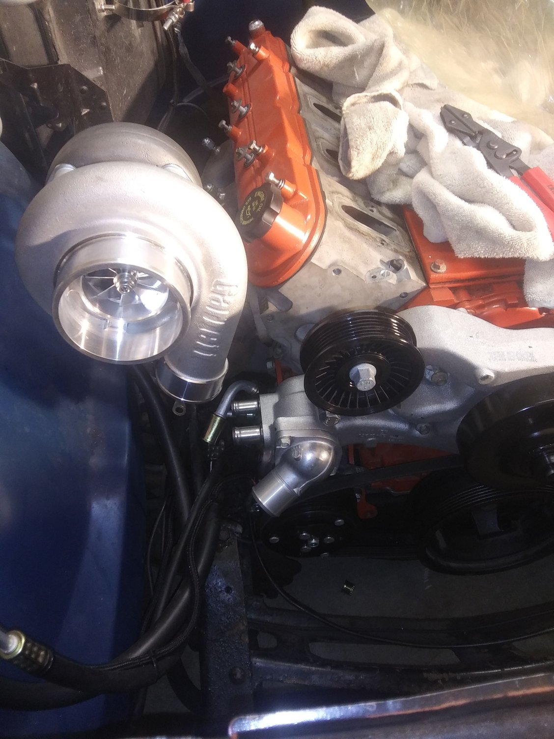

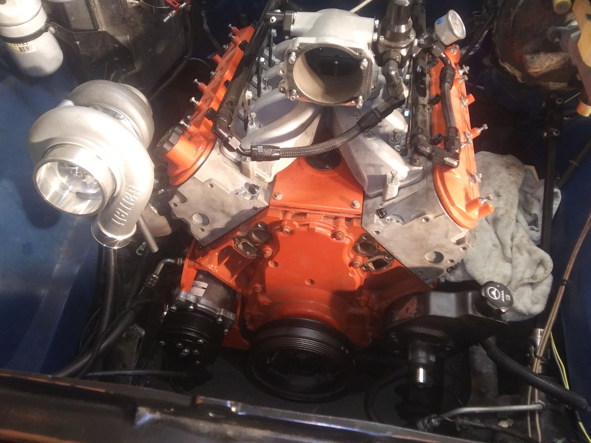

I'm doing twin 66 garretts in a 87 c10 with log style manifolds . I'm very tight on space with a/c . I don't want to run "soft" return oil drains because they will be about 1/2" from manifold . so is their a universal flex line ? Or any other idea ?
Passenger side mocking up hard lines

Just do exactly what you're already doing and every OEM does.
Simple steel pipe down past any harm areas, with a short connection of oil hose between it and the block section.
Doesnt get any easier, better flowing and more reliable.
Peoples fascination with using AN fittings for oil drains....is a little odd, when they're so bulky outside, yet they are so small diameter inside. Plus usually inconvenient compared to the simple options.
