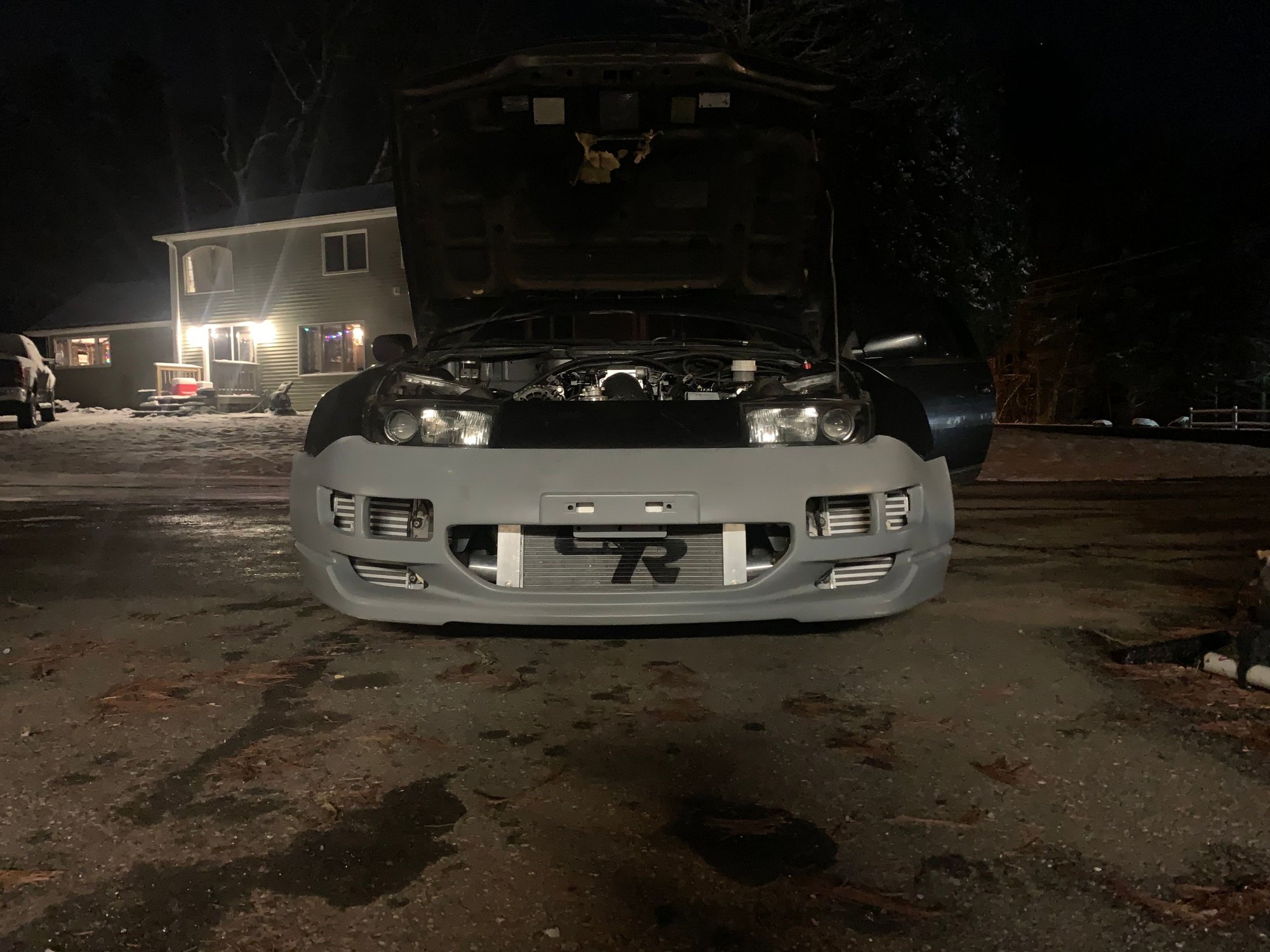

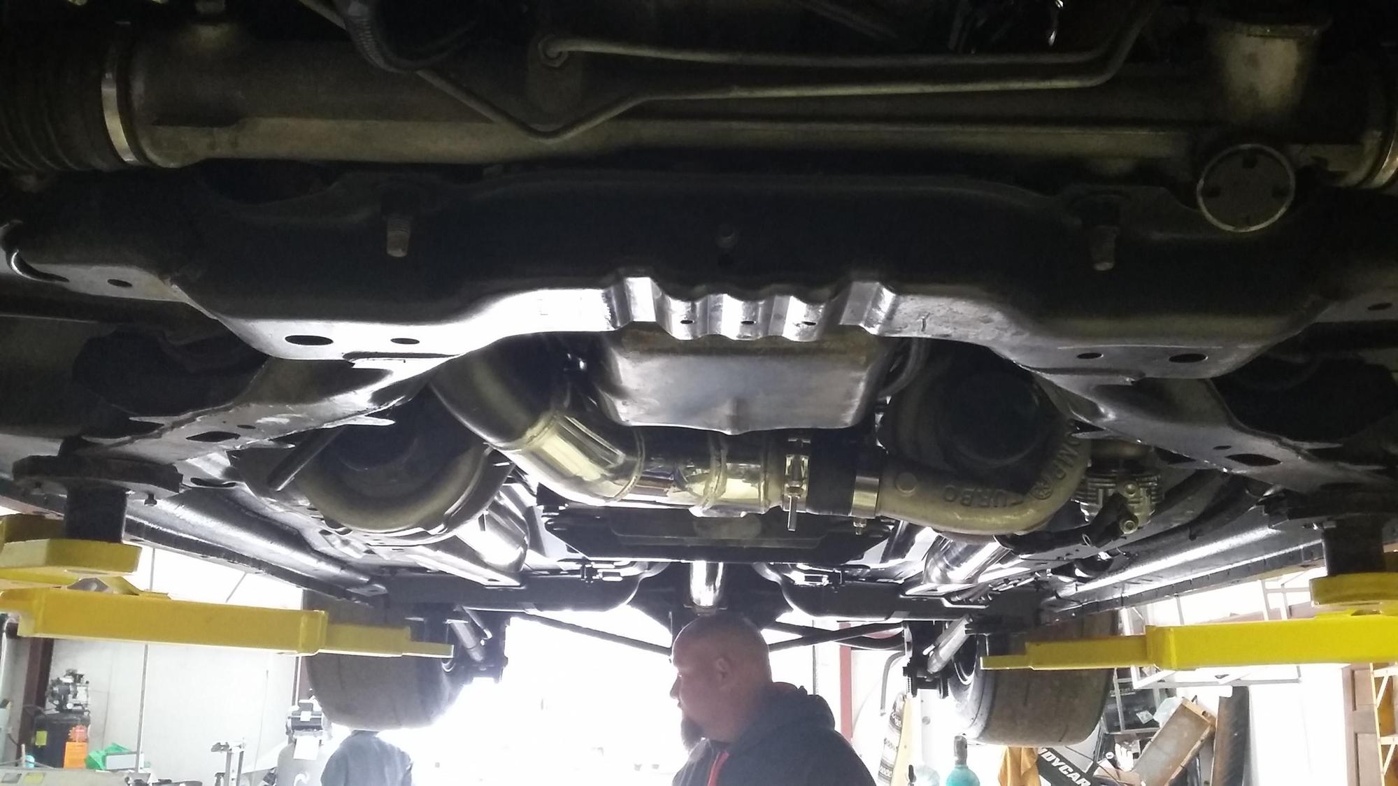

Anyone on here have any reviews with oil less turbos? Read some bad reviews about grease needing replacement often and need to send turbos out for this?
i have a 5.3 with gen3 rods. Twin gt35s (cxracing). I don’t wanna run e85 cause not close by at all. This leaves me to 14-16psi with about 5-600hp.
I always planned to build a block and just turn the boost up to make 800ish with meth and convert to AUTO, get Holley or some sort of ECU. Doing that would most likely be another $6000. So this leads me to thinking of selling this car at end of 2020, the way it sits on pump gas and just build another setup. I won’t get money back for the custom stuff that went into current setup. Easier to sell whole thing. Also I really enjoy designing and putting together setup without cutting shell.
this time I want the turbos to sit where my SMICs sits now. This is low obviously and debating if I could just run oil less turbos. not a fan of running pumps for turbo drains due to room. New setup would be 6.0, auto, bigger turbos to make 800ish on pump if possible. open downpipe right off turbos.
