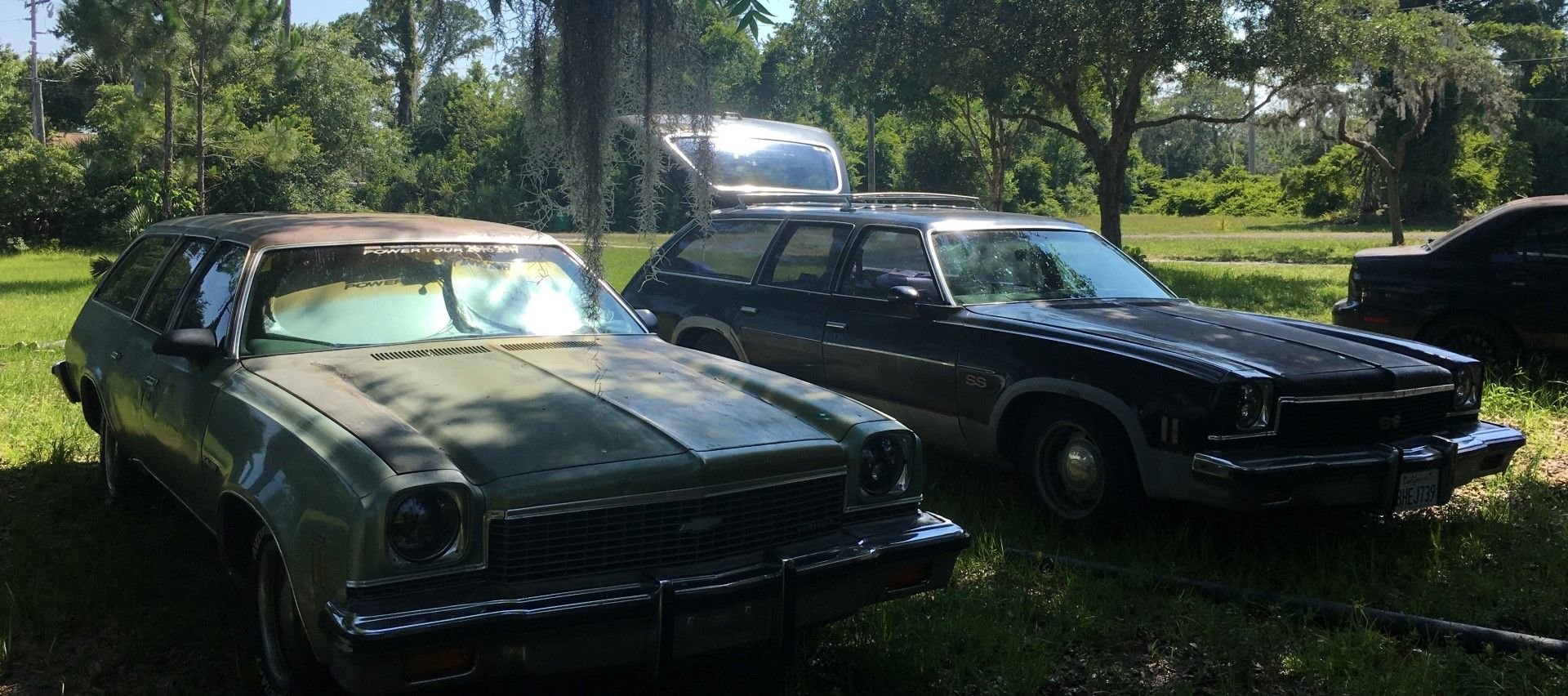

cool 73!
ive been looking for another clean 2 door for years.
heres mine and the old lady's
