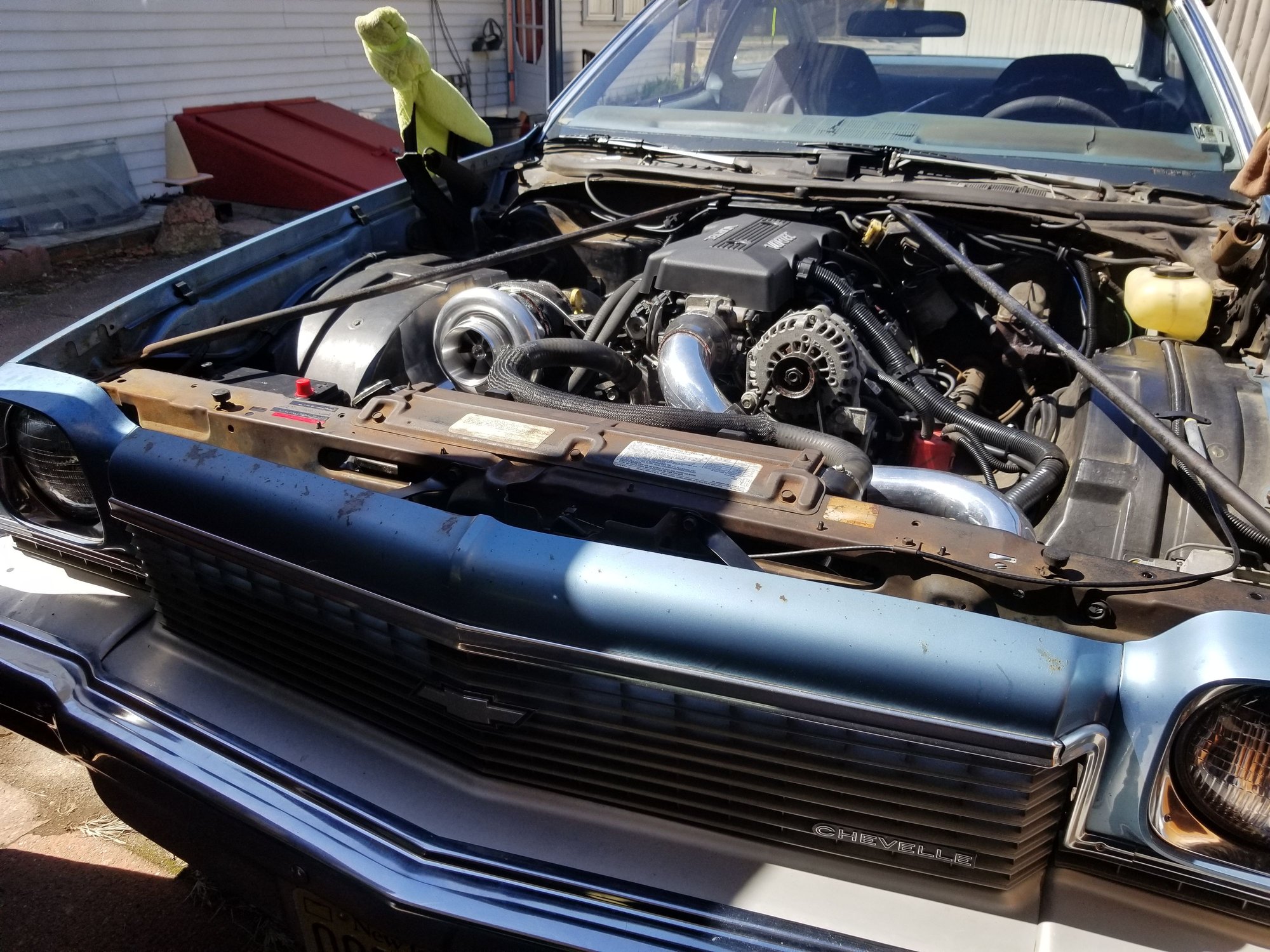

So my current setup is a gen3 4.8/4l80e, 220/224 cam, deka 80s, AEM400 pump, VsRacing 78/75 (cast not billet) on a log manifold, 93oct, no meth, 3.08 gears, 1973 Chevelle thats prob around 4,100lbs w/ me in it. Mostly for having fun on the street, and might take it to the track 3-4x a year.
So I just picked up a 06 Lq9 for a good deal that will be going in the car shortly with a BTR stg 2 turbo cam, and Im concerned that the 78/75 will be on the small side for the 6.0 and choke it out. Im not looking for 1k rwhp, but will be shooting for 7-750 eventually.
What Im wondering is if it would be worth it to swap the 78/75 to either the new VSracing gen2 78/75, or what Im really looking at is their new t4 billet 80/82 https://turbo4less.com/product/vsr-8...87x82-turbine/ but not sure if either would be a big enough step up from the cast 78/75 on the 6.0 to justify the money spent. Going to a t6 is not really an option at this point as the hot side is setup for the t4 and its already tight on space where it is now with the t4.
