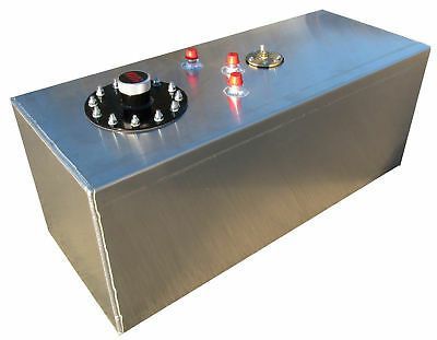

anyone on here run a flat bottom fuel cell and fuel injection? I have an 18 gallon aluminum cell in my nova but it is just open with a flat bottom how are you guys keeping the fuel inlet covered in breaking? foam? or should I just go stock sumped tank and be done. thanks

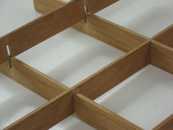

I don't have pictures of mine and my Son In-laws setups but the picture below is the same as what I did in ours but made out of aluminum strips that were 3" tall. You cut them the correct length and width, Then you cut half way through each side so they interlock together when assembled. You assemble them inside the fuel cell by removing the fuel cap assembly. I cut my strips on a table saw with a fine tooth blade. If you've never cut aluminum on a table saw be very careful, Go slow and do not stand inline with the material because if it binds it will want to kick it back at you. Definitely wear gloves and safety glasses.

thanks that baffeling idea might do the trick . thanks ill do some measuring

It definitely worked for us, My truck is around 580hp and setup pro touring style and I can run the tank down to about the 3 gallons on a 15 gallon cell and never had any pick up issues. My Son in-laws Nova has a 12 gallon cell and he's never mentioned any problems to me. AwesomeAuto's suggestion would also solve your problem.

the trouble with my tank is it is flat and will uncover the suction with hard breaking thinking about a sumpped stock tank and be happy. . not sure yet but I will look at baffeling in the flat one as well.

yes I think a little baffeling or foam will make it work fine from 1/2 tank and up. and it is an 18 gallon so it should work good enuff to drive above 1/2 tank.thanks. I might be worrying about the lack of a sump to much. lol

im going to try and build a sump area as to keep the pickup submerged better. I gravity feed two 380 pumps from -10 fitting at rear of tank. so if I can keep the fuel there during a hard stop im sure they are fine under acceleration. hell there fine under accel now.
