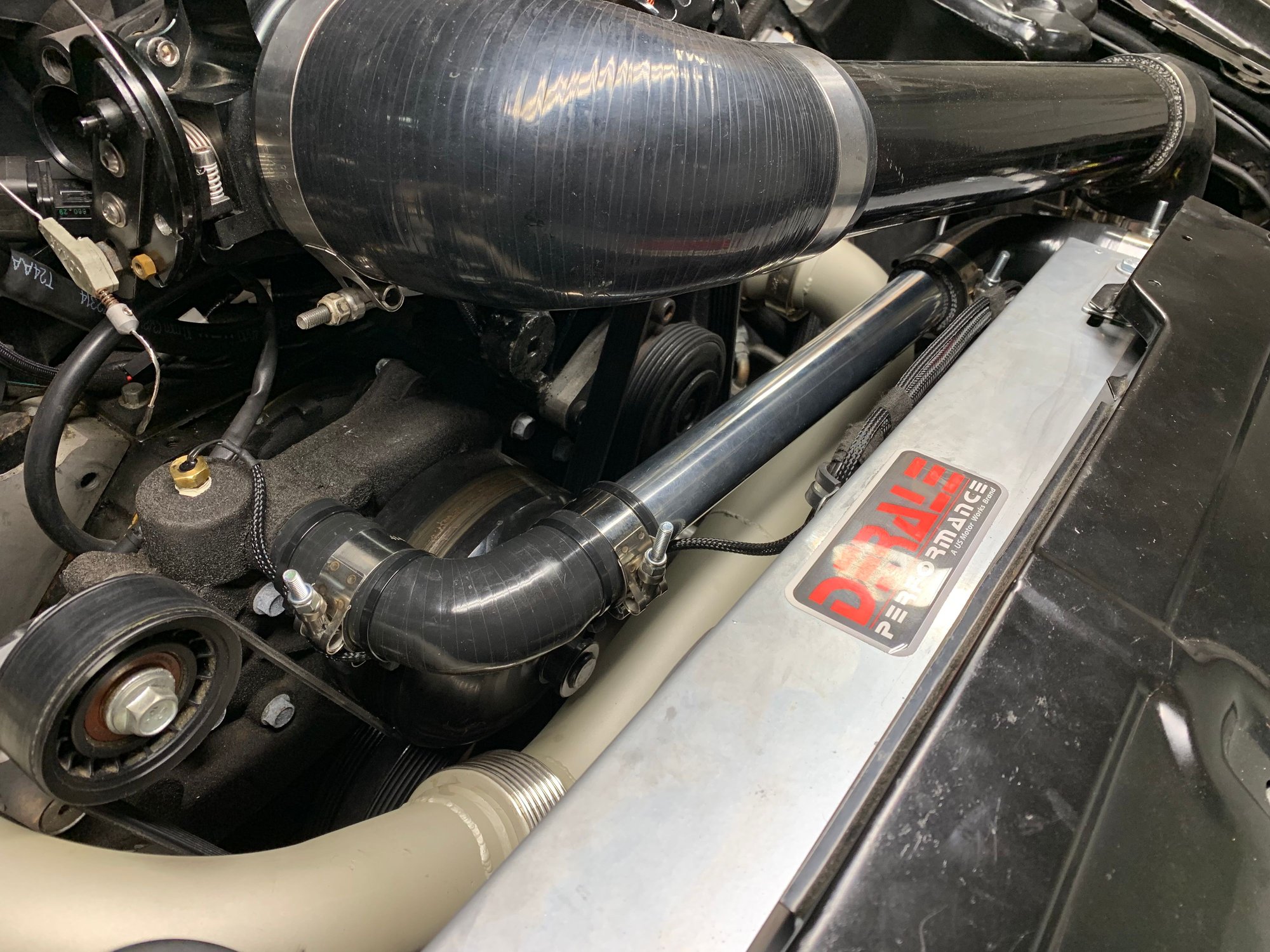

Vibrant bellow like pictured above in my crossover for a year and no issues pre turbo. I just added a no name braided with interlocking liner in the down pipe by my electric cutout as I’ve heard good things about them. The bellows are very flexible so it’s best to keep them relatively straight and in a straight section when things “grow” when they get hot. So make sure they aren’t flexing when they are installed, bc when they get hot things move more and in different directions. I also have a vibrant interlocking inner liner and braided outside style sitting on the shelf.
U can see the bellow in the crossover by the waterpump inlet
Braided with interlocking inner liner after the cutout.
