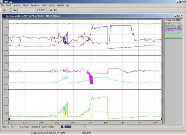

You hit 26 psi on the trans brake? Did it hook and change the rotation if the earth?
Spun... a little... Heres a 24.5 lb launch... Wheels up 1.33 60'. Nothing to write home about. Almost needed to leave on that kinda boost to get the thing moving. Had a 3.10 gear with a 29" slick. 8.2:1 compression and an LS9 cam. It basically needed a little help till 5k or so. Then it came on hard.

..... Almost needed to leave on that kinda boost to get the thing moving. Had a 3.10 gear with a 29" slick. 8.2:1 compression and an LS9 cam. It basically needed a little help till 5k or so. Then it came on hard.
LOL that makes a little more sense. That's a heck of a low SLR and compression, but that kind of boost will get it up and going haha.
