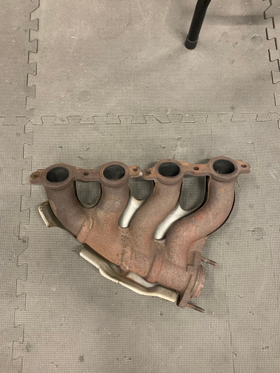

Here’s my passenger side manifold (had a spare one so I took a pic)
