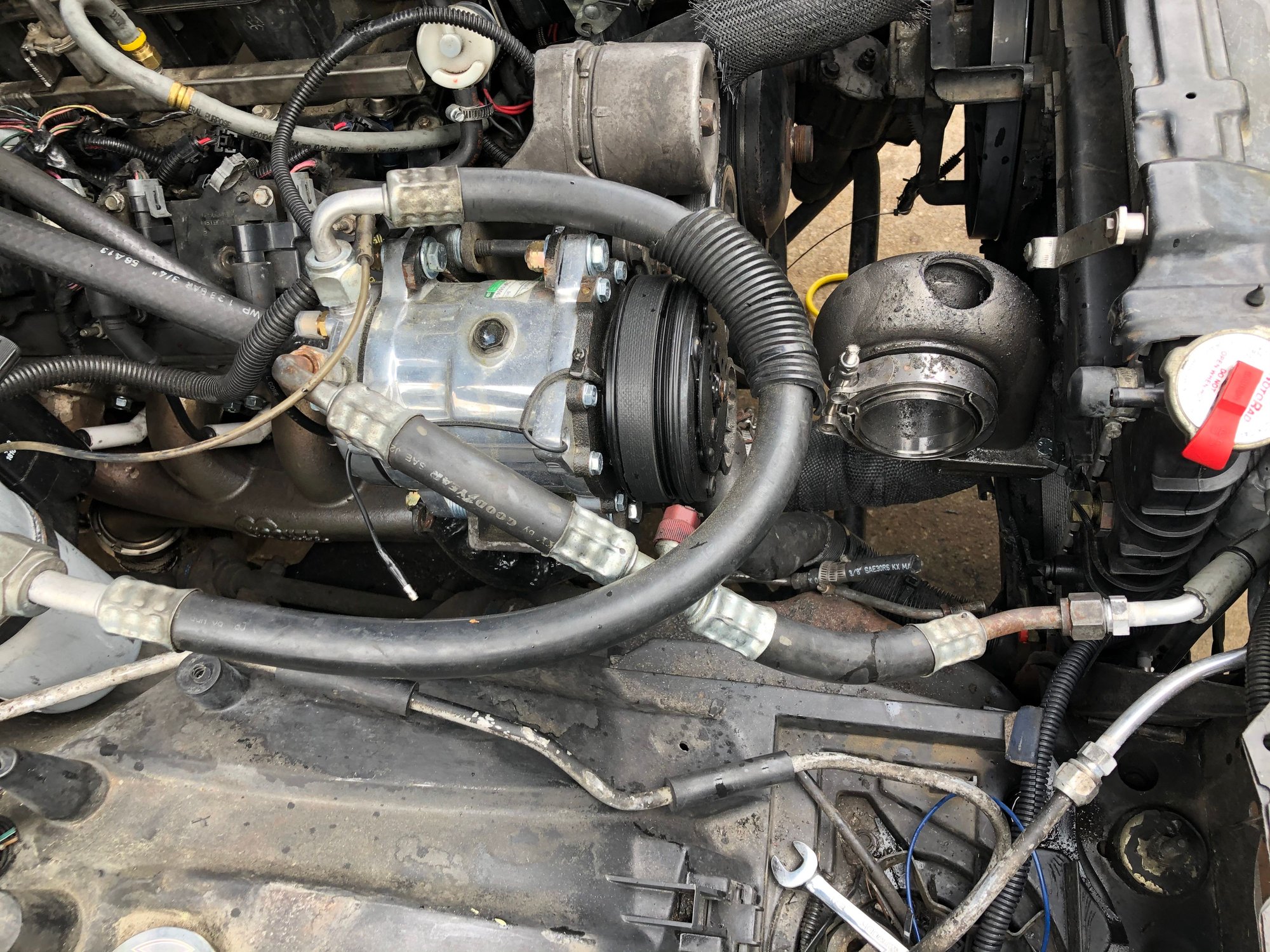

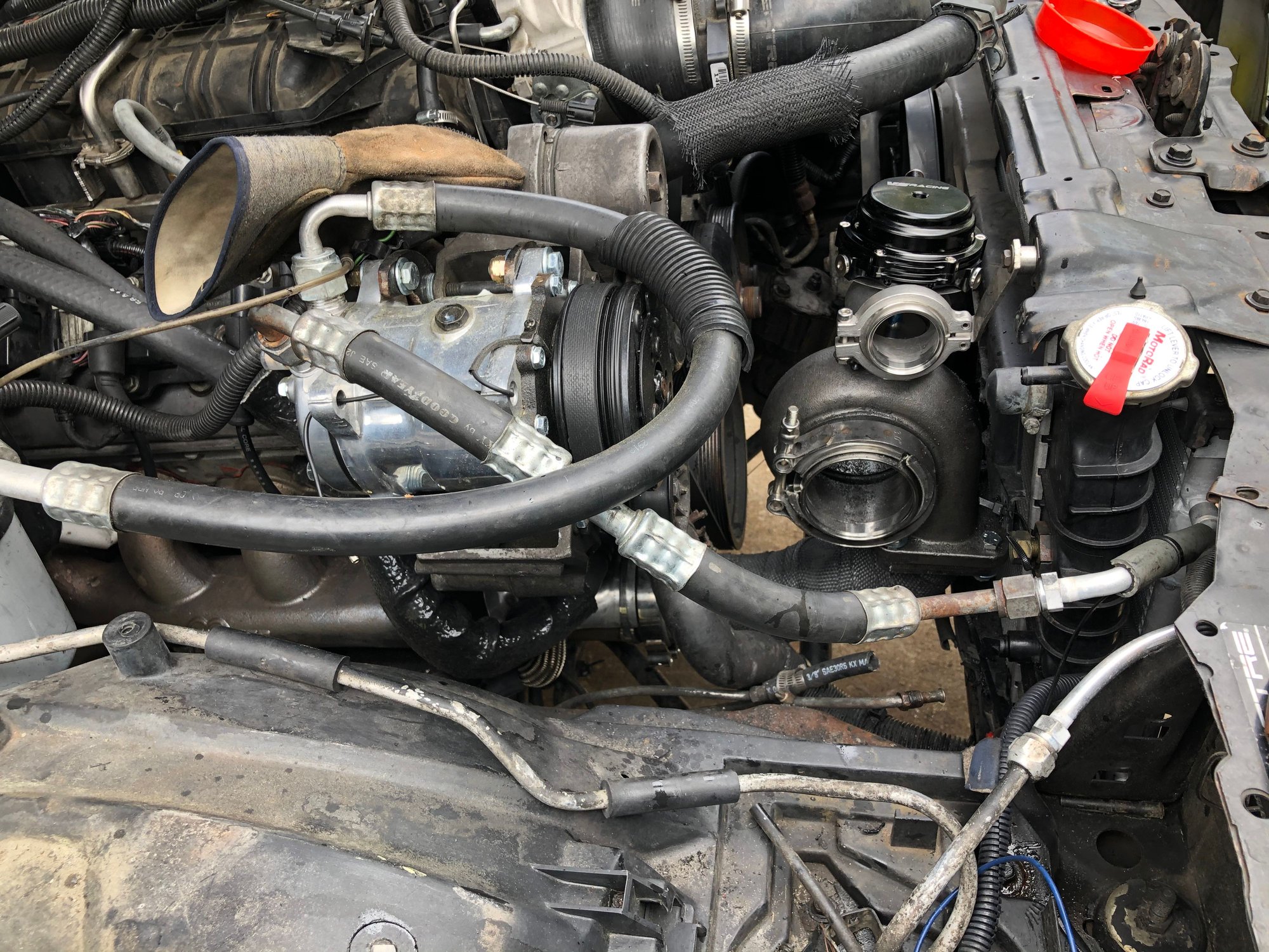

So I was trying to build a cheap stroker 408(it threw a rod). should’ve done this all along.
SBE lq9, ls3 heads, Btr dual springs, bushed rockers, and hardened push rods.
n/a (turbo) cam I was running in it. .635in .610ex 231/239@.50 112+2

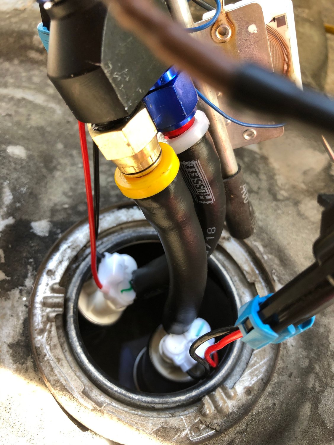

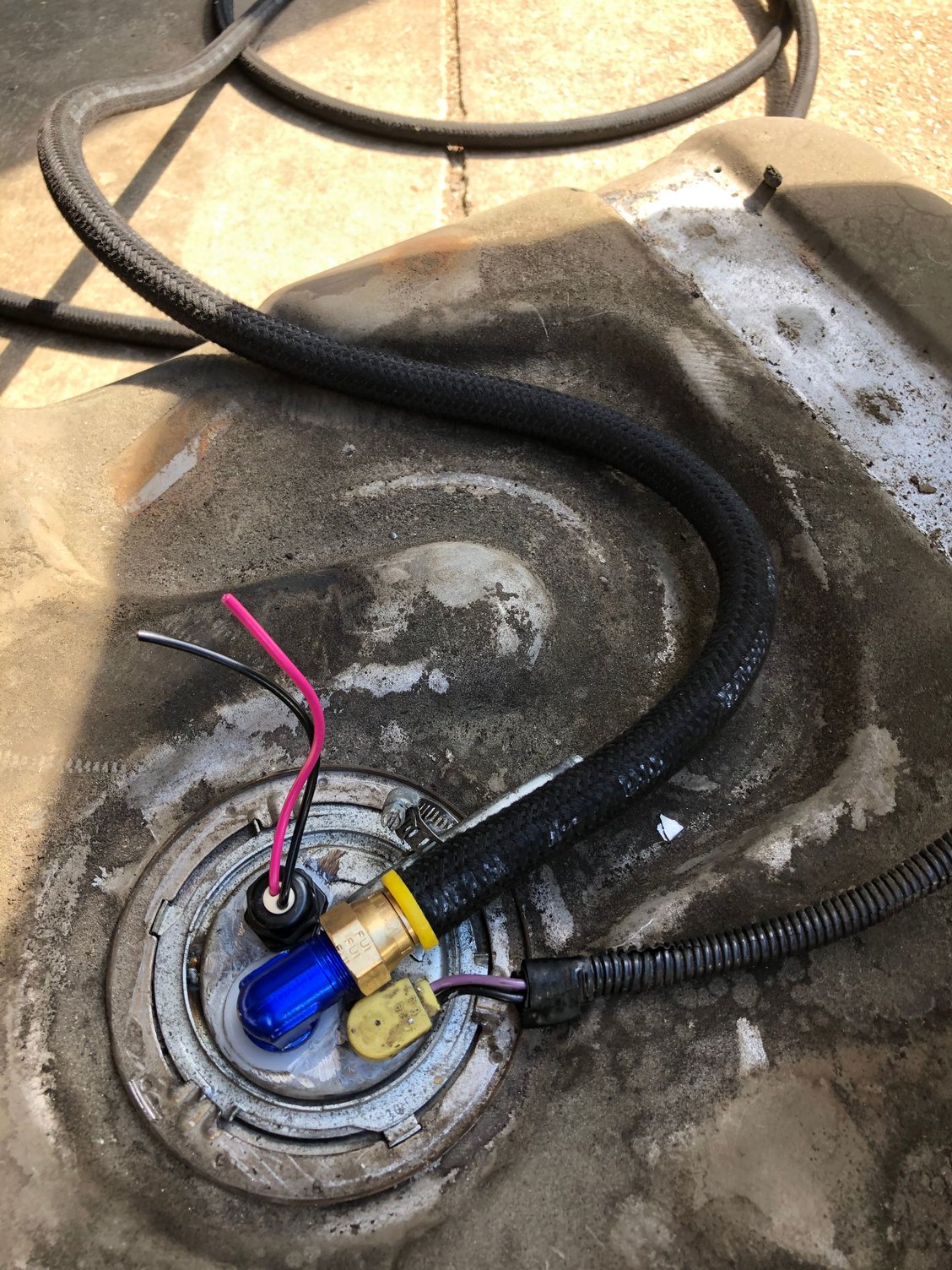

1/2 fuel line 3/8 return dual 450 walbro pumps.

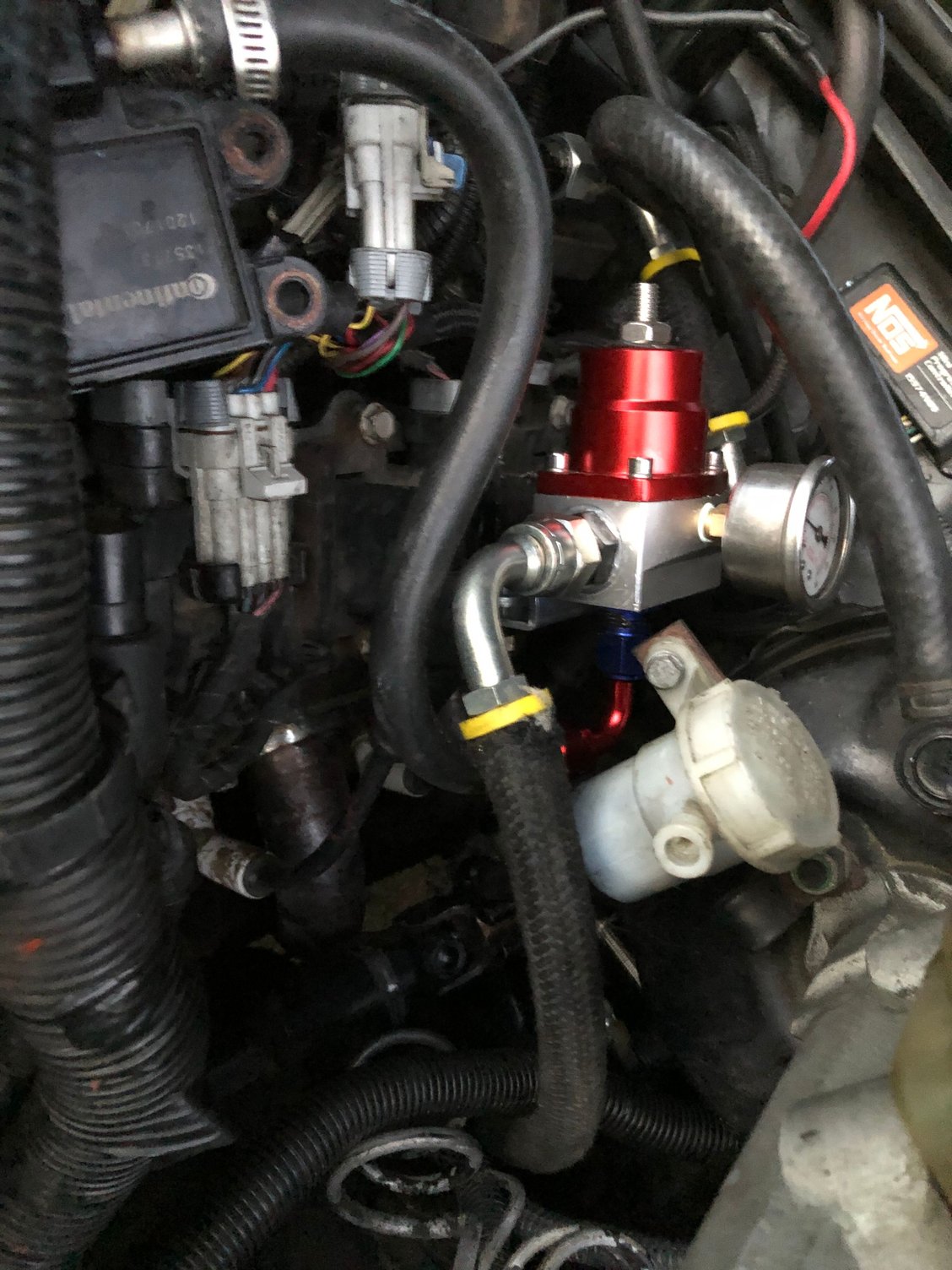

snakeater 80#’s
p59 flex 3bar ls9 map
denmah cast 7875 vs kit.
made 420 at wheels n/a. currently have 12# springs
Old Apr 9, 2020 | 10:27 PM
alexj01_83's Avatar
Joined: Mar 2014
Posts: 54
From: fayetteville n.c

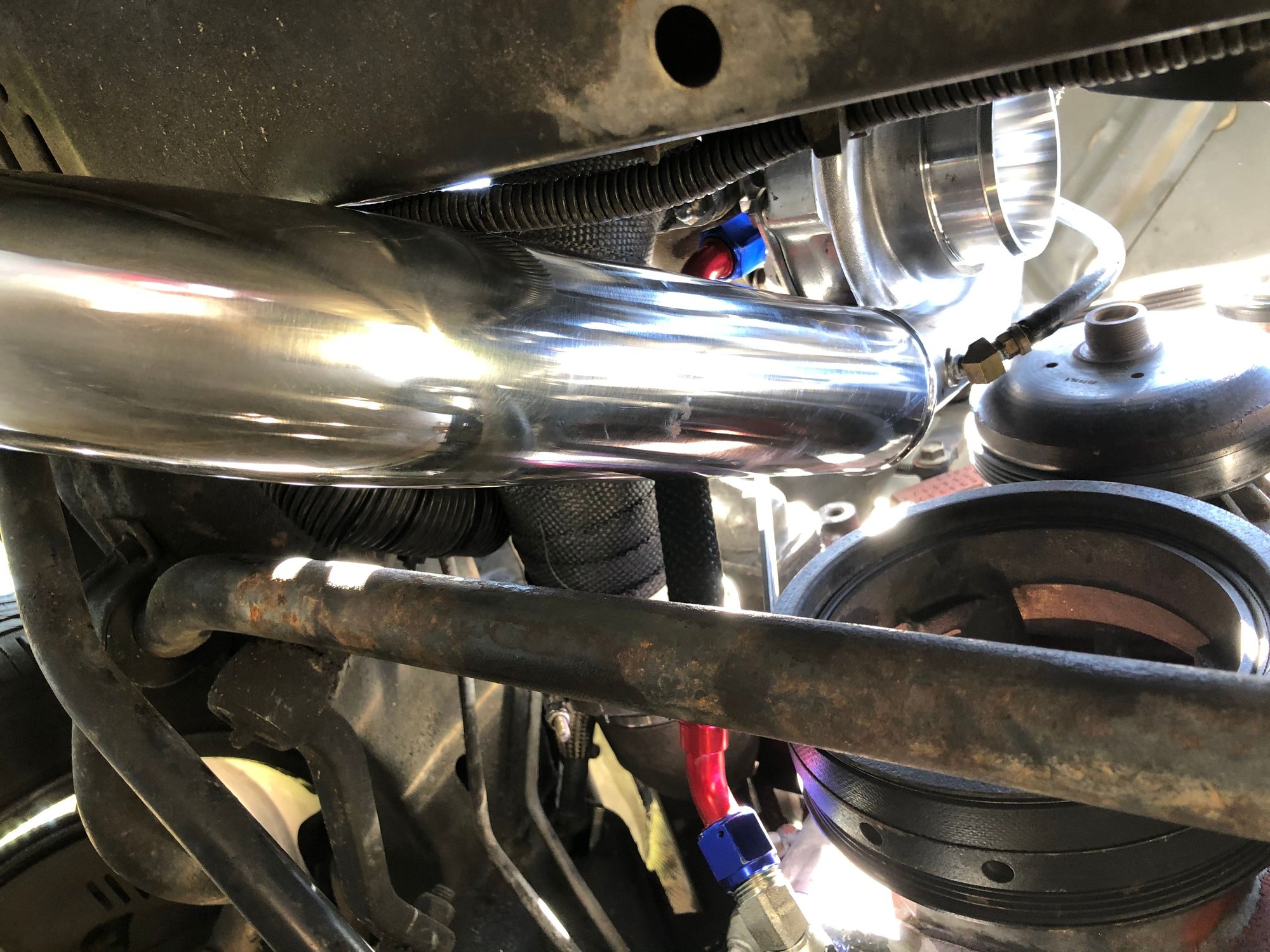

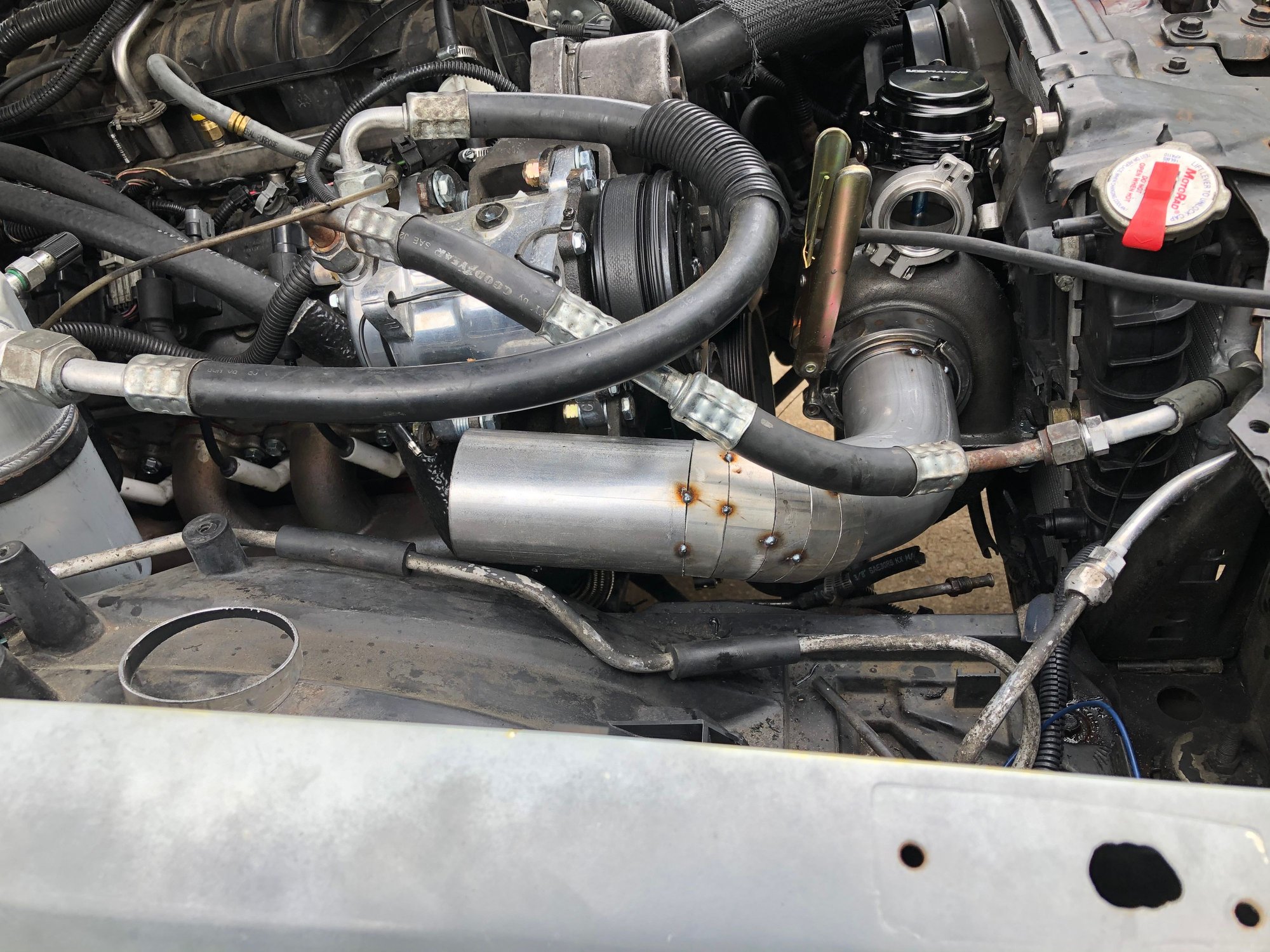

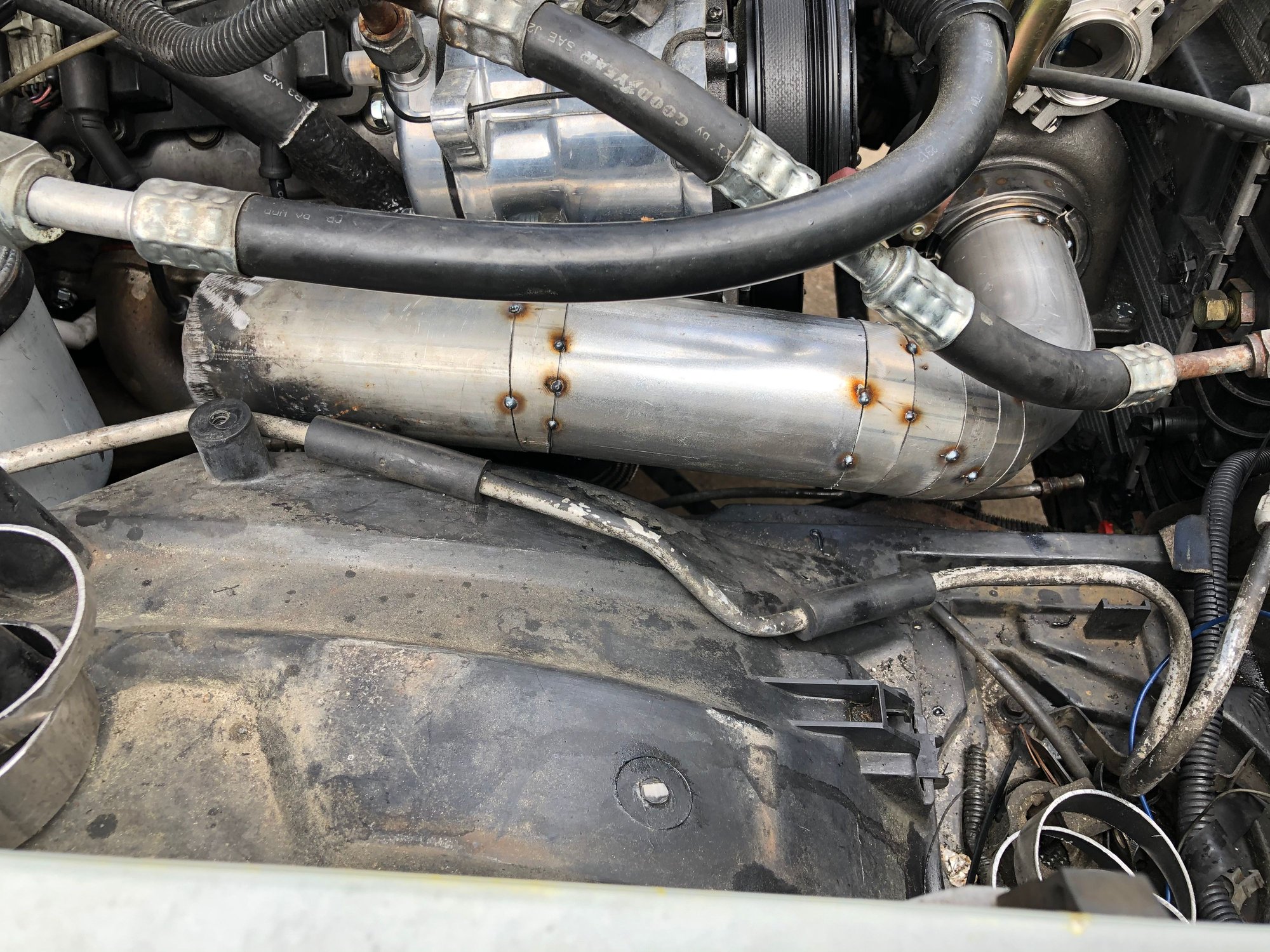

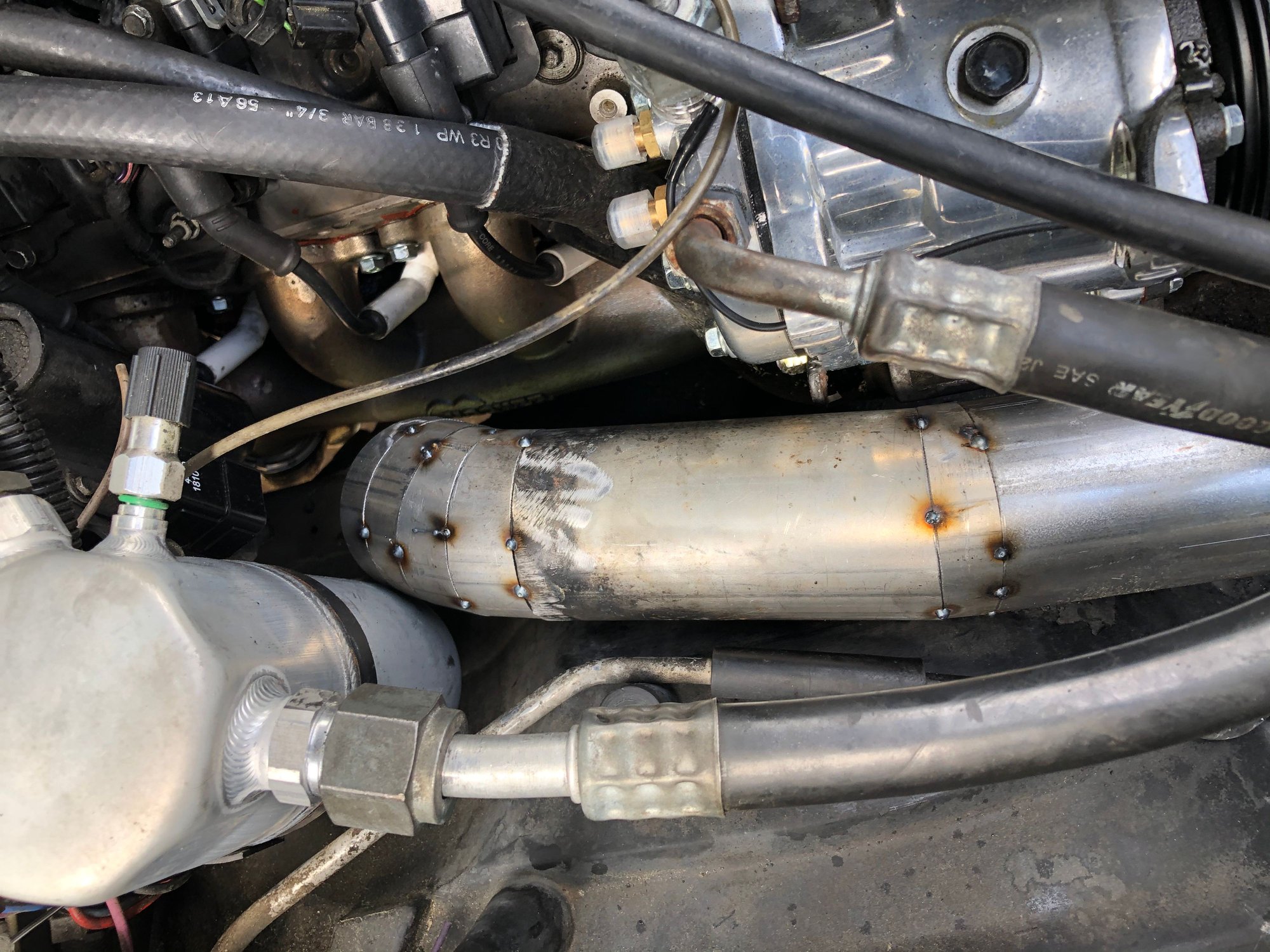

Built crossover pipe out of old truck exhaust.
Holley turbo manifold

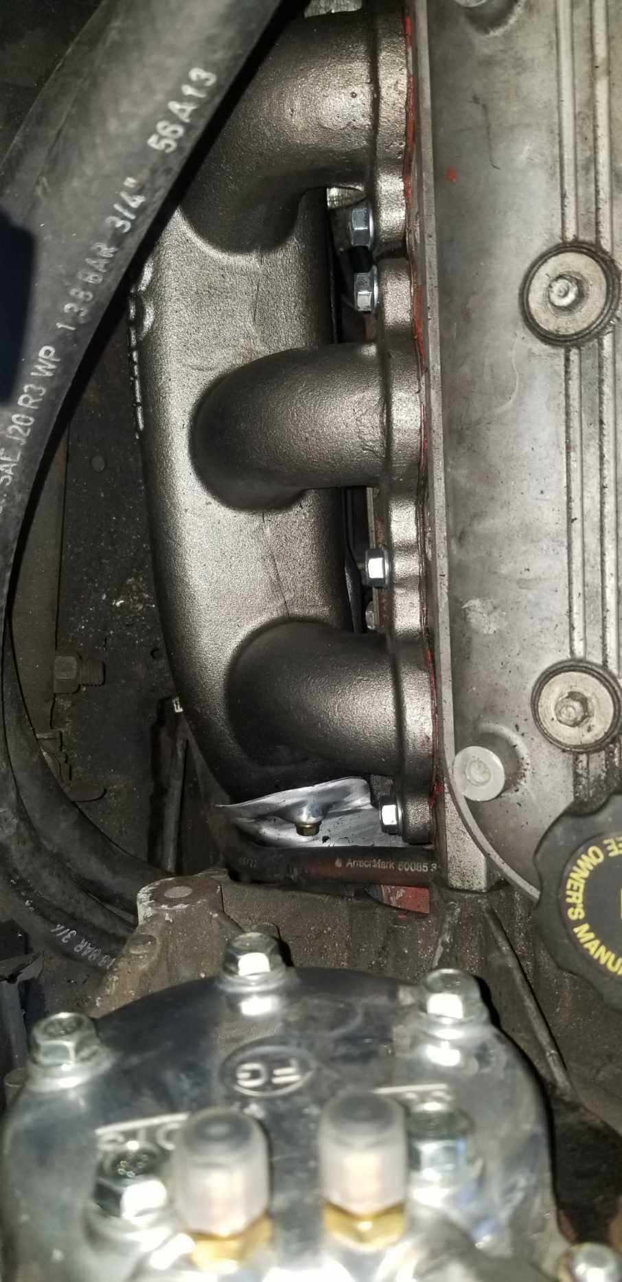

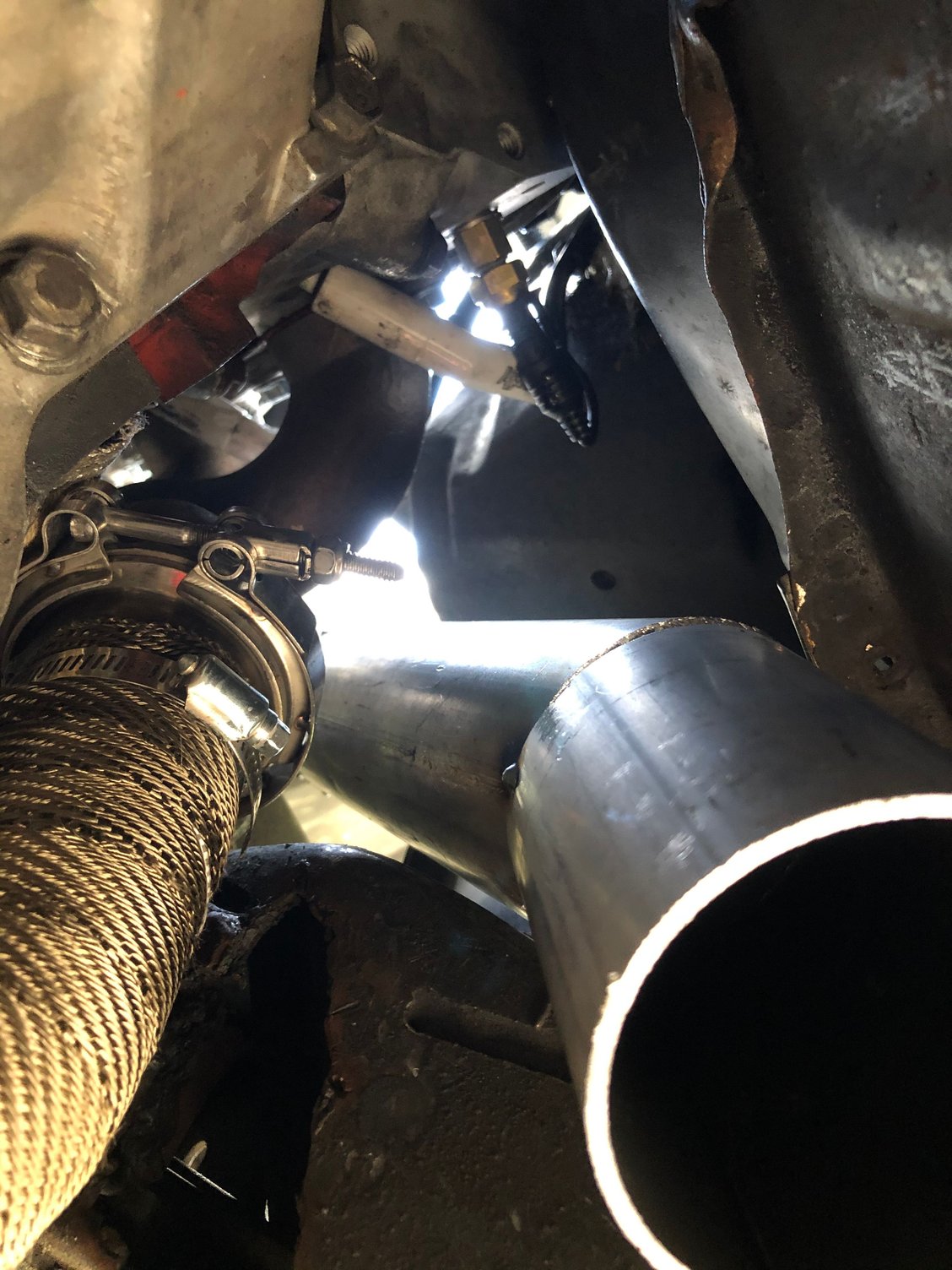

F body manifold on drivers side.
