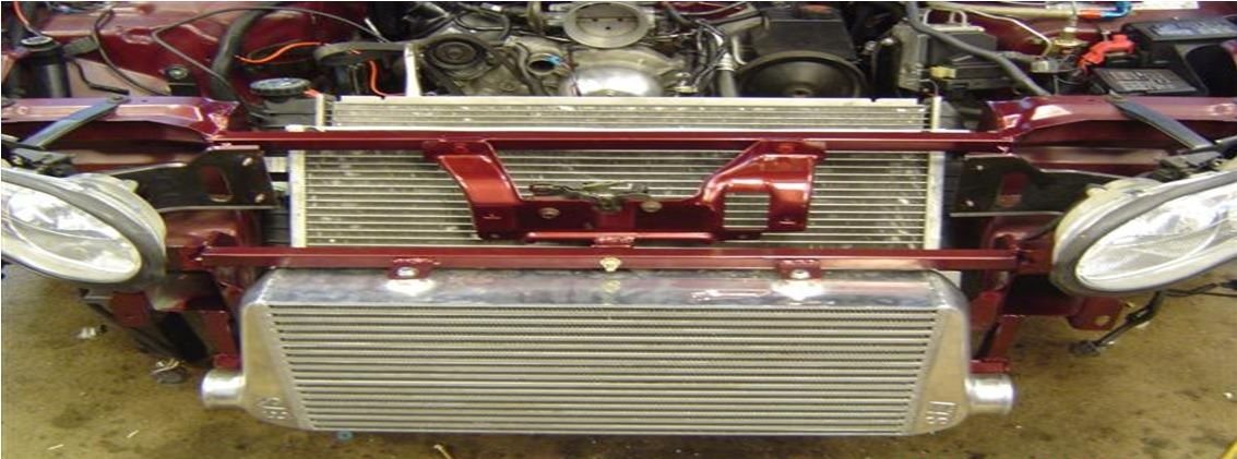

Mounting would be similar to:

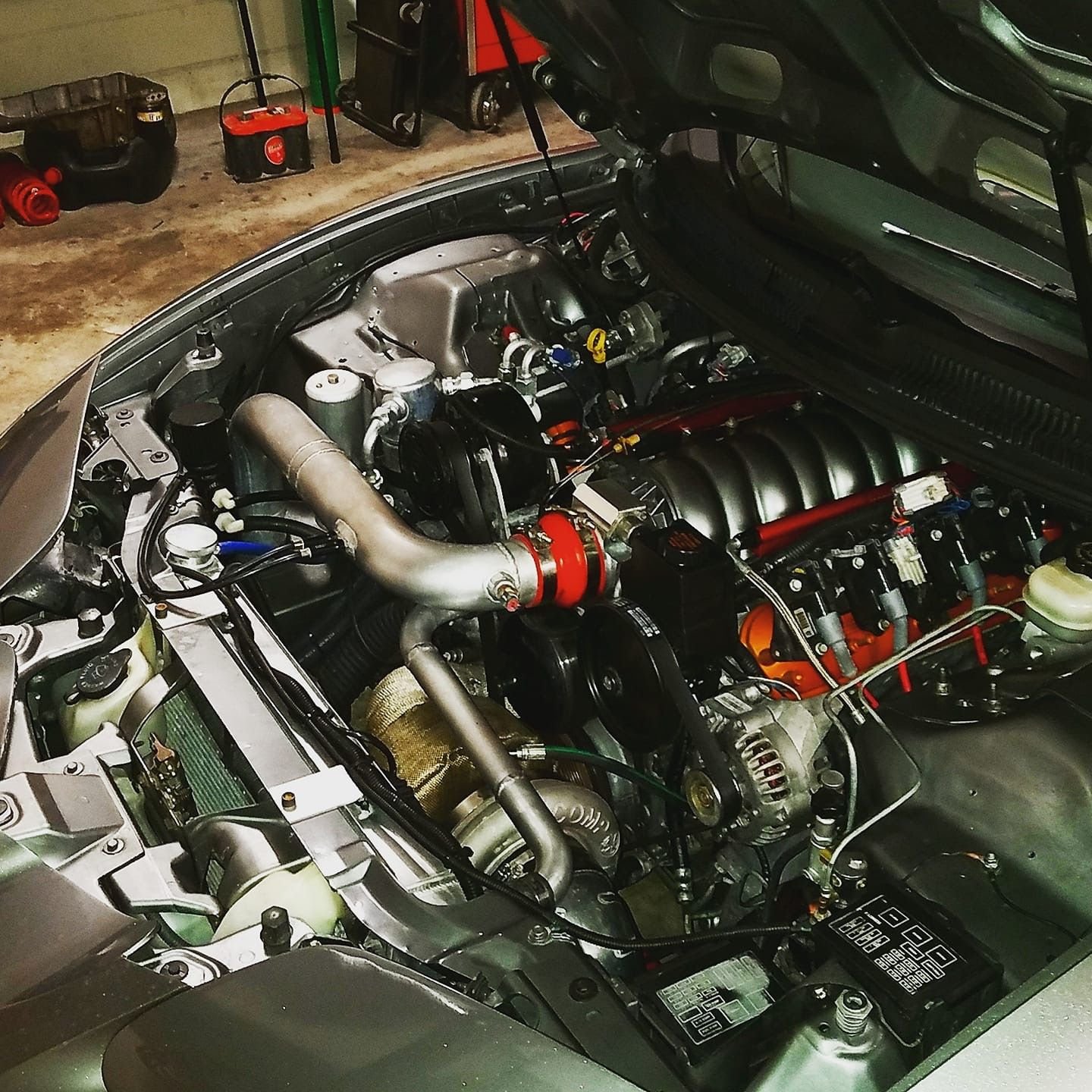

I haven’t been able to get much of an answer. I found this bracket and a guy using it on Facebook so I’m going to use it and run my down pipe on my s475 out the fender on a cutout and then run it to the back after reducing it to 3” for cruising around with stock k member.
https://lsbrackets.com/category/ac-b...4-ac-brackets/
here’s a pic of the guys setup using it.
