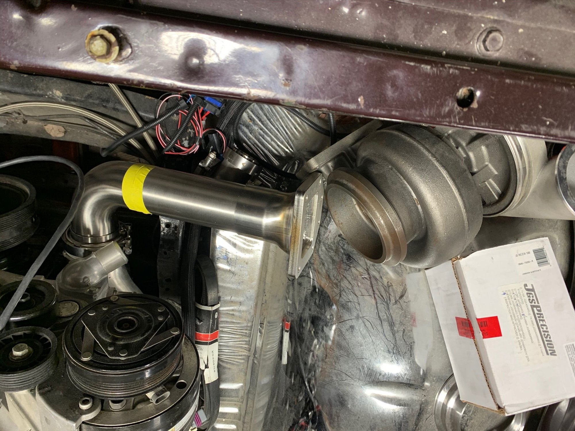

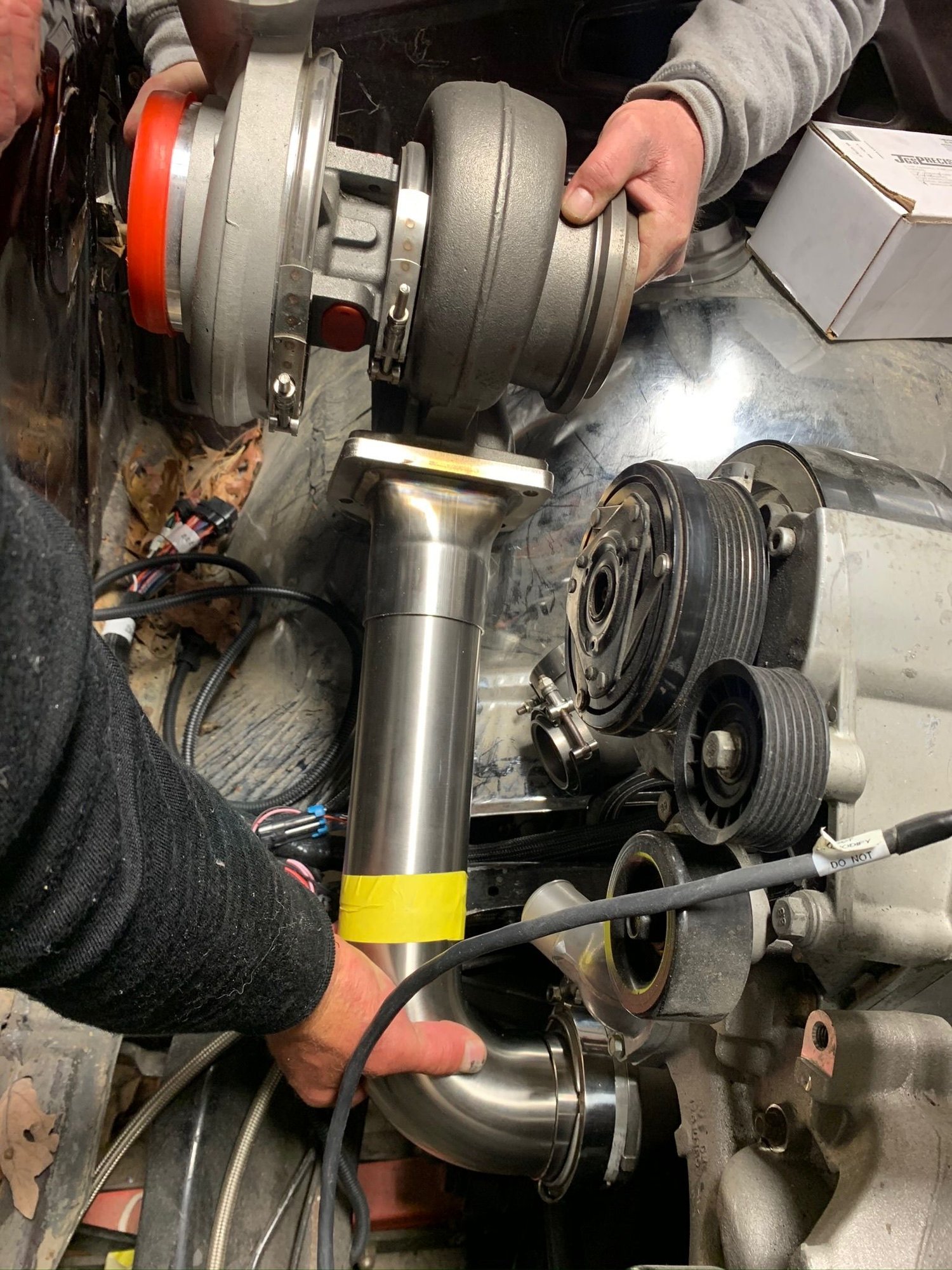

Ok so first turbo build . 80 c10 ,Forged 5.3/ s480 clone , Holley turbo manifolds etc.... trying to get the turbo connected . Really wish I had gone with a different manifold , but I’m into it now . Check out the pics and tell me what you think ? Where I’m planning on putting it , not a lot of room for the filter, but we are thinking of cutting a hole in the support , should give us 9-10 in . Also gotta fig out wastegate placement . 60mm gate is pretty big. Not sure if there is enough room to put it on the elbow like I wanted .

High passenger side? Looks like a reasonably good spot. You have room to route a downpipe?

thats a good spot. good options for oil drain. use a straight out the front water inlet/t stat cover

Thanks guys . I was waiting for someone to say, WTF are u doing? Lol. Now if I can fig out wastegate , I’ll be all set . Down pipe should be fine . I’m gonna trim inner fender and slip it under . Wanna put some kind of exhaust on it .

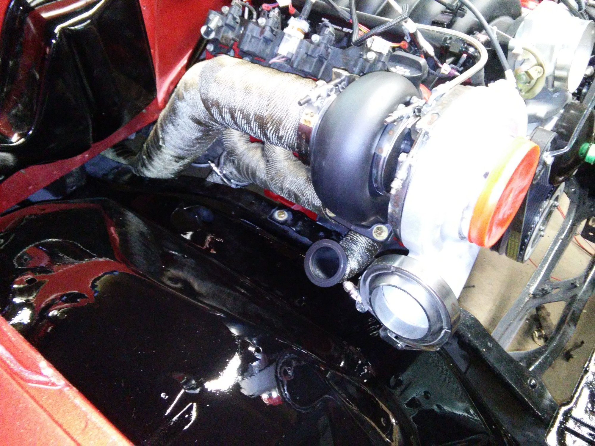

Well I bought a JGS 60mm gate . Using holley dominator so going to try to use on board air
To control boost with holley soliniods. Look an the pic , where should I put it ? Didn't seem to have enough room to go on the elbow .
a sharp 90* downwards right after the log should work really well

Ok cool . I was thinking it wouldn't work well not being right in the exhaust path etc... but I really don't need to control it to say 2-3psi

Are you planning on running it at that angle ? Pitched up ? That's the only thing I see could be an issue.

Well I'm going to clock it so the oil inlet is on top

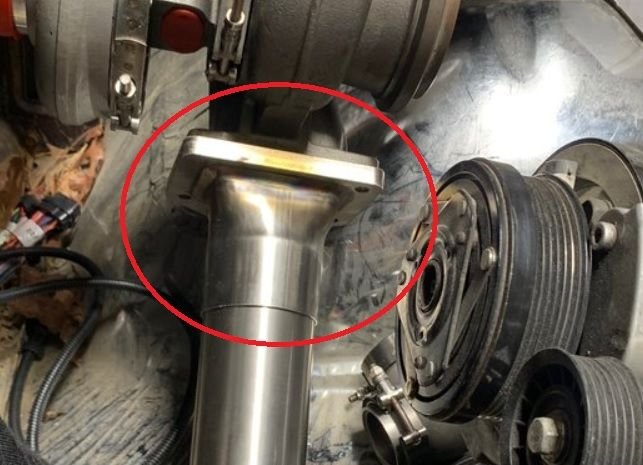

Where did you get this piece? Or did you fab it? Nice transition.

Monkey fab . Guy on here hooked me up with him . It's a slip fit .
