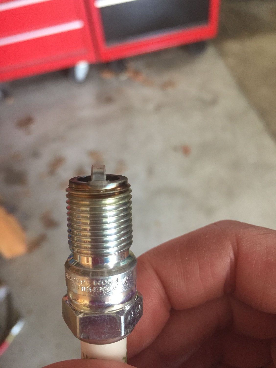

Much better. I'd probably pull 1 degree and leave it there.
even tho i didnt get to 6300 rpm and full boost, would i be better to do another? another degree would come off at that point, or take a degree off at the 5000 rpm point i get to??

I'd pull a degree from 4000 and up and run it to redline/max boost and reassess.
ok thanks will try, and take more pics

It's too hot for a street tune and pump gas IMO. You don't wan the heat into the 2nd thread at all and you don't want it into the bend. 1/4 to halfway down the strap is about perfect IMO. If you had super consistent RACE fuel in it, that's about a "perfect" max power heat range for a max effort setup. Is that a 7 plug? May get some resisted boots and try an 8 heat range as well. Or go the expensive route and run A TR8IX. (at about 9$ a plug though it's not a great route for tuning) I'd try 11* with the the BR7's and get another read. If it looks good swap out to the TR8IX's or run a resistor boot and the cheap "8" Heat range plug. I tune on the 7's with 1/8th mile pulls, then drop in the resisted 8 iridium plugs when done and do 1/4 pulls at the track.

I’d pull a degree out of that as well on pump gas. Don’t push pump gas in a street car to the limit. Personally I’d keep the br7ef and just take out a little timing.

Ok guys, will try that, less timing, then take some more pics, thanks
