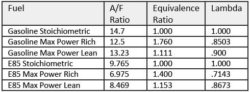

The prefect AFR for your combo will be the one that nets the most power... as with anything, it varies... But for the most part it isn't going to vary much. On a gas scale you don't want anything below 11.3 IMO, and even that is out of the peak power window by quite a bit. Too much fuel isn't a good thing. even 11.3 is over a full point out of the peak rich power window. Strictly using the extra fuel to help with cooling. Much more than that and you can cause detonation VS prevent it. If you see detonation at 11.3:1 and not at 10.8:1 your timing is to advanced. Over advancing timing to compensate for an overly rich mixture is just bad tuning. a little water/meth inj goes a long way and its dirt cheap w/ easy installation. I'd just buy the parts though. Most basic "kits" are overpriced IMO. Shouldn't cost you more than $150.

A lot depends on the fuel used and the consistency of that fuel. Pump gas has a smaller window for peak power AFR's than say E85. So smaller changes in AFR will make more noticeable power gains. Something like E85 and you may see a 1-2% power difference going from 10.8 to 12.5. While on pump or race gas you may see 5-6% differences. There is no magic rule or number unfortunately. The engines VE, head design, bore, piston speed,compression, valve events, inlet temps/density and a hundred other things all play a big role. Its not a matter of power lost or gained with a turbo car in most cases. You aren't talking big power numbers relative to another lb of boost. Its about being as far away from the knock threshold as possible... being "safe". 12.5 may net you 15 more hp at the crank than 11.5. But you may be right on the edge of detonation, so it's not worth it...Better off to be rich and retarded as they say, lol. Then throw another lb of boost at it.
You can only go so rich with pump fuel before you do more harm than good. In my 91/93 pump gas experience 11.3:1 was that number on multiple engine setups I shot for based on knock sensor feed back. Also I noticed teh lower the compression, the less efficient the engine was and the more fuel it wanted. I would hit my best trap speeds at 10.8:1 on my 7.8:1 383. Yet my much more efficient 2.0 liter with a 4 valve head liked 12.5:1. (e85) and 34psi. WHich if you read on those forums is the "go to" AFR target for e85 on a baby motor.
