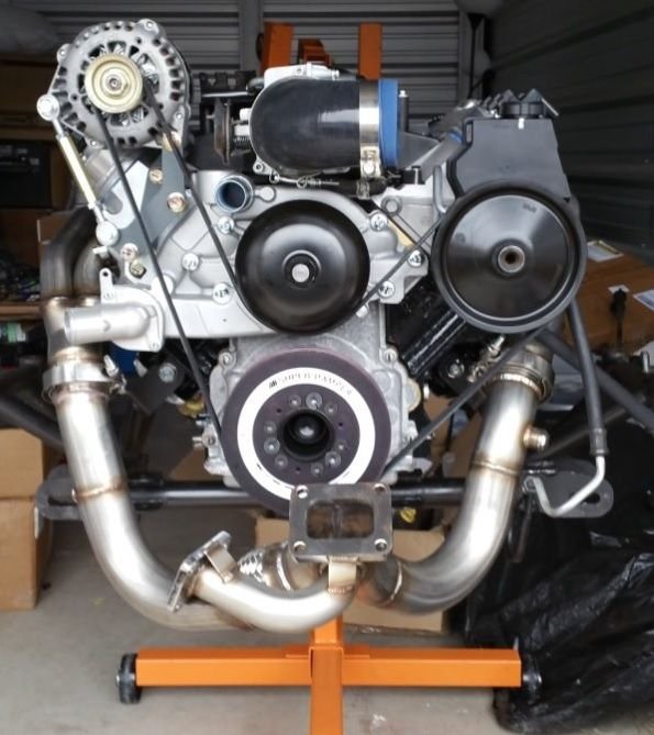

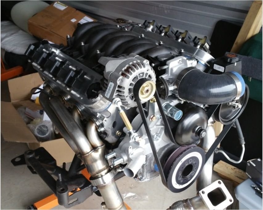

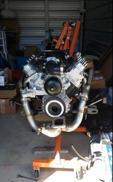

I used CXRacing for my PT7675 turbo. Decent quality, good welds. Plug access is a little nettlesome on certain plugs, Had to use Taylor cut to fit 135 degree plug wires. No leaks after initial install. No burnt plug wires, Came with two tubular headers, merge, downpipe, clamps, etc. The only thing was it had a funky unorthodox wastegate flange. (4 bolt rectangle). I just centered my two bolt Turbosmart flange on it , drilled two holes thru the flange, bolted it on. Ran great from 2015 till I went twins recently.
I paid about $500.xx for the whole kit at the time. I think it's a bit more expensive now though. I would definitely recommend to first timers.
