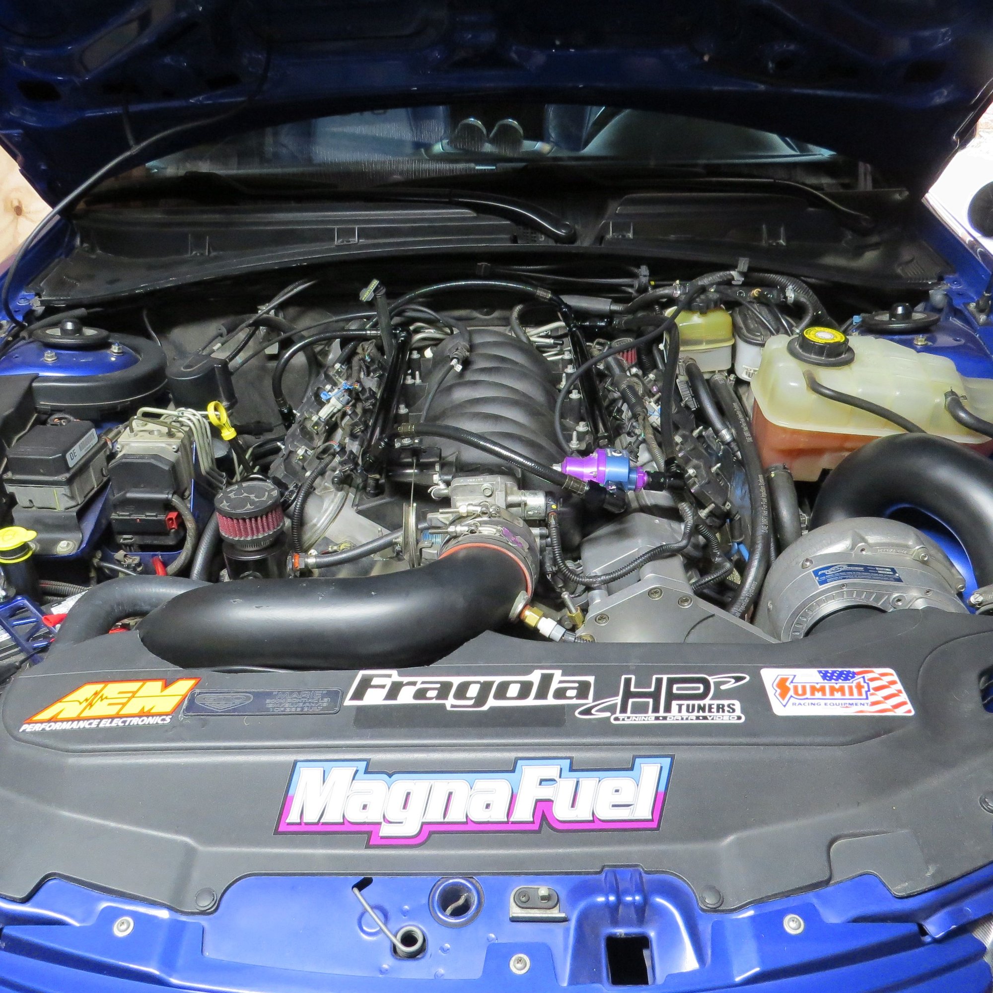

An F1a-94 head unit can be had new for a little over 3g. Then I could probably get a decent price out of my low mileage D1x to offset at least a 1/3 of that considering it is the newest model and a nice upgrade of a D1sc. Looking at heads if going that route I'd do aftermarket castings so TSP seems to have the most budget option there which is near $1800. Then of course new gaskets, possibly new pushrods, and intake/throttle body combos are usually over $1000. Then possibly build or modify my intake pipe from the procharger kit to fit the new intake/throttle body. Meanwhile an F1a-94 is a direct bolt in for me with the exception of the intake side of the blower being larger. So I would just ditch the crappy 180 degree turn procharger intake and put a blower guard on it.
...and like was mentioned make more than the short block can likely handle. Most think an LS3 aluminum block is safe to 1000 rwhp, but not much more long term.
I would like to emphasize that my current combo has completely lived up to my expectations. Actually beyond my expectations. Initially when the tune was getting close on the street it was the most power of I've personally owned in a true street car. After a couple months playing with it and getting better suspension/tires under it I'm interested in pushing forward on the power levels. The head unit seems to be the easiest and similar in cost if not cheaper than a new top end. I wouldn't even have to push the F1a-94 to make more than I am now so it would leave room to grow if I decide to stay procharger down the road with a better motor.

Car is a GTO so the only thing required to change the head unit to an F1a-94 is to remove belt, unbolt head unit from mount, disconnect clamp on intake and exhaust sides of head unit, put new head unit in with reverse process. The intake on the F1a-94 is bigger than the D1x so it would require a different intake tube or blower guard.

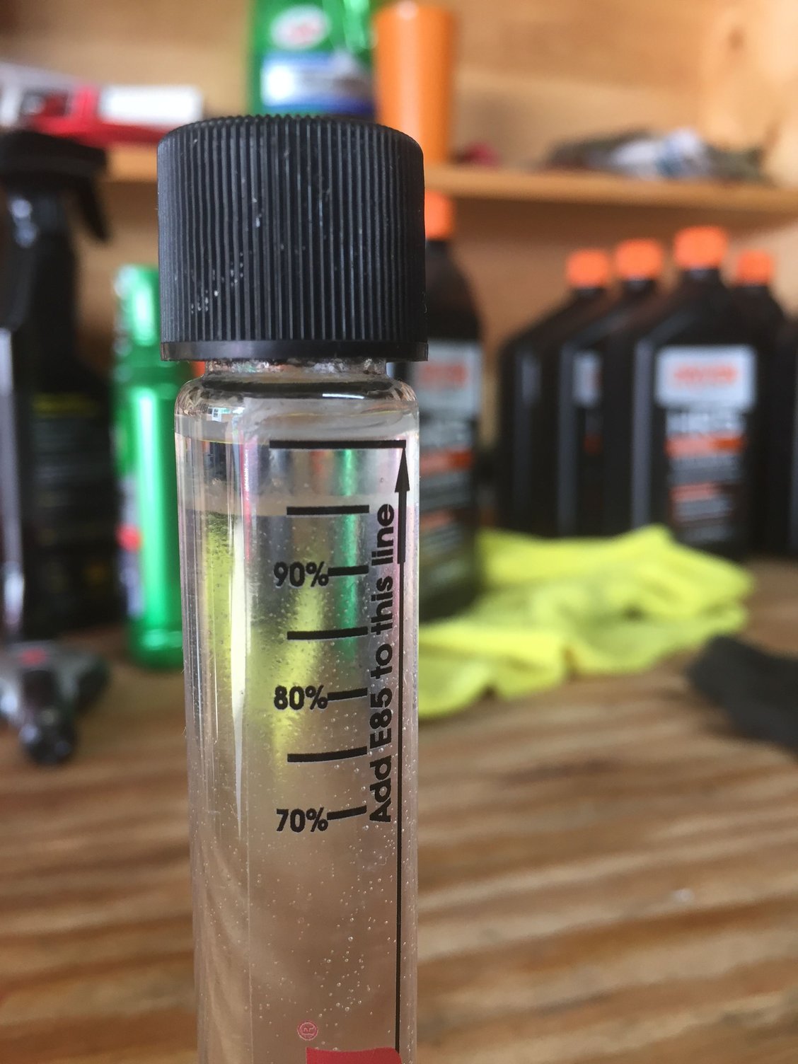

Running ethanol of some form in all my toys. I've run as high as E98 and saw no gains over E70 at the track in the RX7. So E70 is all I run in it now. "E85" Pumps are at a steady 70% at the sketchy "Petro America" station year round. Lower blends also seems to gum injectors less. E50-60 has zero issues with the "Ethanol goo" in my experience and also seems to provide all the knock suppression I need to run 20lbs on a non intercooled twin turbo 5.3 mustang. (that's with whatever crap blend fuel they use) I'd bet that E95 you got there mixed with ethanol free 91-93 octane at 50% eth. would be MORE Than enough fuel/octane for anything you'll throw at it with that blower. (or the new one)
I do use E98 on my air-cooled minibike! lol... seems to run cooler. Have to drain the carb after every use and plug the tank/carb vents or I get GEL/GOO in the carb. fast. Guess I'm just saying higher blends can be a pain and I don't see the benefit, at my power levels anyway...
Old Jun 22, 2020 | 10:54 AM
  #34
BCNUL8R's Avatar
Joined: Jun 2005
Posts: 2,265
Likes: 671
From: Oskaloosa, Iowa
Yep I use 93 pump and drop it down to 50 percent. So far it seems to have eliminated the filter plugging I was having with my Magnafuel post pump filter.
I still like the higher alcohol content from the pump so I can dilute it with 93 instead of the 87 they use.

I had the head unit off to change the oil and decided to bump it up a hair by changing the pulley from the 3.9 to the 3.85. Not much of a change and barely needed any adjustment to the VE table to get fueling where I wanted it. I've got it running 11.3 to 11.5 on the gas scale, but dropping down to 10.9 once it reaches 14 lbs. I'm on a 2 bar map and richen that last couple rows of the VE table a little bit in case it maxes out my 2 bar. It's in the 90's now so I suspect in cooler weather it will max out the map sensor.
