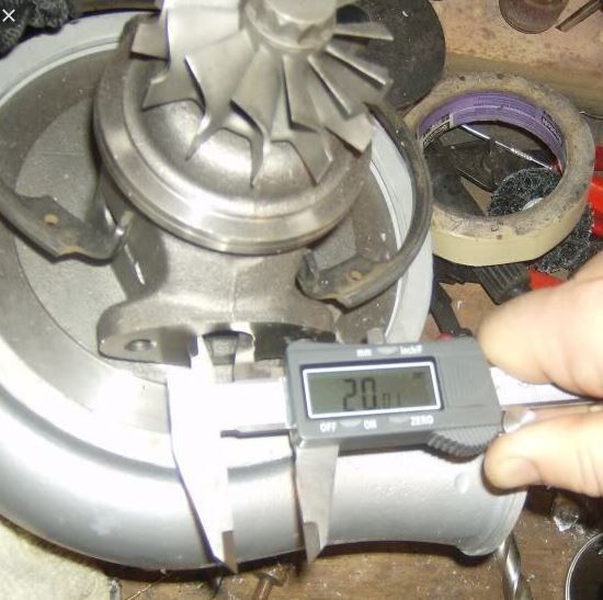

Measure the diameter of the drain hole on the turbo. Your drain should be that ID at minimum the entire run. The more bends and the poorer the drain angle, the larger the drain should be.
For example... If you have a 20mm drain, -10 or even a -12 isn't going to cut it.

thanks to all .i have narrowed it down to drain . remove hose -10 measured only 1/2 inch. .BUT here is the problem the- 10an to npt threaded to oil pan . Only measured 1/2 on on the -10 side and tampered down to 3/8 on npt side . i removed it and drilled it out to 1/2 . started truck up 90% better . so i am redoing the drain 3/4 all the way .
