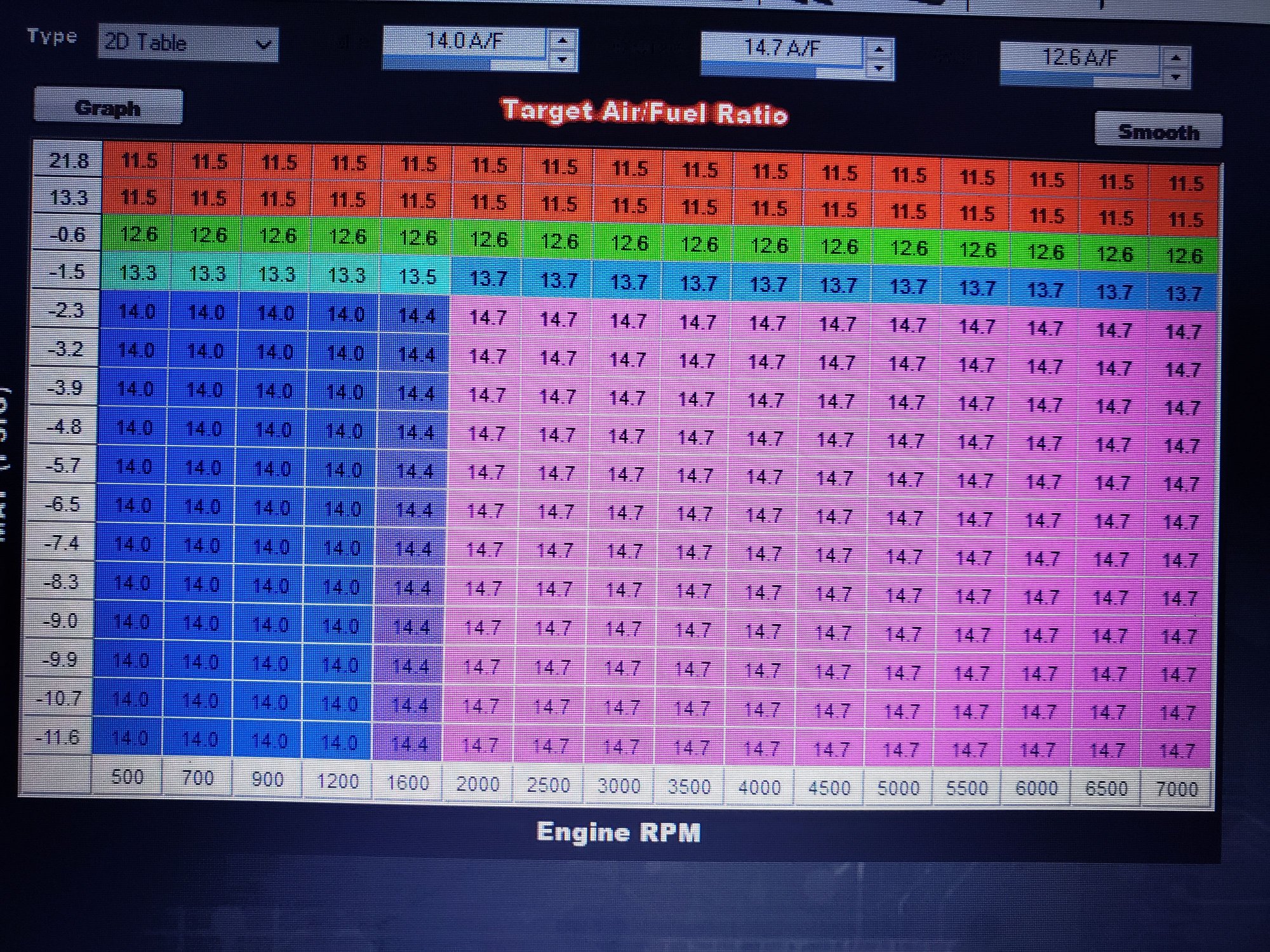

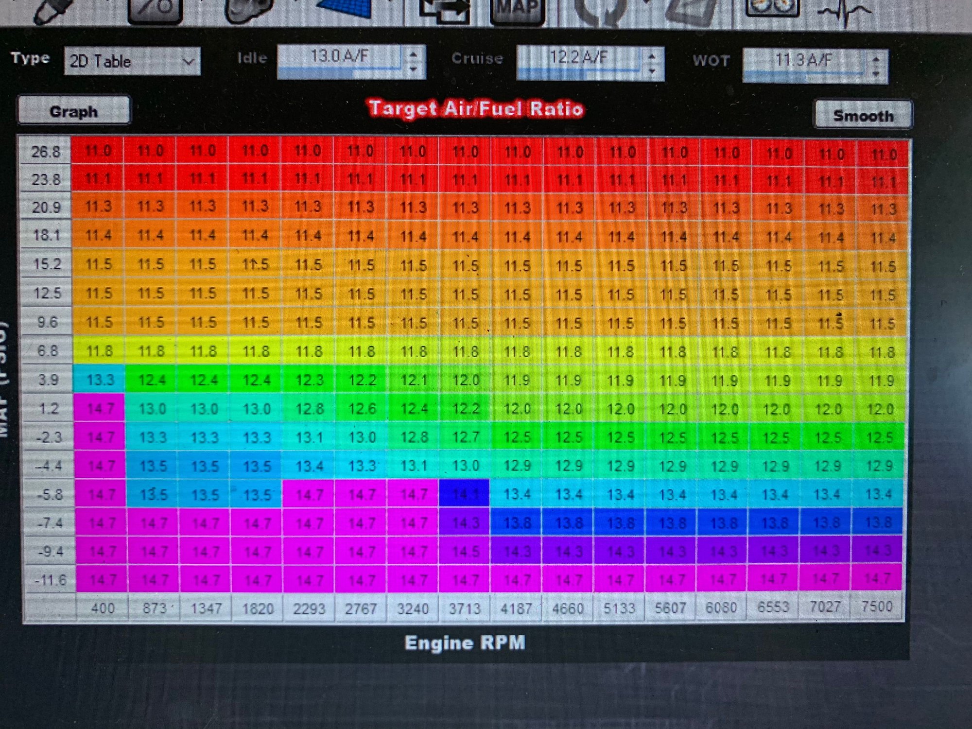

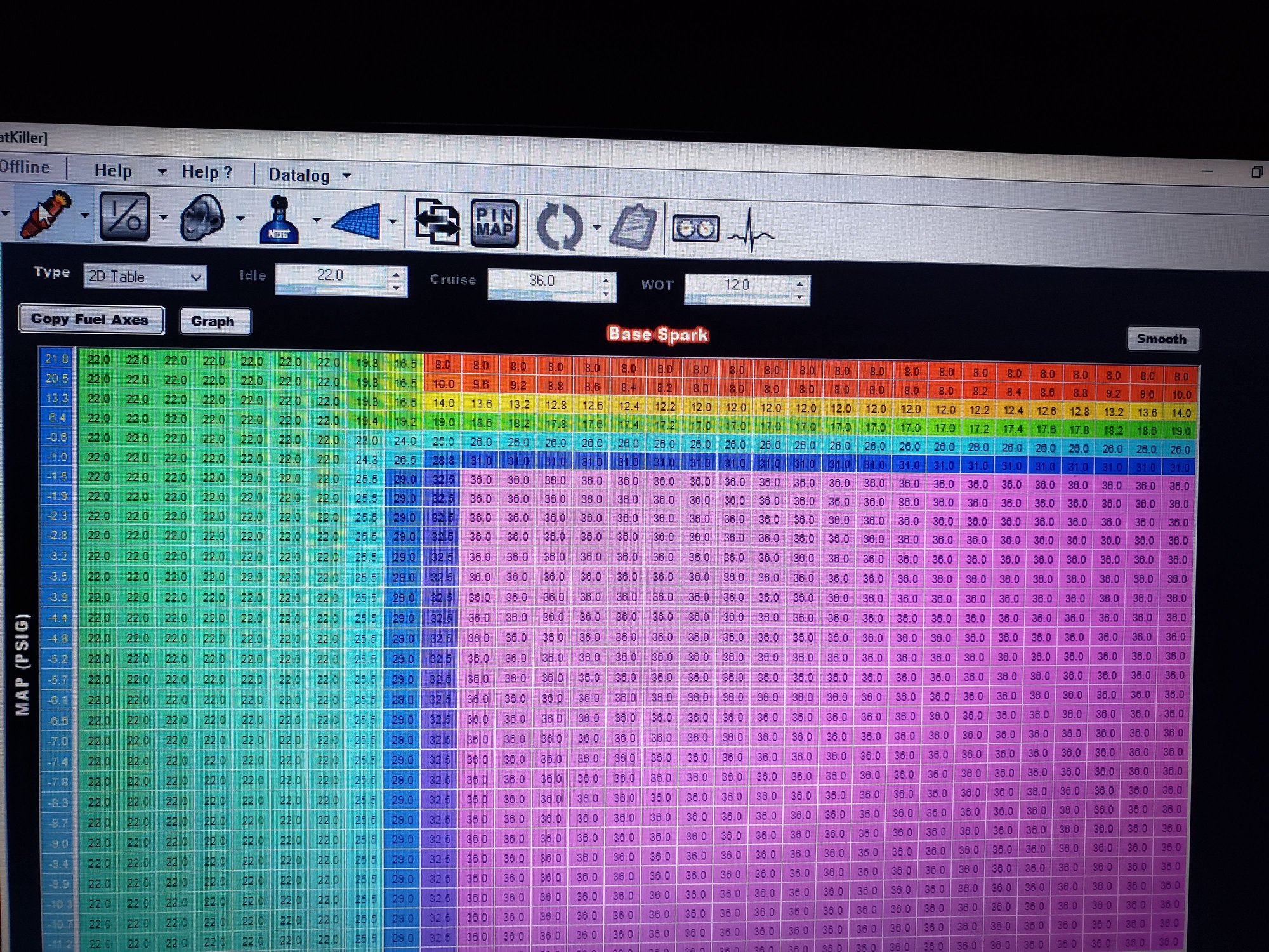

Power seemed low. According to mph and weight. About 435 hp at 10 psi and 500 hp at 14 psi at 4000 da. 5.3 aluminum 10:1 243 heads ls6 intake sloppy stage 2 vsracing 78/75. 93 pump with boost juice. 3450 with me in it. Here is my timing and afr.

Your AFR and timing doesn't seem unreasonable. Assuming no knock on the logs or plugs? Your DA is going to suck the life out of that thing lol.

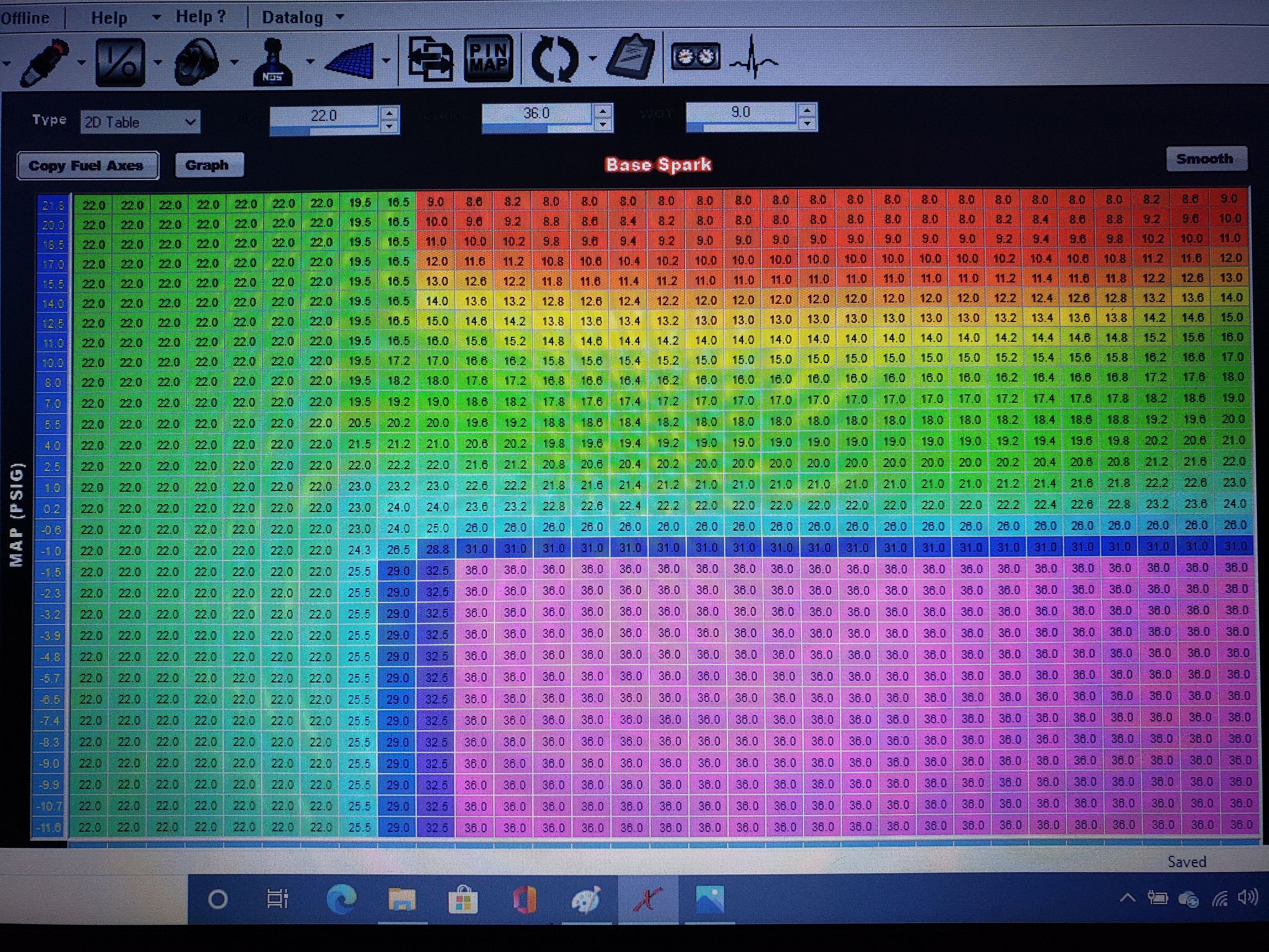

I'd like to start off by saying I'm not a Holley guy , but trying to help. I can't see the rpm on one of the tables but it looks like you could be be at - 2 psi , 14.7 afr and 36° timing , that could easily cause some knock and depending on how quickly it brings back timing that could cause a poor run and low numbers. I'm sure some experienced holley guys can send you a better timing table and help with tuning the knock sensors. Hope this helps a little

why so much resolution in vacuum and not so much in boost? just wondering if there is some advantage to this
no it's just the way the wizard scales it. I've rescaled it now but didn't change any values.

I think ur timing is low as u get into boost...i generally run close to NA timing up to about 4-5psi then start pulling. At only 10psi AND meth I would run more than 12*...not sure thats ur entire problem cause there maybe other mechanical **** going on.
Edit i just took another look and saw u have about 15*...i would run more either way since u have meth.

Would you think 2 degrees all across the board from wot and up? Or more.

I agree the timing seems low. The sloppy rule of 14@14 has always been my go to for starting a tune. i also dont start pulling timing until 5-6psi as someone above mentioned.

I would try to get another 4 degrees of timing out of it. Granted I run 9.5:1 CR, but I run 8 degrees at 24psi....I ran 14 degrees at 14psi and like 17 degrees at 10psi.
I would bet you're just timed way to soft. Maybe 11.2 AFR for 14psi and higher too once you bring the timing up.

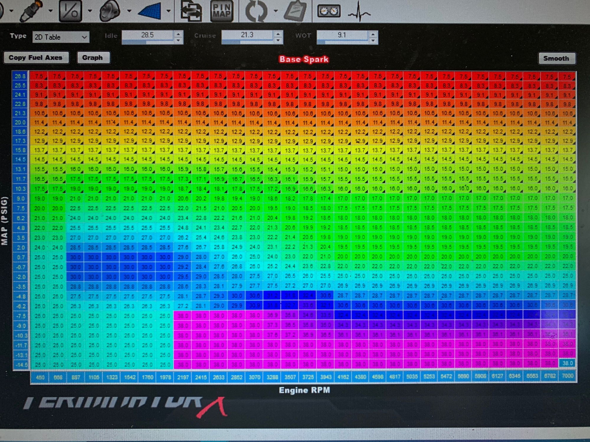

I run ethanol free 91 mixed with 110. Your going to run at a different stoic with e10
My timing table.

^^^^ his timing at -2 psi is 25 not 36. Your boost timing might be fine but you could be getting KR as you approach boost then it may take a few sec to return to normal. Logging will help

Why on earth do you have 25 degrees of timing at idle? and to make things worse, the timing actually goes up with load in the low RPM range...
Post your VE table...
