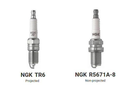

Do you still have the knock sensors in place? Wonder if those TR6's overheated and caused some detonation? How long were you running the TR6's? Projected plugs are generally bad for boosted applications. The center electrode can get so hot it fires off the fuel before the spark. What fuel were you running? 93, 93+meth, E85 ?

Well, now that you mention this, I'd been running BR7EF's since 2015 but late last year, a buddy of mine with a ProCharged 416 LS3 (2011 SS Camaro) took his car to a nearby highly regarded tuner for a dyno tune. One of the first things the tuner did was go over Steves car completely making sure it was mechanically sound before strapping it to his dyno. He saw the BR7EF's in his engine and scowled. "Here's your first problem. You need TR6's here. BR7EF's are too cold and should only be used for Nitrous LS engines". When Steve got his car back (dyno'd at 739 rwhp) I was impressed. So I swapped to the TR6'S. I may have shot myself in the foot with that move.
Yes, Knock sensors are in and in the stock locations. Two years ago,I was running E85 all the time, street and strip. Last year and this, just pump 93. Live and learn. I'm have a set of BR7EF's waiting to go into the new heads (just ordered a pair of RPC heads a few minutes ago)

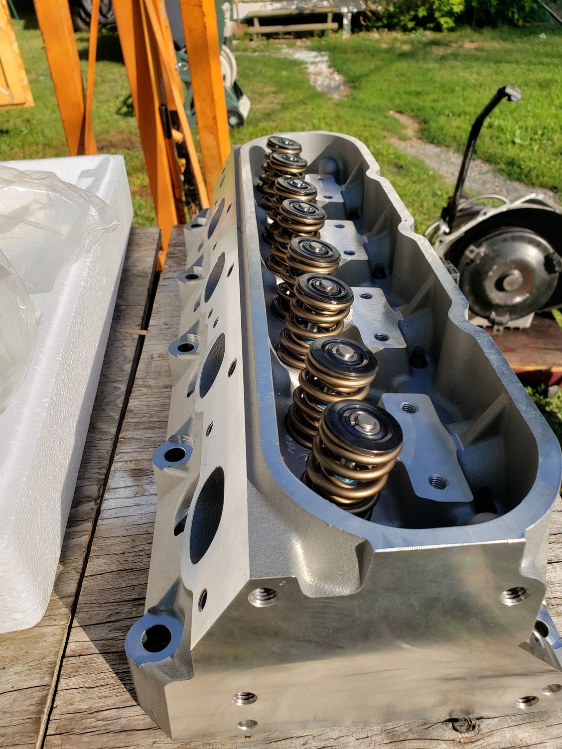

Heading over to meet a gent from whom I purchased some new RPC heads. I'm told it has thicker decks so that's the reason I'm switching from the PRC Stage 2.5's.The RPC heads come with dual springs and titanium retainers.
I'll be cleaning up the deck surface of the PRC heads and getting the unaffected one surfaced to the same level to keep the chambers equal.

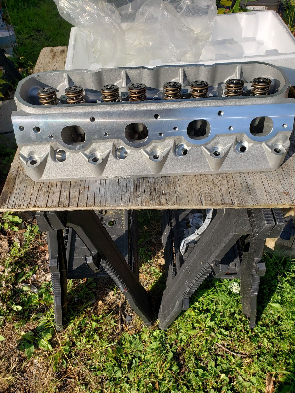

Got the new heads.
Old Aug 15, 2020 | 06:30 PM
SCLT1's Avatar
Joined: Sep 2019
Posts: 405
Likes: 19
Those look really nice and clean too!

That "highly regarded tuner" is an idiot if he said 7s were too cold for 700whp.

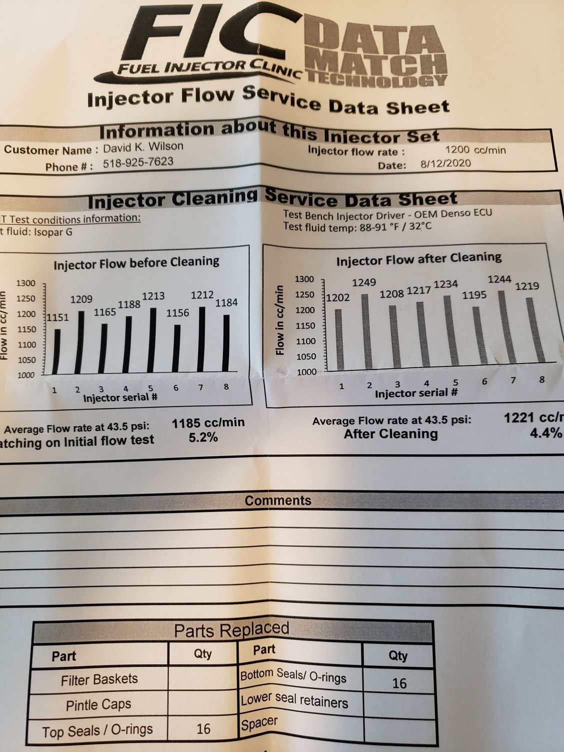

Fuel Injector clinic notified me they were shipping back my injectors but did not convey in the email what they found. I hope there's some kind of before/after representation on a document when I pick them up and not just 'cleaned'.

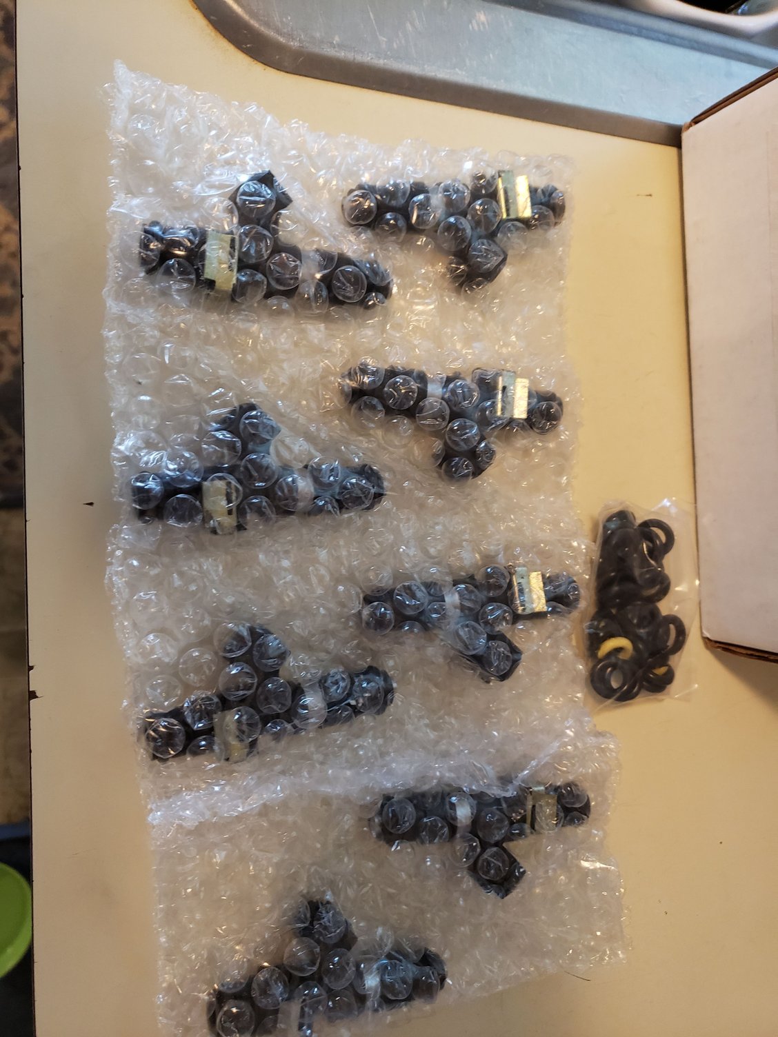

Got the injectors back this morning.
Some slight variances but nothing as agregious or as glaring as i would have expected. I guess this just means it was a compromised head gasket and the TR6 plugs. Heres the crank thrust bearing.

Im surprised at the variation on the FIC injectors. I thought they were better than that?
