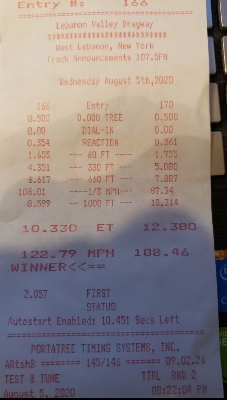

For once in a month, we didn't get shut down for rain. But after the first lane of cars made a pass, the last car, on a bye run, blew its guts out at the 1/8th mile, shutting us down for freakin' hour.
Finally got up to try to make a pass. Warmed up the 28" Hoosiers, and then creeped into the two staging lights, flipped on the 2 step, the trans brake and the line lock. Activated them and floored the gas. On the last yellow, I let off the button. I felt a little light headed from the leave and couple that with the fact the sun was right at the end of the track, I felt a bit disoriented. I looked for the tach reading on the dash but it was like someone shining a search light right in my eyes. I let off and just coasted to the end of the track and went back and got in line.
Sixty foot was 1.60 on that one.
Next pass, about 45 minutes later, the sun was below the horizon now and I could see. So, repeat the above and this time, no light headedness. But I still have that crap Boss Hog Torque converter. Lol,... I looked at the tach as I shifted from 1st to 2nd and 2nd to 3rd at 6,700. It didn't drop one rpm on the shifts. Can't wait till the PTC TC ships. Before the end of the 1/4, I let off. Not sure why but I did.

Not bad. Getting really close to 9s.

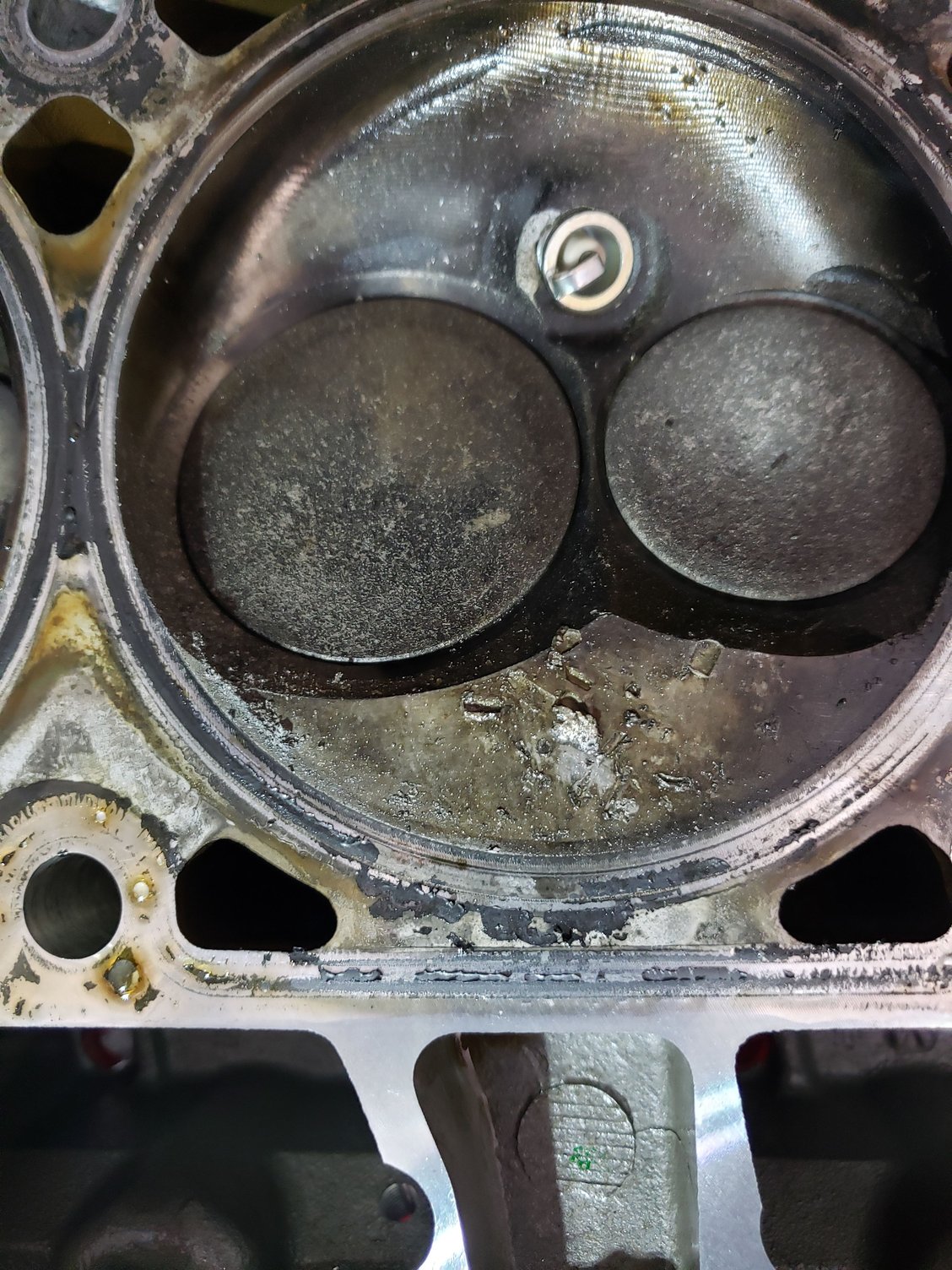

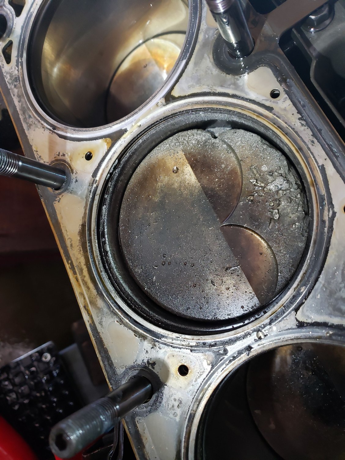

Well, got the engine out last night, pulled the passenger side head.
Assessment:
  1. Head has some affected area for cylinder 6. Probably from either the broken sparkplug porcelain or a chunk of piston. Valves seem to be okay (non visibly bent anyway)
  2. Part of piston #6 is gone. Top of cylinder wall looks scored too.
Time for a shortblock....
