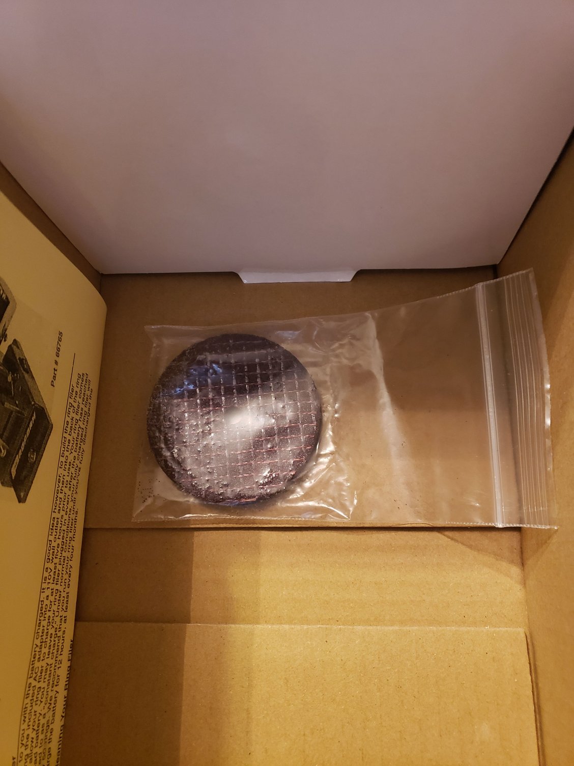

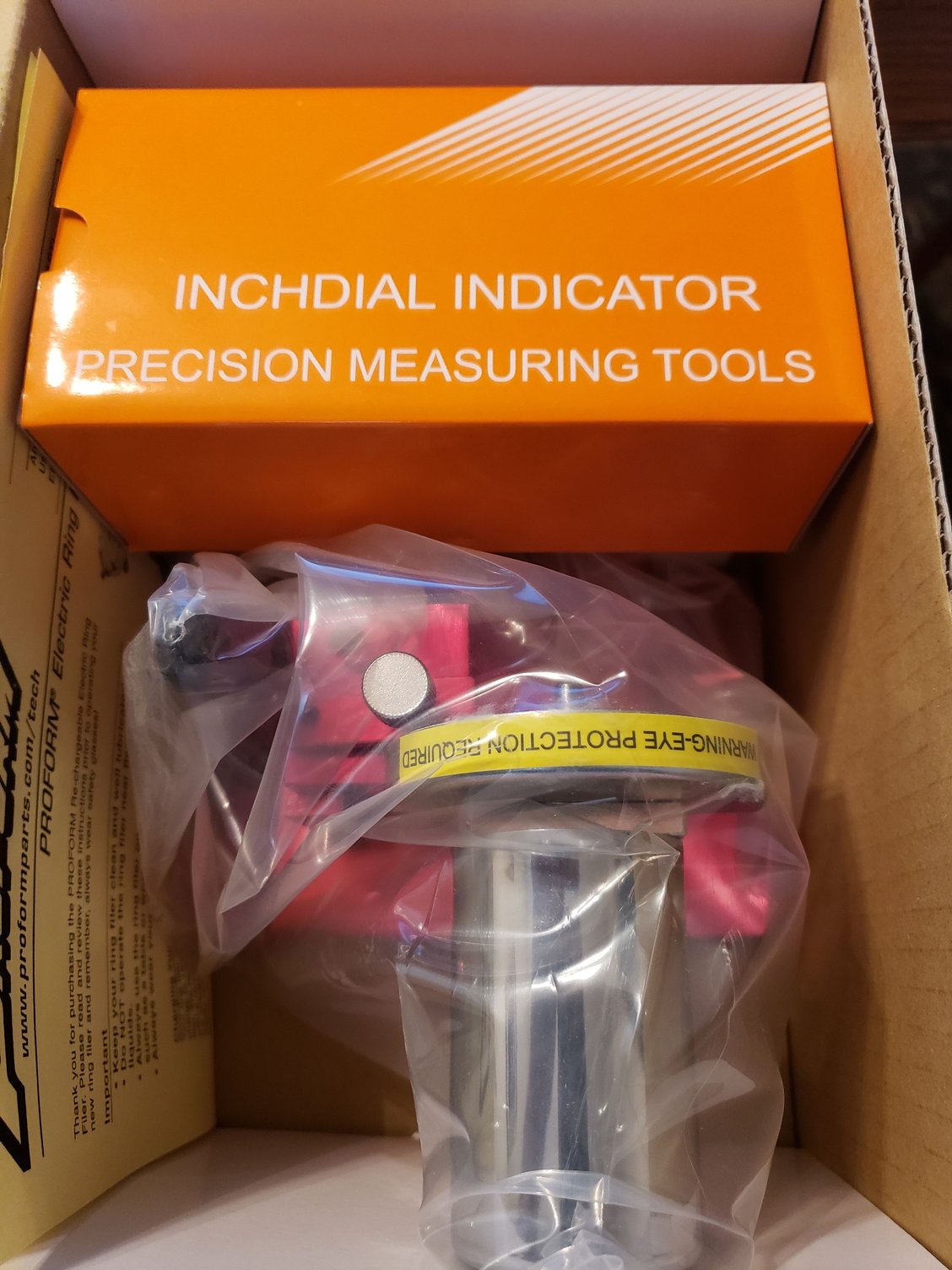

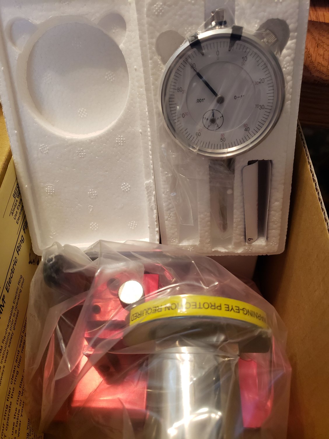

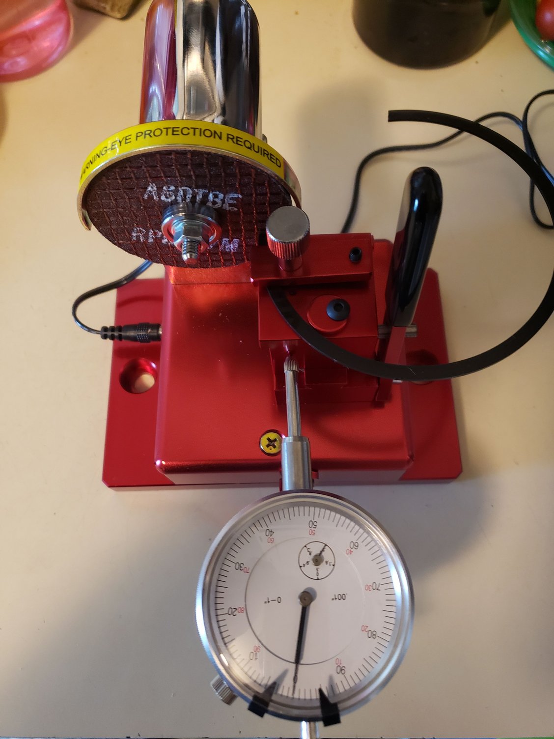

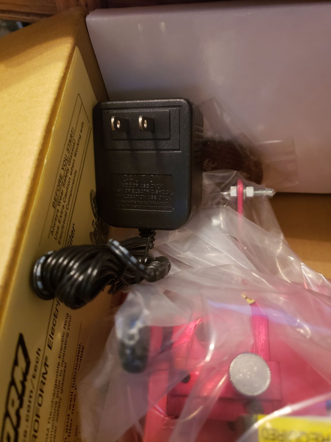

Got my new Proform Piston Ring Filer.
Dial indicator, heavy weight anodized platform, cutting/grinder wheels and charger. It is a battery operated tool and does not have to be plugged in.
Dial indicator.
Battery Charger.
Two grinding wheels.
How you set the the ring up(Using a broken ring for display only). You square the end of the ring against the wheel, then tighten the ring clamp, turn the face of the dial indicator to zero. Then you turn on the motor and then gently push the black handled lever forward while watching the dial indicator to determine how much you want removed.

Pretty slick... My dremel with a cutting disc clamped in a vise seems so much less adequate now!

Prob the most important part is getting the end square-once in the bore I put a white rag in there to help view the gap. Yea, my hand crank one seems like something from the 1800's, lol. Although I did a set with a hand file once.
