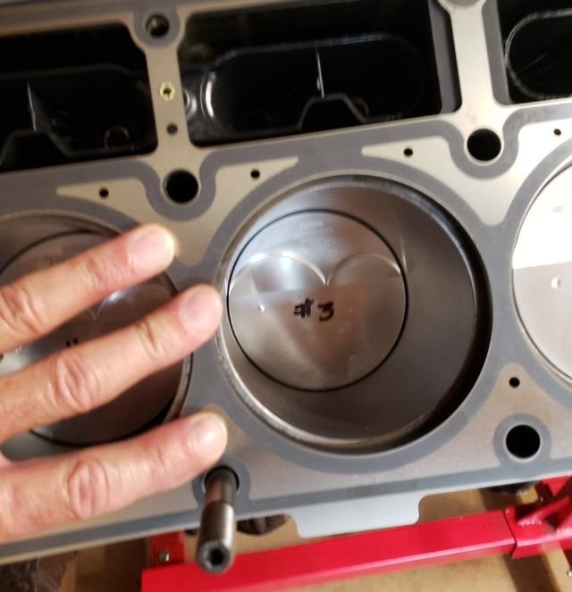

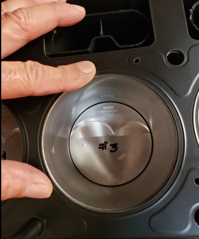

On another topic, there was a facebook thread about the LS9 Head gaskets for the 5.3. Since my prior engine had the LS9's but ended up being compromised, I ordered custom Cometics for the 3.800 bores. The difference in attendant gasket material is really noticeable.
LS9
Cometic...

In your second picture does the raised up valley areas make a difference? Is it supposed to make a better seal or cooling effect? Also off topic but how many people have done a junkyard 5.3 boosted and never touched the rings and had it last? My build won’t be a track build just 500-600rwhp with a blower.

I've seen videos on youtube where guys have done that. Just put a cam, turbo(s) and a tune with E85 and run freakin' high 7 second 1/4 miles in their lightweight Mustangs. Whom knows if they're being truthful. I would be reluctant to do that if for no other reason, If I blew the engine on the track and vomited all the oil on the track the other guys would tar and feather me, lol....

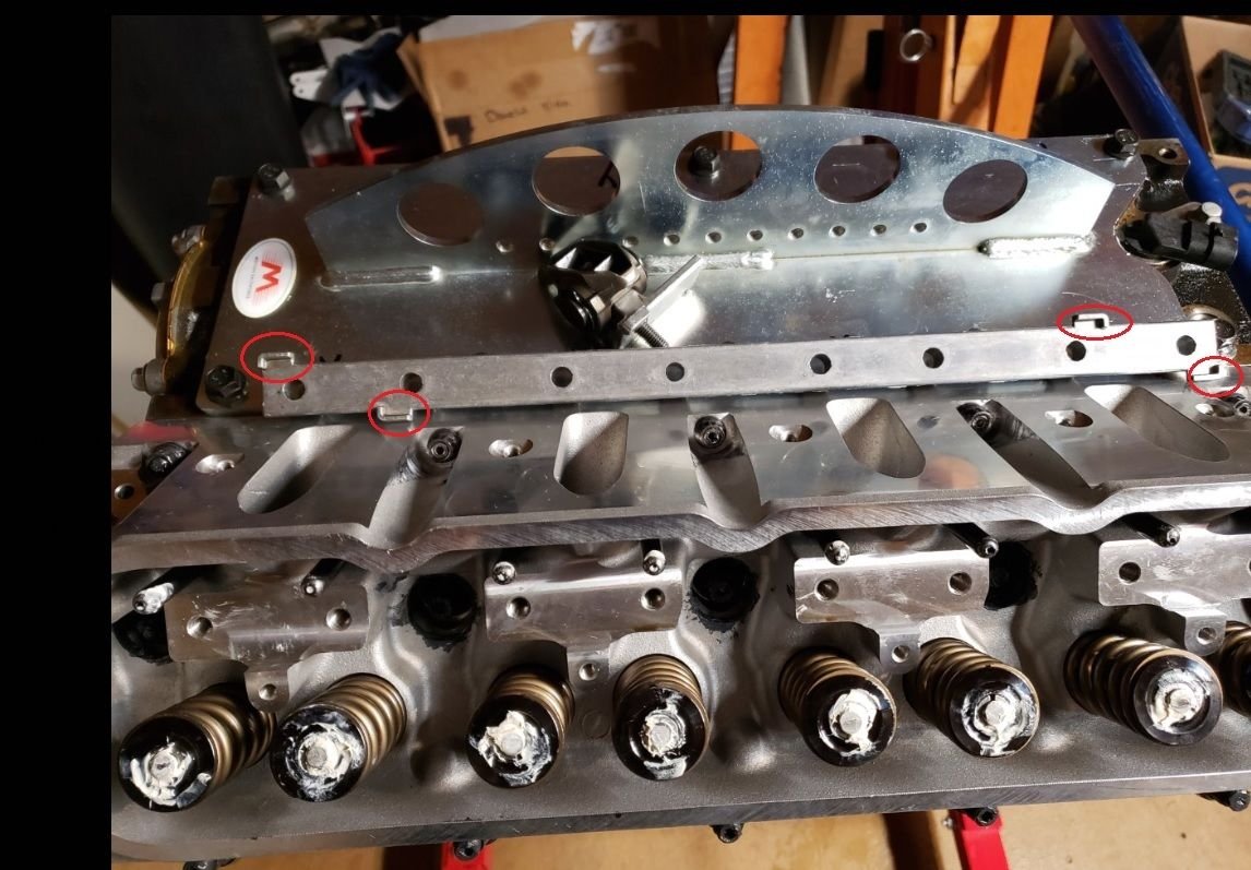

I got one half of the engine assembled , put the RPC head on, Cometic gasket, studs etc, got that all torqued down. Then put on the rocker stands and the rockers. Torqued them to 24ftlbs... then I heard popping
Thought it was perhaps a pushrod centering... Nope... the RPC heads cant use stock rocker stands, as-is. Those little tabs apparently have to be cut off
.Broke that rocker stand in two and snapped off the tabs
